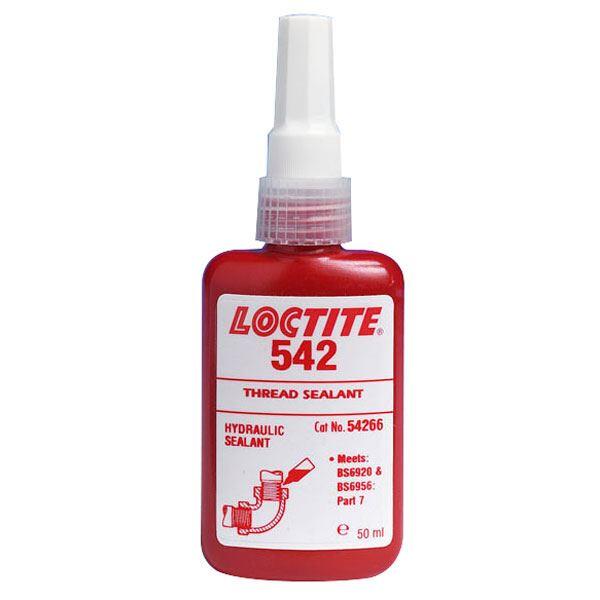

The oil pressure tap on the engine block is a tapered pipe thread, originally JSP if memory serves me. It is very close to 1/8” pipe thread, and a 1/8” pipe fitting will work.
Pipe threads seal by slight deformation of the threads as the fittings are tightened, so additional sealant is more insurance against a leak.
Some Teflon thread paste will do, or you can use a hydraulic thread sealant such as LocTite 542. I’ve used it for years with no leaks, and there is still enough metal to metal contact to allow the sending unit to ground.
Take the sending unit out, clean the threads on it, and the block. Examine the threads on both to ensure there is no damage or cracks, apply a few drops to the threads and assemble.
Don’t overtighten, just snug enough to keep it from leaking.

Isn’t the Teflon tape insulate the sending unit’s ground connection?
Yes, if you put up more than let's say 1,5 rounds.. so just use a little not 3-5 rounds because that will isolate your sensor from ground. better use a drop of liquid loc-tite. You can use teflon (PTFE) tape but if the meter does not give any oilpressure you know you used to much tape 😉 !!
That’s why I suggested the LocTite 542. A drop or two of an anerobic thread sealant  will seal without interfering with the electric ground path.

It is possible that the Teflon tape will insulate the sending unit from the engine, blocking the path to ground.
Most auto parts stores carry small vials of an assortment of thread locking and thread sealing anerobic compounds for a couple of bucks.
