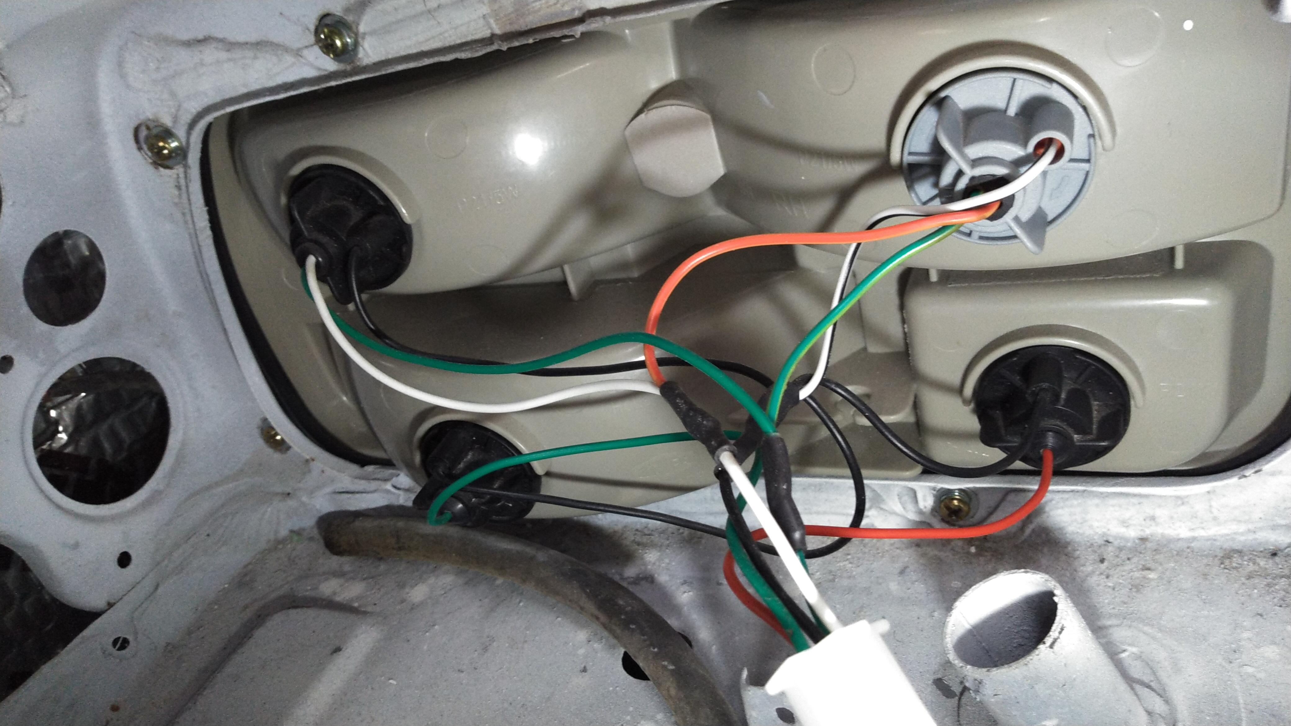

Euro / JDM taillight wiring
Maybe this will help. My car is a 71 z.
Lower left green wire is for turn signal which is R/W in the harness
Lower right wire is reverse which is R/B in the harness
Upper green is tail light all blacks are ground. Which is G/W in the harness.
The other light is brake. However I installed another 1157 socket So I would have both of the top lights tail lights and brake lights. I also installed led bulbs.
