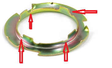

The lock ring has 4 tabs on it. I have arrows by where you need to turn it to remove the ring.
