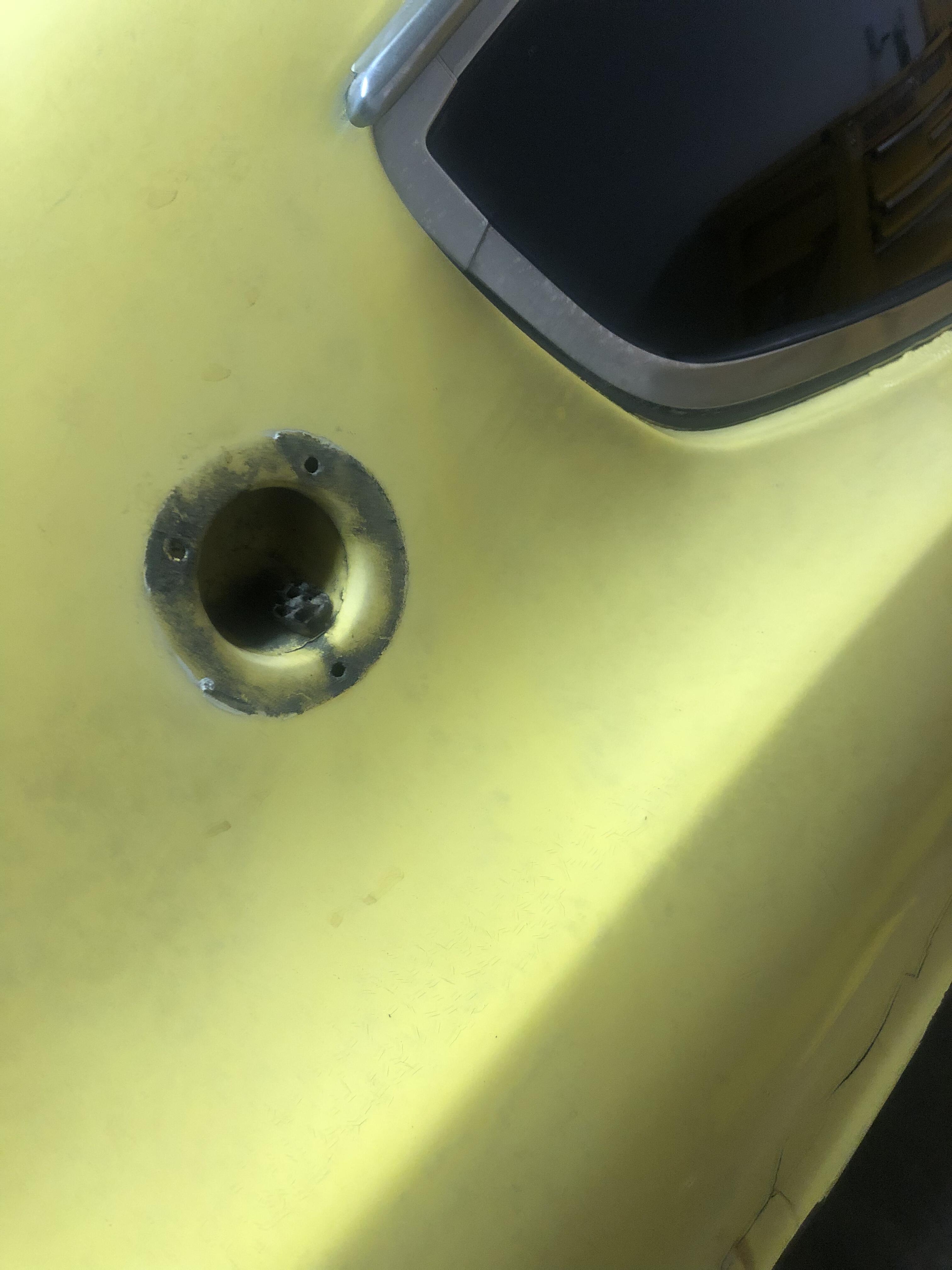

Hey Guys, what is the best way to take these off? i am planning to get the car painted.
I tried access them from inside by removing the inner panels but no luck. Looking at the new ones they have 3 pins. Should I just use a heat gun and pry them out with a screw drivers?
They are a bit beat up too!!!

They just pull off on my '71 Z.  No sure if they do on earlier years.

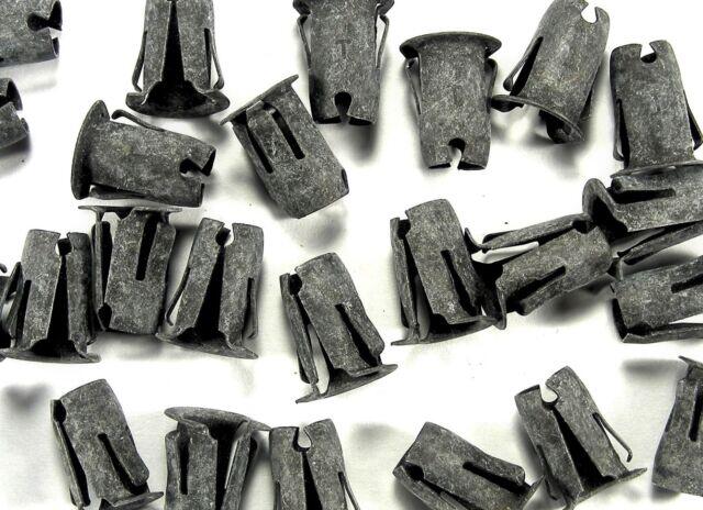

I followed @Hardway write up on my emblems. Very helpful. There's also the flat clips I think 26th is talking about? You can buy those at Lowes in the Hillman drawers. Flat nuts I think they're called?
https://www.lowes.com/pd/Hillman-2-Count-1-4-in-Black-Phosphate-Standard-SAE-Flat-Spring-Nuts/3013190

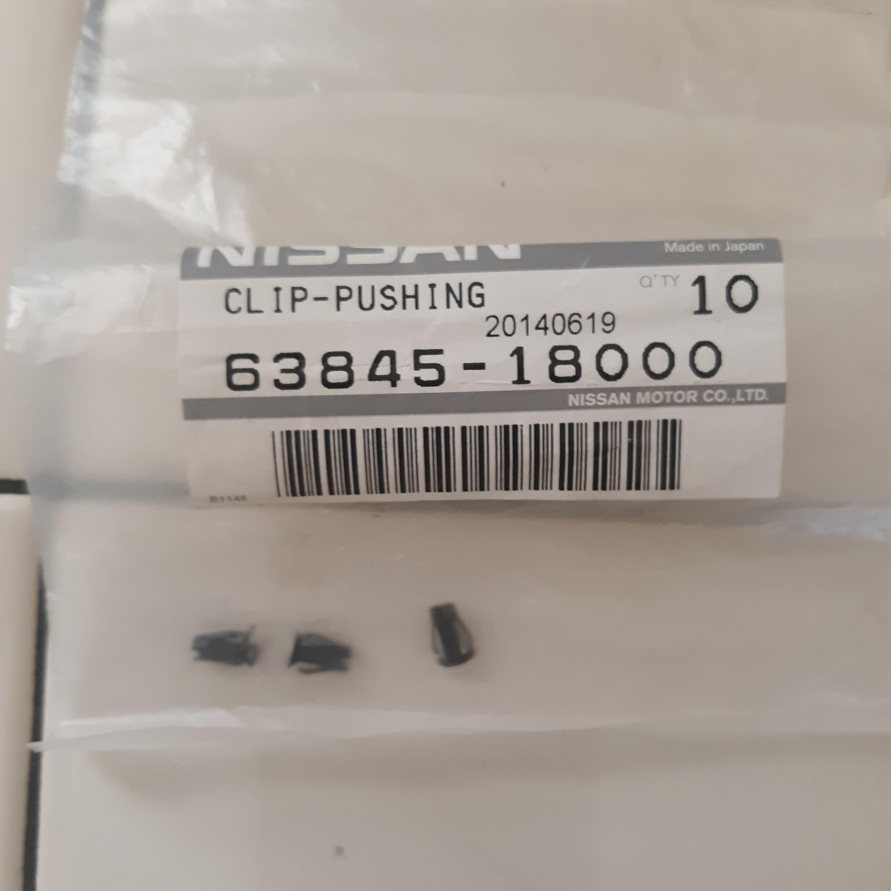

3 hours ago, siteunseen said:
I put mine on the emblem then pushed until they "clicked".
Bought from local dealership.
That's interesting as i did not find any clips like these nor any double sided tape. Badges were metal, i will try these too.
I did my hood emblem with those. Quarter sides may be different? Sorry for any confusion I may have caused.
