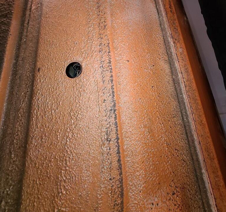

My car has what I believe to be factory tar undercoating top coated with 918 orange (though thinly top coated). It is what 26th-Z describes as a "thicker textured paint finish".
In my opinion this is a typical tar undercoating with lots of texture, top coated with the same paint used on the exterior- in my case 918 orange.
My eyes and experience with stripping the undercoating tell me that what is beneath the tar undercoating is nothing but galvanized metal. I can remove the galvanization mechanically or with acid. This coating, to me, doesn't behave like a primer or paint and doesn't look like it either to my eye. It won't come off with aircraft paint remover. It only comes off with a wire wheel or acid.

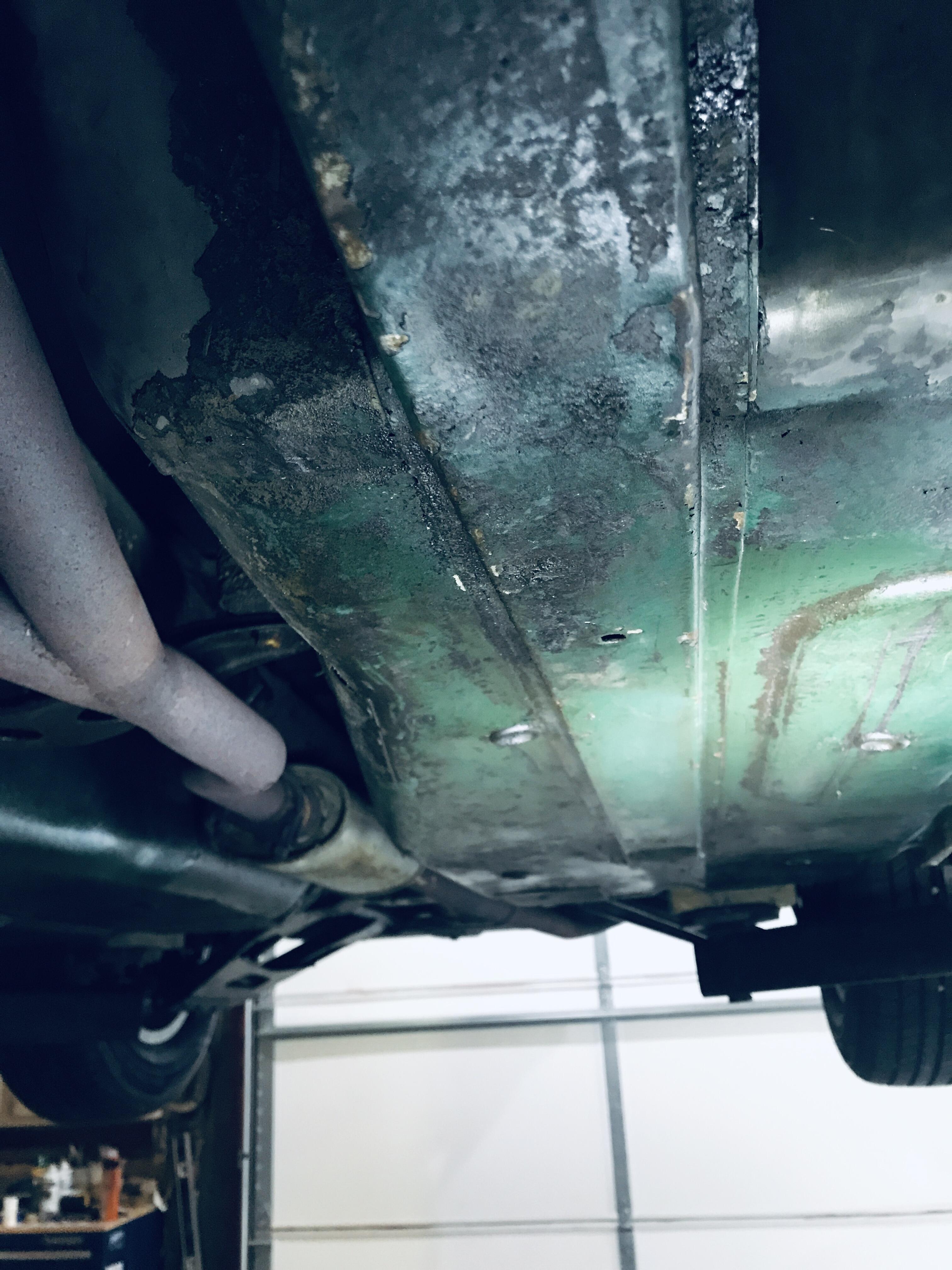

This is the floor before stripping. I used a heat gun and a putty knife to remove the "painted tar undercoating".
The photo below shows what the painted undercoating looks like when removed. The painted side is painted. The tar undercoating portion is what I know tar undercoating to be. And, there is no primer or paint on the underside of the tar undercoating (the black side). It is just black tar undercoating.
The photo below, to me, raises the most questions. To my eye, the left side shows what I now see all over my floors and tunnel- a mixture of bare metal and galvanized metal. Clearly the transmission brace is bare metal. The tunnel surrounding, to me, shows a galvanized / electroplated sort of coating. To me, this doesn't look like and it doesn't behave like a primer. Aircraft paint remover does nothing to it. The only way to remove it and make it look like the transmission braces is to either wire wheel it or treat it with acid. Am I seeing this wrong? Is it really some milky looking super thin primer?
The right side shows the painted undercoating. What I see where the undercoating ends and metal begins is painted tar undercoating where my tool has, at the edges, scraped away some of the paint leaving only black tar undercoating.

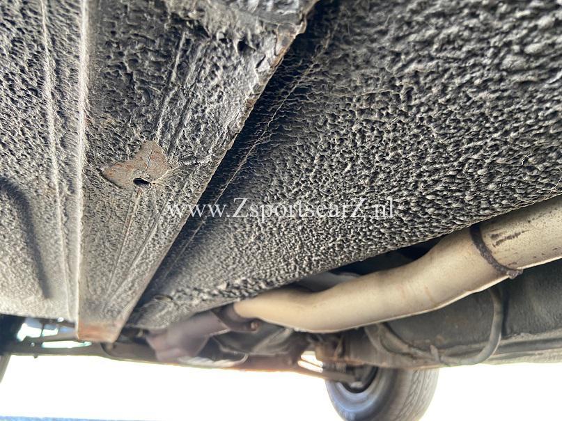

Looking at your pics, have to agree.. Looks like galvanized metal, with tar, and paint.  My 12/70 just has paint, with undercoating sprayed on top. See pic. Real pain to remove without ruining paint. So later cars had “improvements”.
