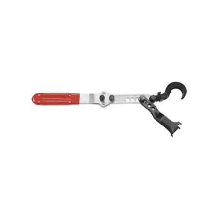

If you have the right tool you can pop each rocker out one at a time to inspect them. With whatever rocker you wish to remove, rotate the engine until that rocker’s cam lobe is at the base circle of the lobe. Then use the tool to depress the corresponding valve until the follower can be lifted out. Inspect, make notations, then reinstall the follower, taking care to not dislodge the lash pad.
The tool looks like this:
17 minutes ago, RMin280 said:
Nevermind, I think I was able to find it. Is it a L series valve compressor? Would I also need to support the valve some way to prevent it from falling down or do the keepers stay in place?
You need to support the valve. You can do with compressed air or some rope pushed in through the spark plug hole.
