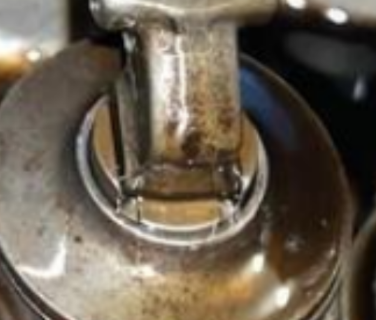

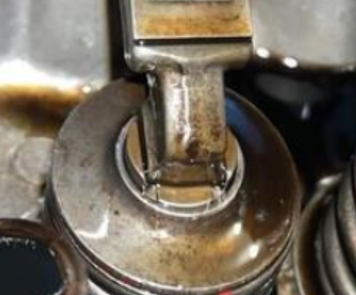

12 minutes ago, RMin280 said:
Here’s the other side. I just changed my oil recently but it’s been run pretty hard with it.
It isn't easy to see, but it looks like the wipe pattern is close to the edge. You don't want the cam lobe to wipe off of the pad, which is hardened steel, as is the tip that rides on the lash pad which sits on the valvestem. The rest of the follower is (I think) forged steel, but not hardened like the pads. It won't be happy wiping the cam lobe, and both will wear out very quickly.
You've mentioned the PO has done some work to this engine. I know that to "cheat" the follower ratio and gain more lift, the geometry can be adjusted towards the pivot, effectively changing the ratio of how long the side that pushes the valve is to the length of the side that pivots.
I'd also be interested in seeing the rest of the valvetrain, for all the valves and cam lobes. The ones you have shown so far don't look bad, but I wonder why they don't look shiny.
Edited by Racer X

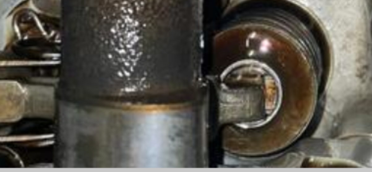

4 minutes ago, RMin280 said:
Do I still need to remove the rockers or is looking at both sides good enough to now?
If you wanted to try the screwdriver method, it wouldn't hurt to have a look at one, and share what you find.
Again, I'd like a look at the rest of the valvetrain.
A cam lobe that's dropping off of the edge of the wear pad could be the cause of the noise you're hearing.  The pattern is definitely "wrong", out of spec., but as RacerX said some people do it on purpose to gain a bit more valve lift.
Overall though, the odds seem good that you'd be better off with the proper lash pads to get the wear pattern centered.
The three that you showed seem very close, the middle one might even be the noisemaker.
That's not good.  Can you get a shot from the side to see if it's up on top of the edge of the lash pad.  Might be that you actually have a very loose rocker arm.
The end of the rocker arm should sit between the two ears.  Can't tell which one you're looking at.
I’m looking at cylinder 4 intake, second lobe back from the middle cam tower. It’s the same one y’all said might be the one falling off of the wear pad. What exactly do you want a picture of? I want to make sure to be able to show you want you need to see.
