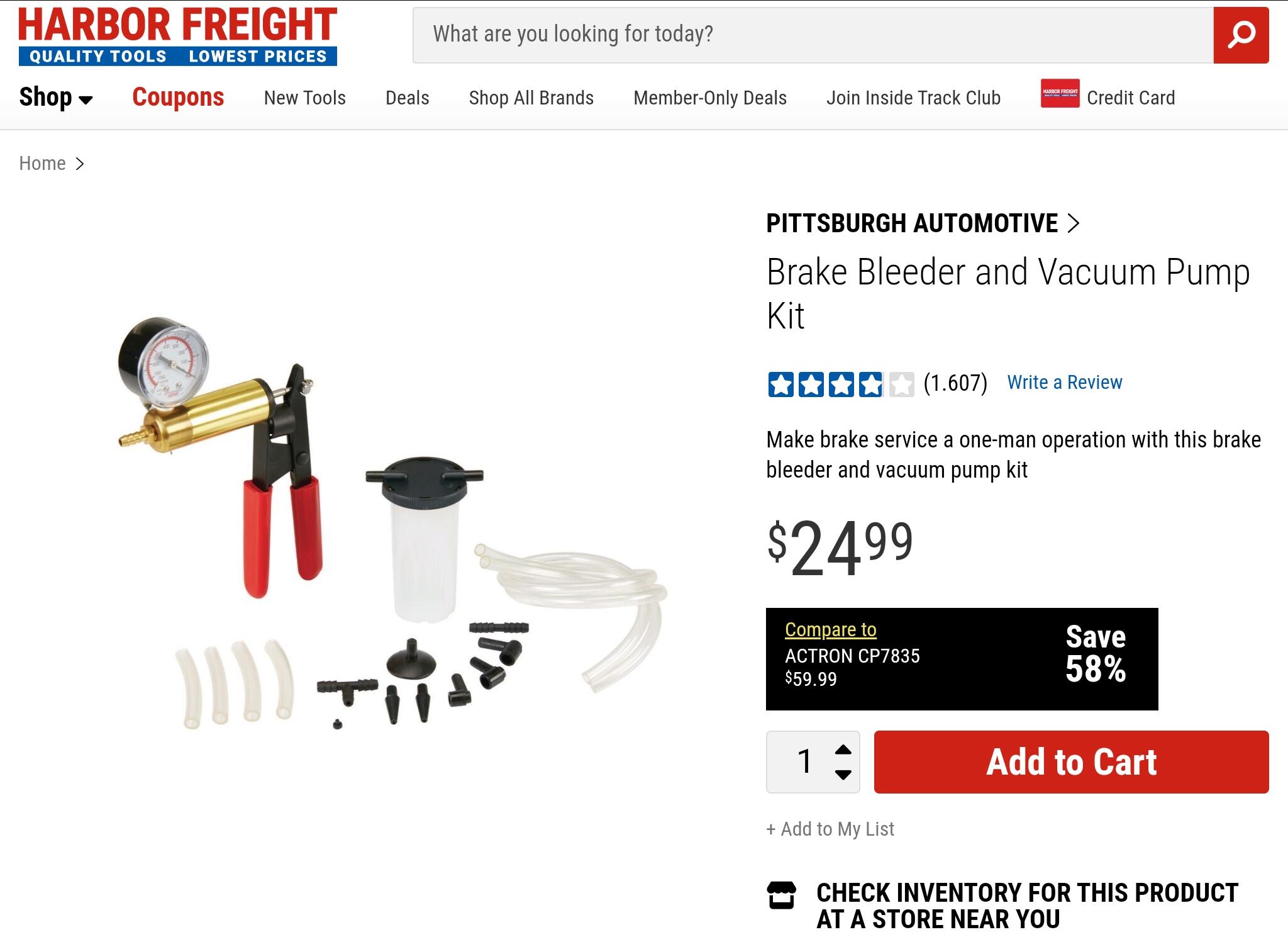

There are two ways you can change the fluid in the brake system.
1. Using the master cylinder / foot peddle method
2. Using a vacuum unit to refresh the fluid.
I prefer the vacuum system because it doesn't require the master cylinder. The method using the master cylinder can damage the master cylinder rubber seals. The master cylinder normally only uses half its stroke and when you bleed the brakes using the master cylinder method you use the full stroke. Old fluid can corrode the cylinder section that is not wiped regulary by the seal. That corrosion can sometimes damage the seal when the seal goes full stroke.
I always use a soappump to empty those little reservoirs, you clean it up into the old soap bottle and when you cleaned out the reservoir with a clean rag (dispose the rag after that!)  you then fill them with clean brakefluid. (now you don't have to pump all that stuf through your cylinder.. and your reservoir is also clean.)  And when your ready emptying you screw that pump back in the bottle (ex soap bottle) and you don't get any brakefluid on your car or shop.. (what will damage your paint! )   Brake fluid.. you don't want that on your car or towels!
