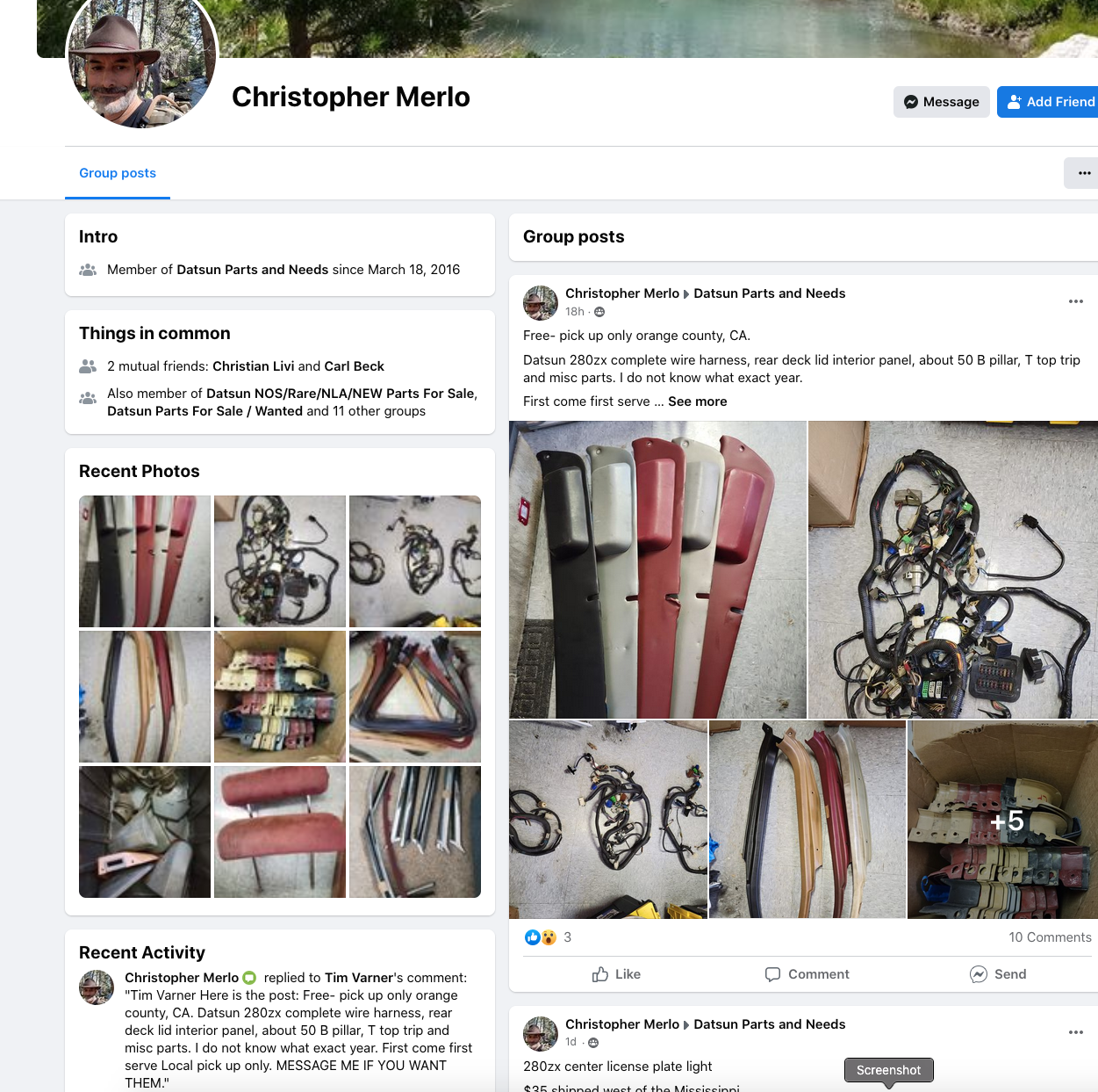

This guy on Facebook was selling a lot of ZX parts. Looked like reasonable prices too. I do not know him or have I delt with him. I just have seen his ad's popping up recently.
https://www.facebook.com/groups/327981873903624/user/100000244220750
