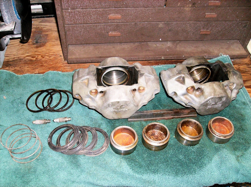

Stock is a single piston design. You can see that caliper in the FSM or parts manual.
It sounds like your car may have had the Toyota calipers installed. http://www.zhome.com/ZCMnL/tech/Calipers/toyotaCalipers.html
I'm not sure why they are called 4 piston in the Zhome article.

Just looked at mine and each caliper has 4 pistons. Thats why probably. Let me try to find any part number on them and will post.

25 minutes ago, MH77280Z said:
Good luck with that.  Might want to see the cylinders, if you can get them apart, before you buy the rebuild parts.  Pretty crusty.

No. The link Steve posted is for the S12W calipers with the 4x 43mm bores and vented rotors. Your calipers in your post #6 are the S12-8 calipers with 43/34mm bores for the non-vented solid rotor.
The S12-8 calipers are getting hard to find.
S12-8 - 1984-85 Toyota 4 Runner and 1979-84 Toyota pickup
S12W - 1985-95 Toyota 4 Runner

I am currently running after market calipers from Oriellys. They are 2 piston and stock bolt pattern. planning to continue using those. Will get these rebuild in that case. I think rebuild i am quoted $50 a piece which includes blasting, painting, new kit and assembly.
