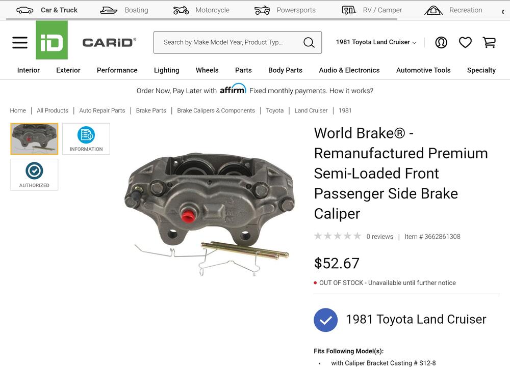

No. The link Steve posted is for the S12W calipers with the 4x 43mm bores and vented rotors. Your calipers in your post #6 are the S12-8 calipers with 43/34mm bores for the non-vented solid rotor.
The S12-8 calipers are getting hard to find.
S12-8 - 1981-89 Toyota 4 Runner
S12W - 1990-95 Toyota 4 Runner

Be carefull buying a replacement set. A lot of sellers really don't know what they are selling. You should look for the S12-8 system.
Calipers are left and right, marked with a R and L. There should be two sized pistons. 2x 43mm pistons and 2x 34mm pistons. That is not a typo no matter what the sellers tries to tell you. 4x 43mm is the Wide version and won't work on the 10.5mm thick solid rotor.
Buy a set of Porterfield  pads R4-S brake pads. Well worth it.
