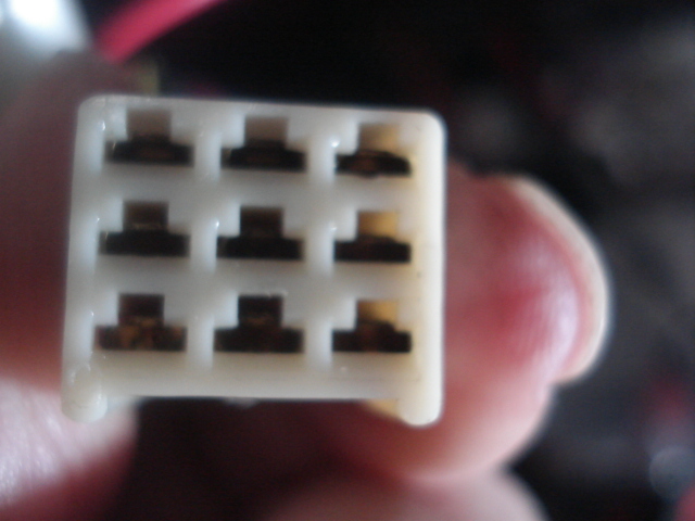

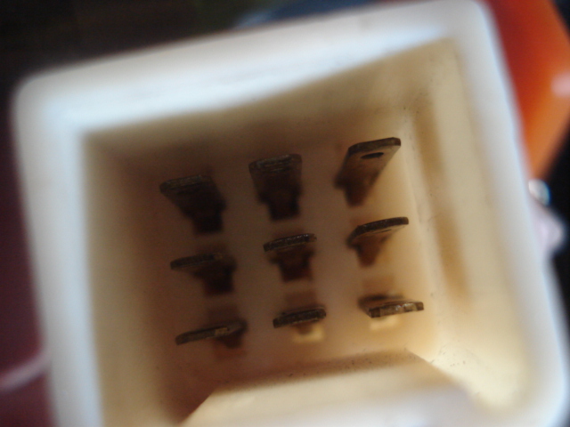

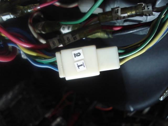

So the main power is hooked up right. Your chart shows that isn't a problem. And the green/blue wire has 12VDC on the 9 pin connector. That is perfect.
You said you found one cross connect in the center stack.

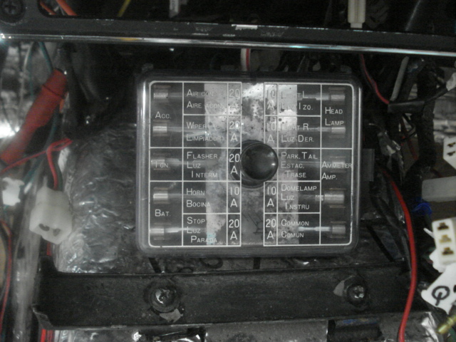

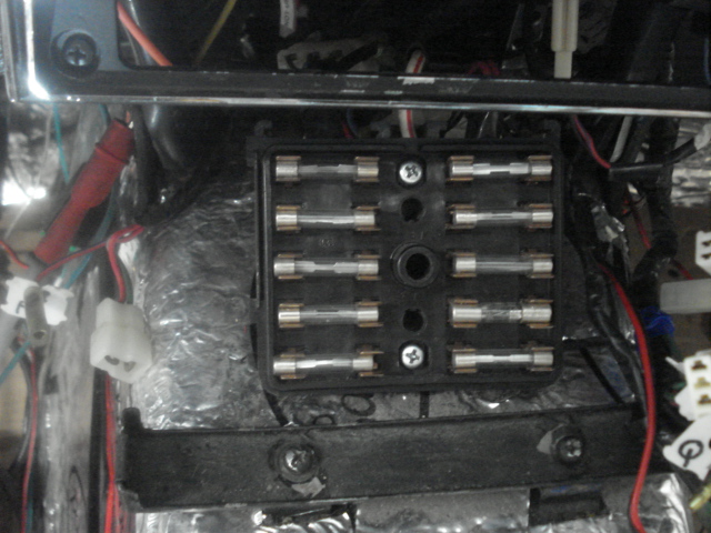

If the gauge lights still only come on with the key in ON, pull the ignition fuse and see if the lights are still on. If so, repeat for the AC fuse and wiper fuse.
