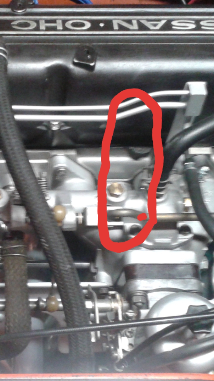

You can hold the throttle rod, carbs, wide open by tying or wiring the loop to the fuel rail. That way you stand outside the driver's door and reach through the window to turn the key. Make sure and pull the coil wire off at the coil. It's kind of hard to mange all at the same time by yourself but it is possible to turn the key with your right arm and hold the gauge with your left arm to see the reading of the needle on the gauge. A helper is best but like me, hard to find when you are ready to do the test. Good luck. Hope for higher numbers. :beer:
