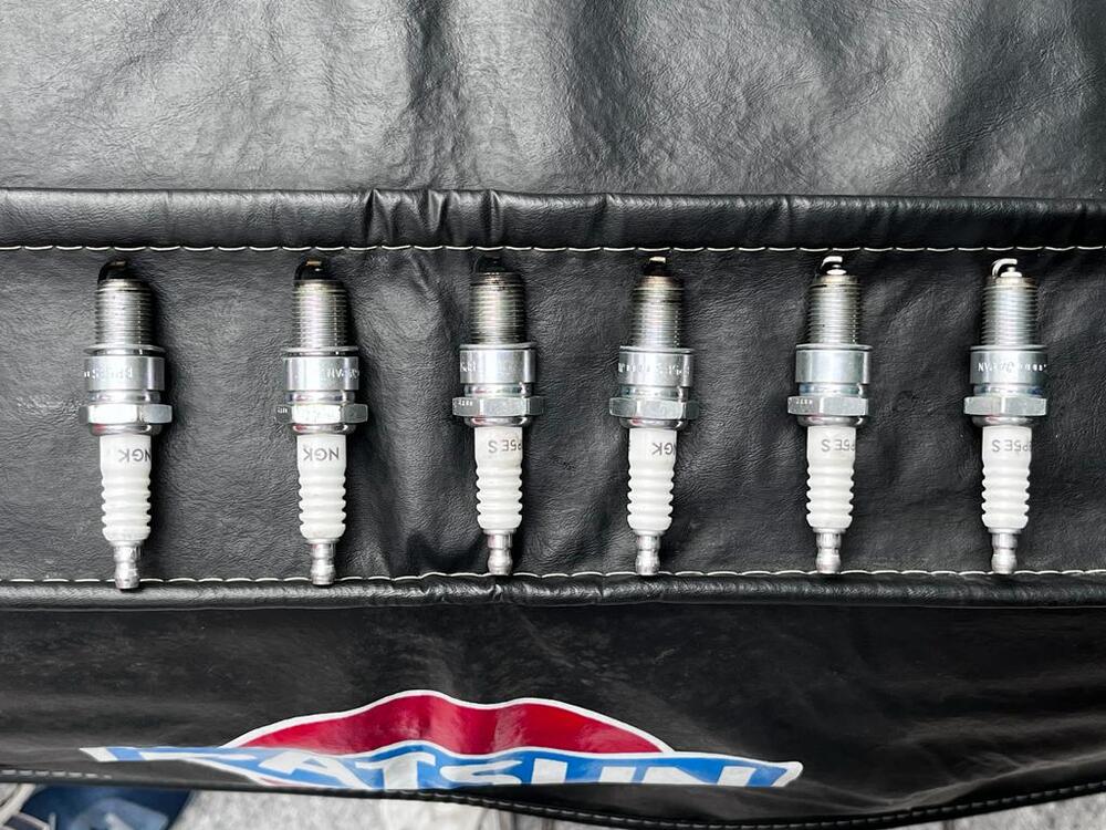

Dry test results with choke fully open and gas pedal floored:
Cyl 1: 148 psi
Cyl 2: 150 psi
Cyl 3: 146 psi
Cyl 4: 150 psi
Cyl 5: 150 psi
Cyl 6 : 149 psi
Wet - Cyl 4: 160 psi
