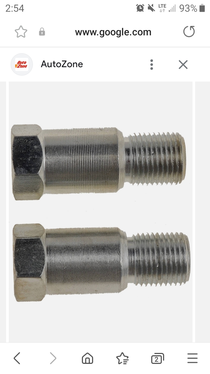

When I fouled plugs all the time on a 2 stroke dirt bike I had we put an anti foulet on and helped from what I remember. It was a 1982 motorcycle too.
I do not know if they work on cars? Maybe someone else can explain?
https://www.google.com/search?q=spark+anti+fouler&source=lmns&bih=449&biw=320&client=ms-android-americamovil-us-revc&hl=en&sa=X&ved=2ahUKEwiu6ZqO08X9AhUFrIkEHfBMAxcQ0pQJKAB6BAgAEAU
