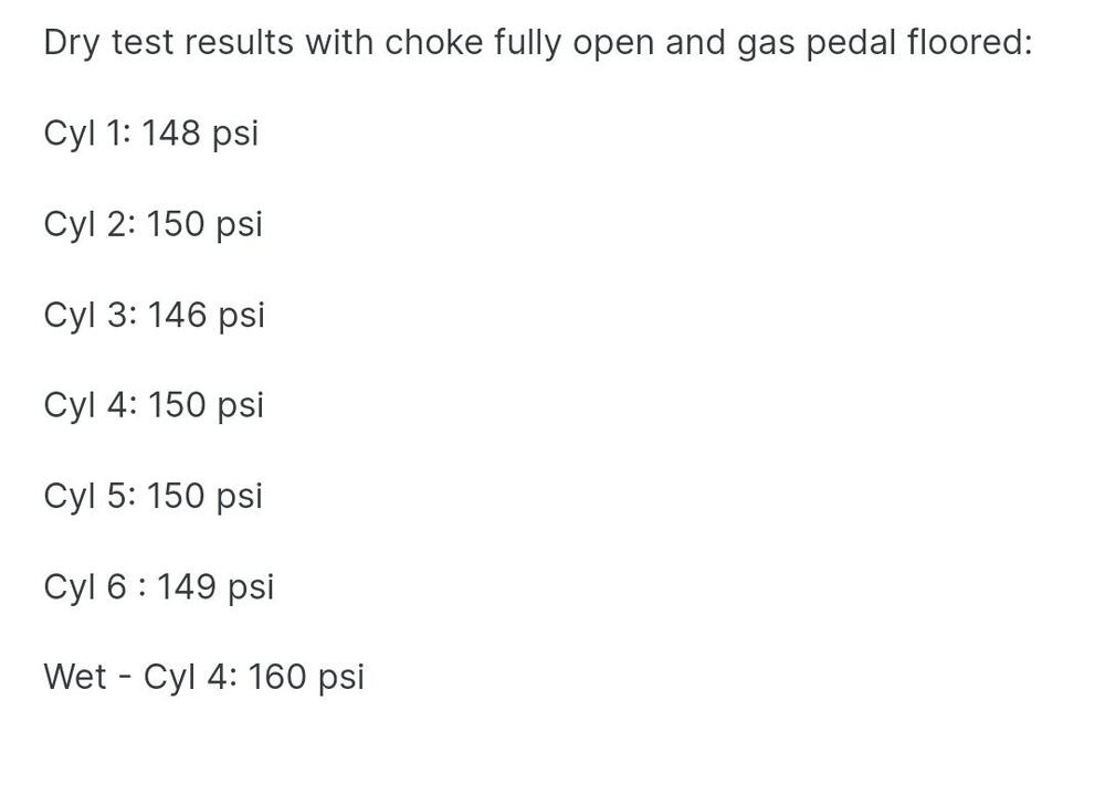

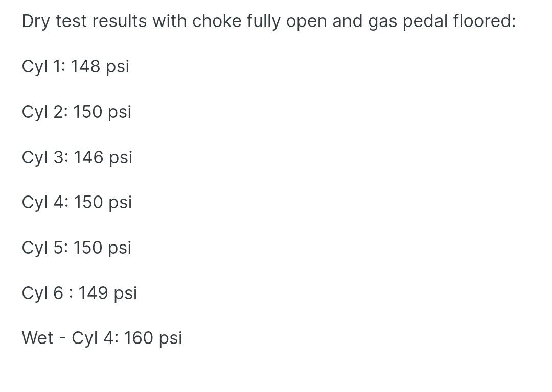

Another test?? This was done on March 5.
Screenshot_20231015_205439_SamsungInternet.thumb.jpg.21099159aceba436018598ff63fdee39.jpg
Well, if you’ve driven since march 5th then yes you should - lots could have changed! It takes no real time to do it and puts your mind at rest.
If the compression numbers vastly vary then you can suspect your head gasket and pull the head to see what is happening.
If not, then you can focus on electrics / ignition before moving onto other things.
If after 8 years and all the experimentation you haven’t found causes outside the engine, then perhaps it’s time to do something different and look inside the engine? Just a thought.
