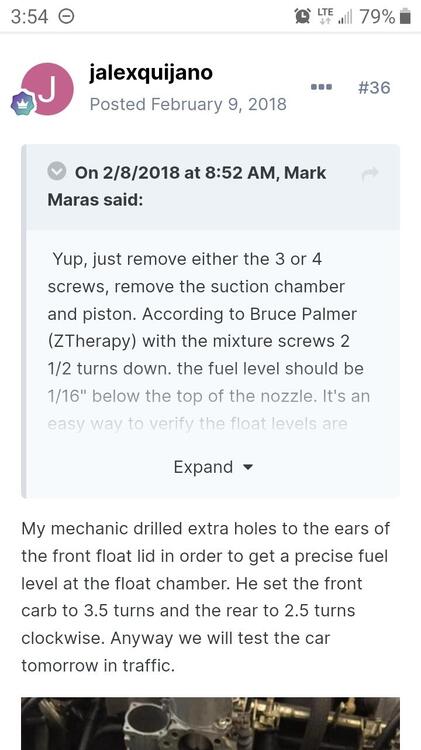

Let me ger this clear when i mean 3.5 turns clockwise is lowering the nozzle from the bridge 3.5 turns. The standard is 2.5 turns clockwise. At that setting the car has no punch at all even at 3 turns it lacks power.
