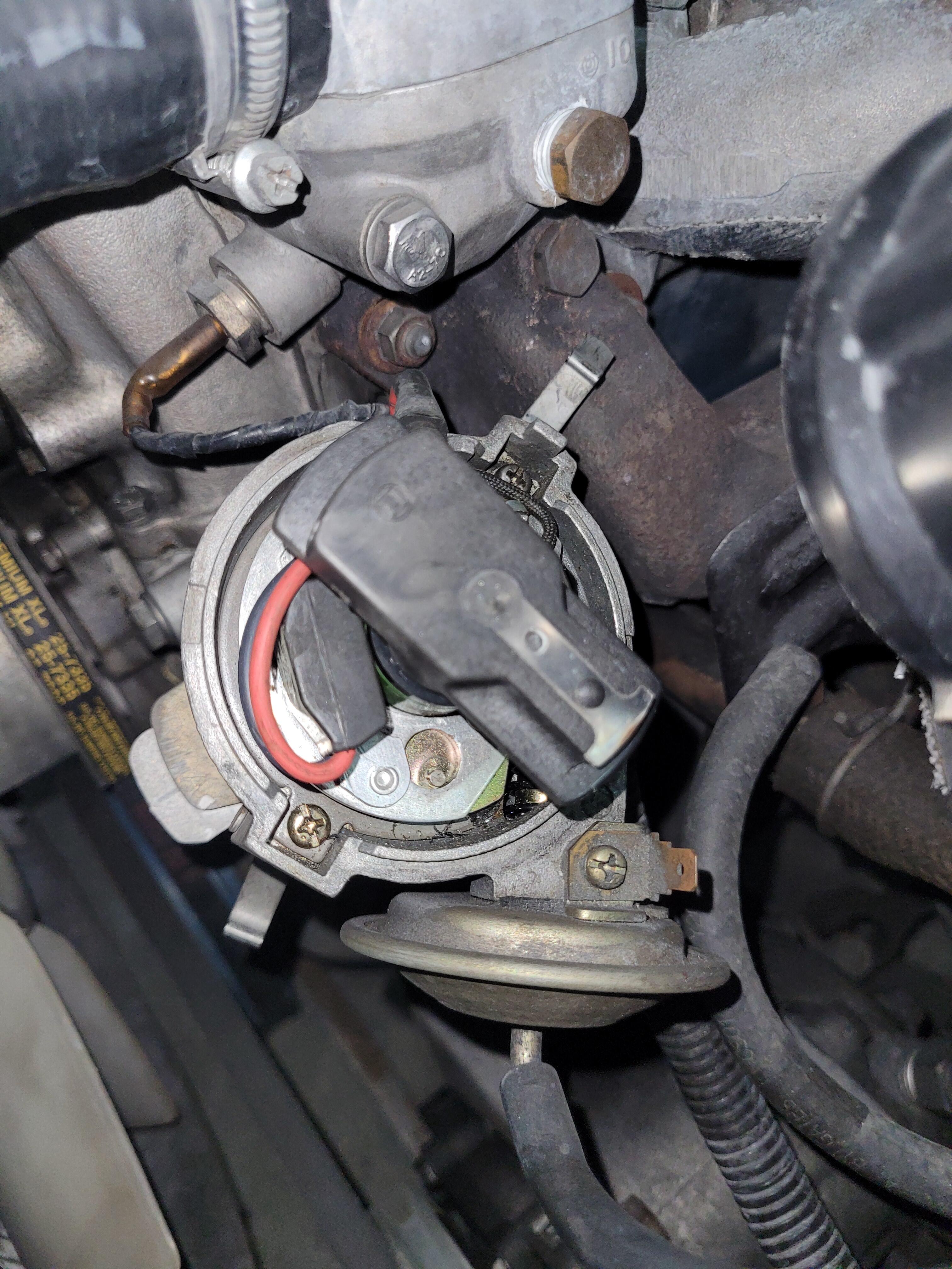

Okay but do you want me to disassemble the complete distributor to see what happens? it has a new cap, rotor and wires.

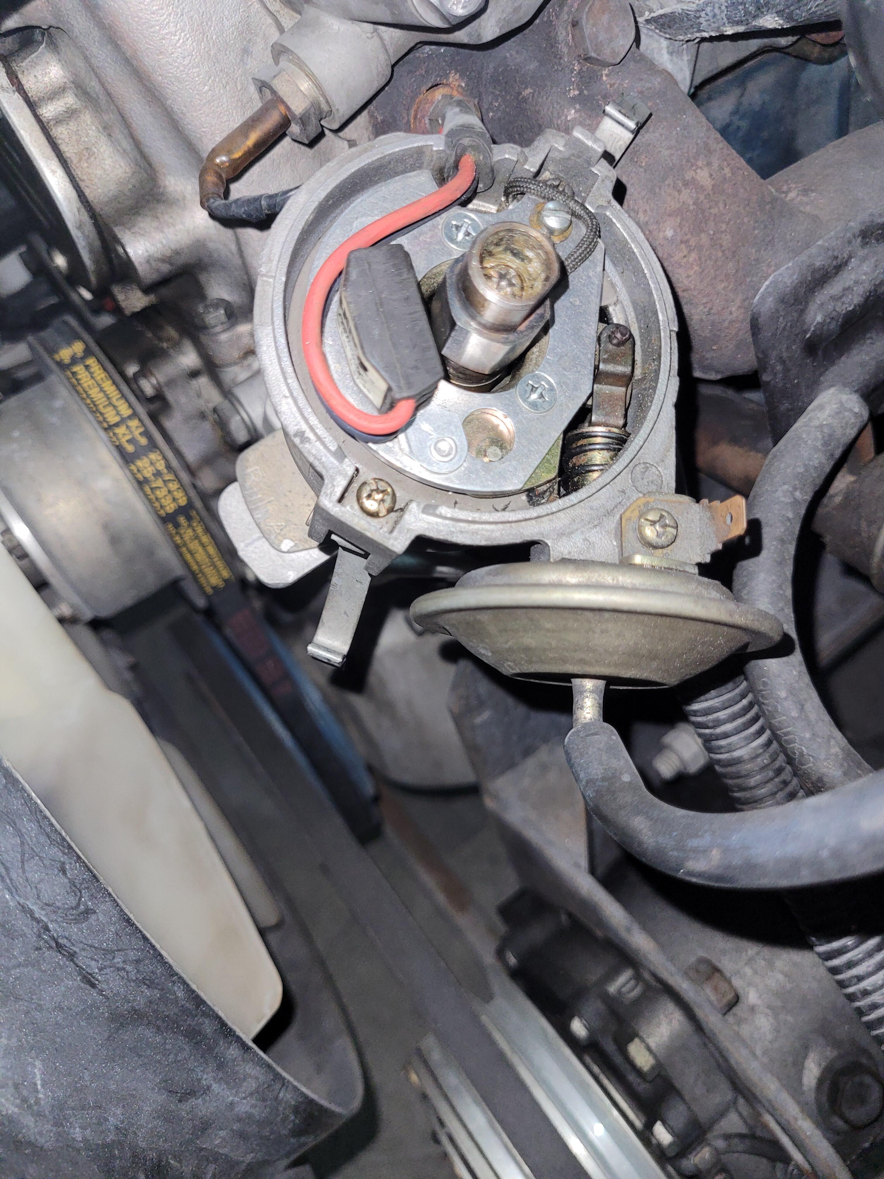

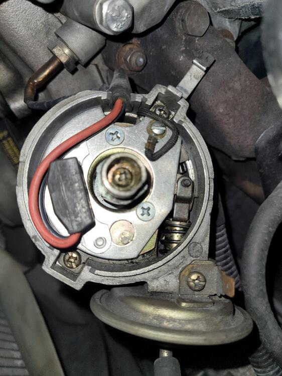

No, I would just make sure that the shaft doesnt have any play (wobbling around). Remove the cap, remove the center rotor (part that spins), then wiggle the metal shaft left and right. If it does have play, then you have issues with the dizzy bushings and it needs work. It will have play up and down but should not have play laterally.
Take the #4 plug wire and swap it with the #3 plug wire. Swap them at the plug AND the distributor cap. If your fouling plug moves to #3 then you have an ignition problem, if it doesnt you have a problem somewhere in the motor.

I dont see any play whatsoever

Did you physically move the shaft around in the dizzy? It needs to be more than a visual inspection.

While you have it open, you can suck on the vac advance rubber hose and make sure the advance is working properly. Plate should rotate and return. I dont think that's your issue but gives you some piece of mind that advance is working.
Replacing pertronix (as Patcon suggest) is easier than removing the head.
