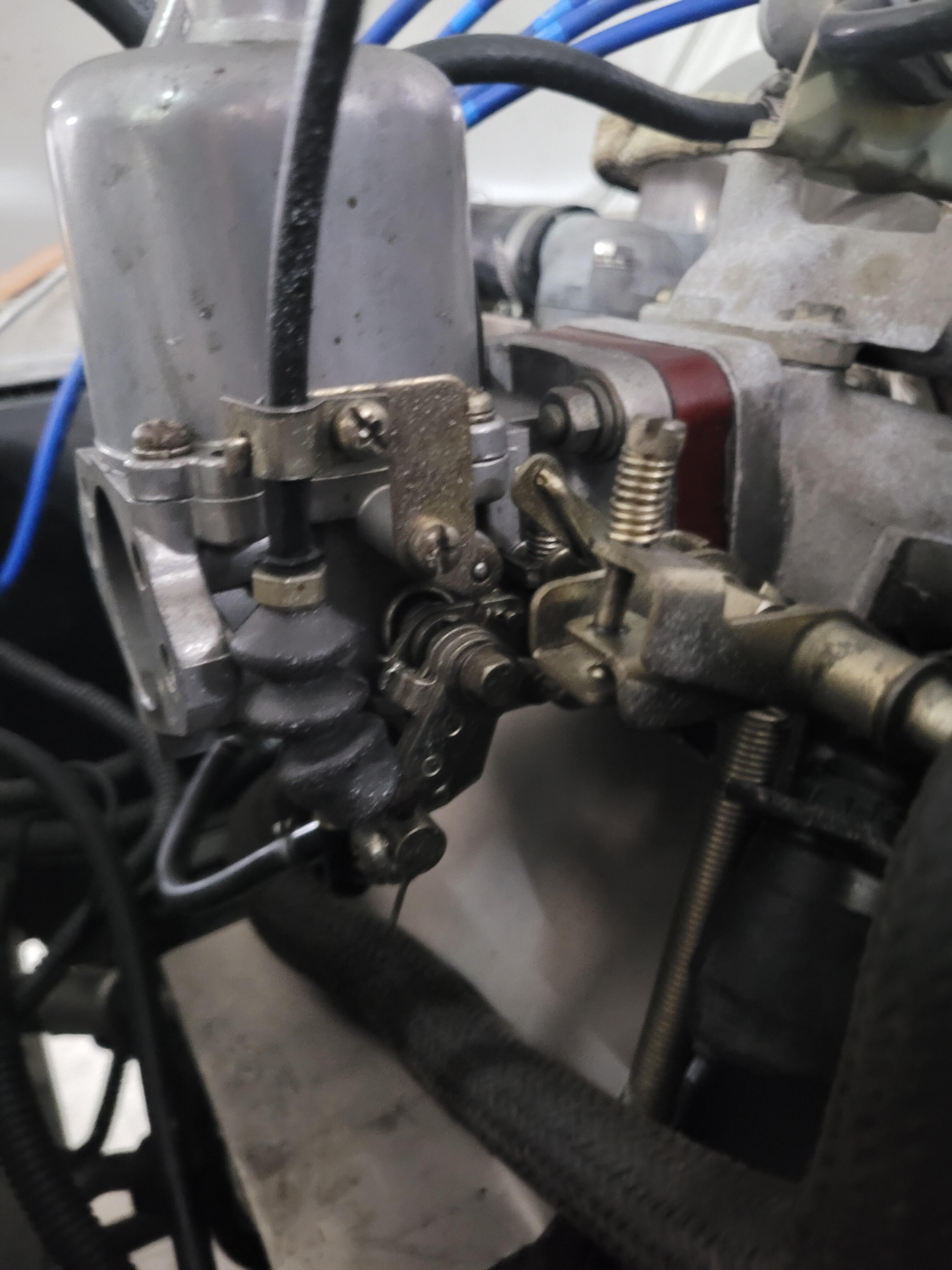

What you really need to check is that  the choke nozzle is fully seated (up) into the carb with choke off.  Black thing in the picture. Then put the choke on and check the nozzles, they should pull down, away from the carb. Do that a few times to make sure they arent hanging up. If the little rubber fuel lines are stiff, that can make them hang up.
You can loosen the screw at the cable and push up on the nozzles to make sure they are seated (blue arrow), then tighten. Fast idle is adjusted from a different place.
The main thing is the nozzle seating all the way with the choke lever off.

@jalexquijano When the choke knob is pushed into the off position are the nozzles pushed all the way up?  Use a mirror to check them.
Yes they are fully pushed up!

Both of these carbs were remanufactured in 2014 by Ztherapy. Fuel nozzles go all the way up once i close or reset the choke cable. Now i did noticed that i have to pull the choke to 3/4 for the fuel nozzle to move down. Which of the choke screws do i need to release so i can shorten that big slack? How do i get this done without depending on a 3rd party moving the choke lever?
 Loosen the two choke cable screws on the carbs, push the choke knob to a centimeter from closed, and tighten the screws. You state the nozzles are up. Was that a visual check or a Braille check? That little flat-bar linkage piece that pulls down the nozzles can warp and bind the nozzle in the down position,
