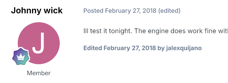

This thread seems to have gone awry.  Are Jalexquijano and Johnny wick the same person?  How did the name get changed?  And how did 72 Datsun 240z get inserted in here?  Is this our new AI world?
...just took a look around and see that Jalex and Johnny wick are the same.  Did not know that a person could erase their screen name from the past and take on a new identity.  Weird stuff!!
