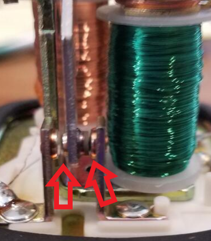

I can't measure the wires at the VR as I'm using a multimeter and don't have a DC clamp ammeter.  The VR is mechanical and pictures are attached.  I didn't see any type of adjustment.  Not sure why we are focusing on the VR can you elaborate?
It isn't adjustable. That's not uncommon for aftermarket VRs. If the VR is malfunctioning, the battery sense wire (white in the engine harness) could be feeding the field wire (white/black) that goes to the alternator. On an aftermarket 260Z VR that I have handy, the white/black is connected to a wire wound resistor. If it has voltage all of the time, that could be a current draw.
