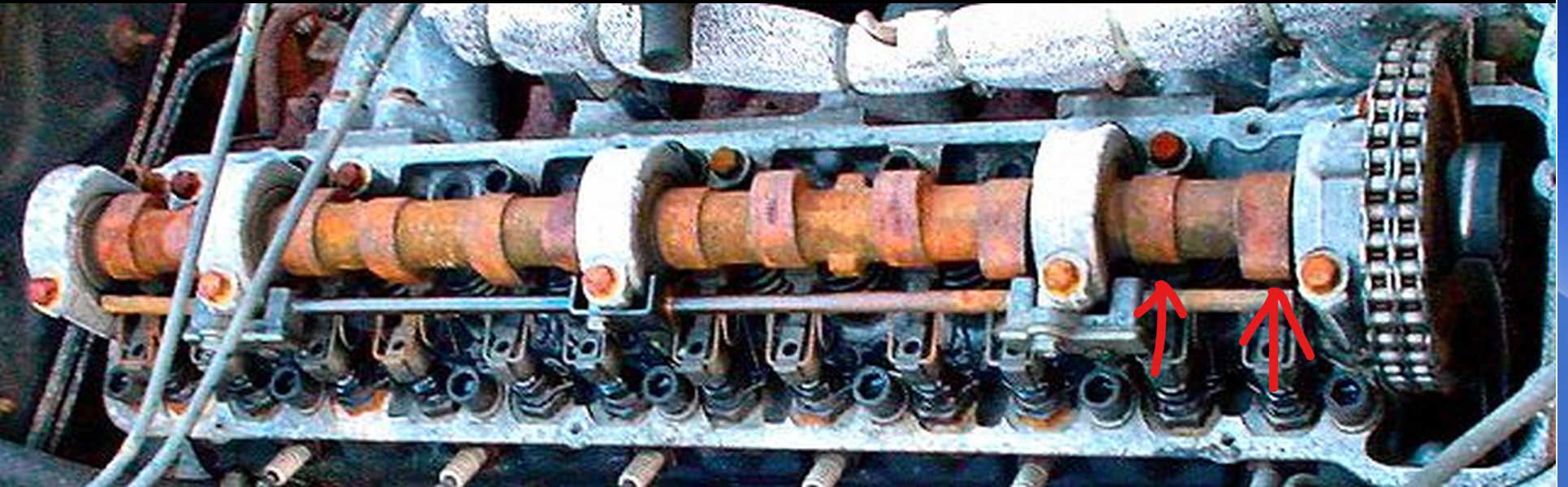

One of the easiest ways to get the engine to TDC is to use a remote starter like this: https://www.amazon.com/INNOVA-3630-Remote-Starter-Switch
You'll need to remove the valve cover so you can see the camshaft. You take the wire off the solenoid and clip the remote starter to it and clip the other wire on the remote starter to battery positive. Make sure the car is out of gear and use wheel chocks to keep the car from moving. Squeeze the trigger to turn the engine with the starter. You are looking to get the intake and exhaust lobes for cylinder 1 on the camshaft to be pointing up like "bunny ears". I marked the lobes you want to look at in the picture below. (Thanks, @240260280, for the photo.)
After you get the engine to TDC, remove the remote starting switch, put the wire back on the solenoid, and replace the valve cover.
