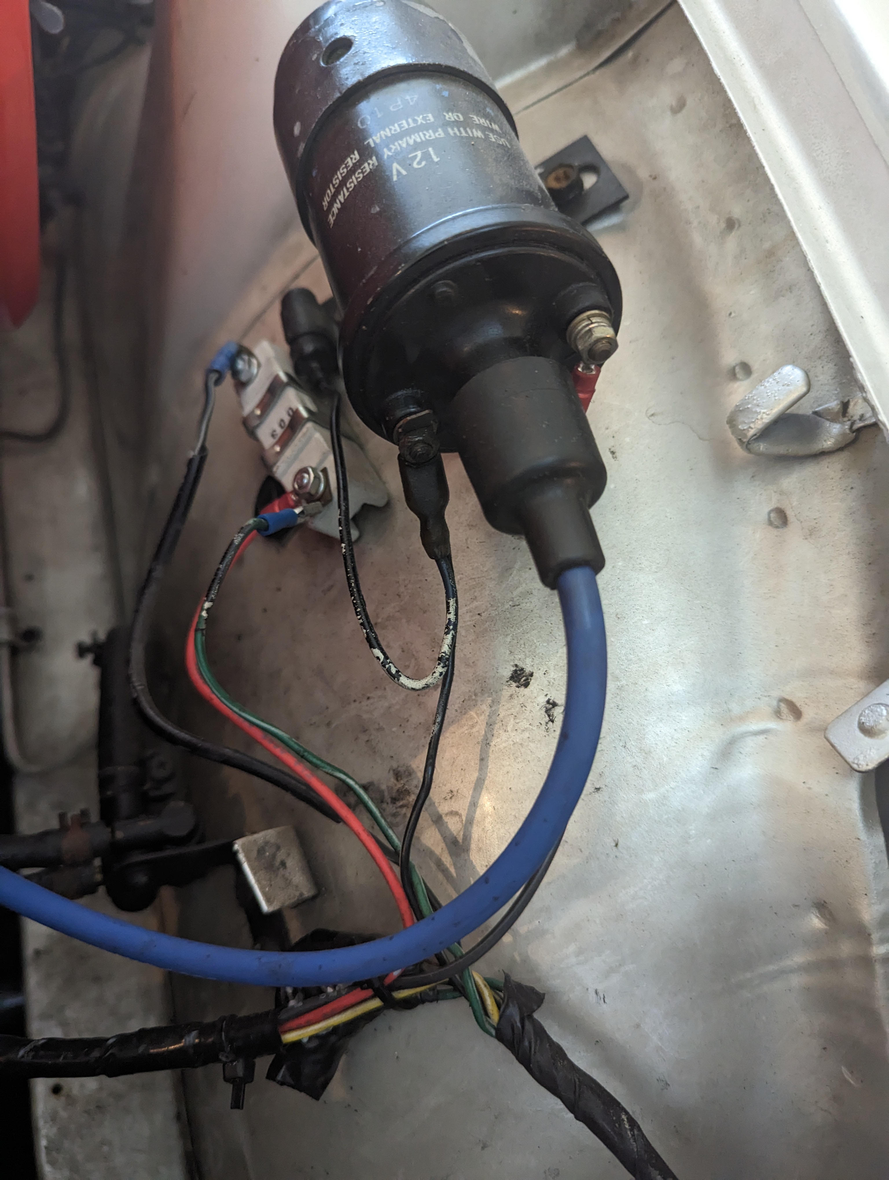

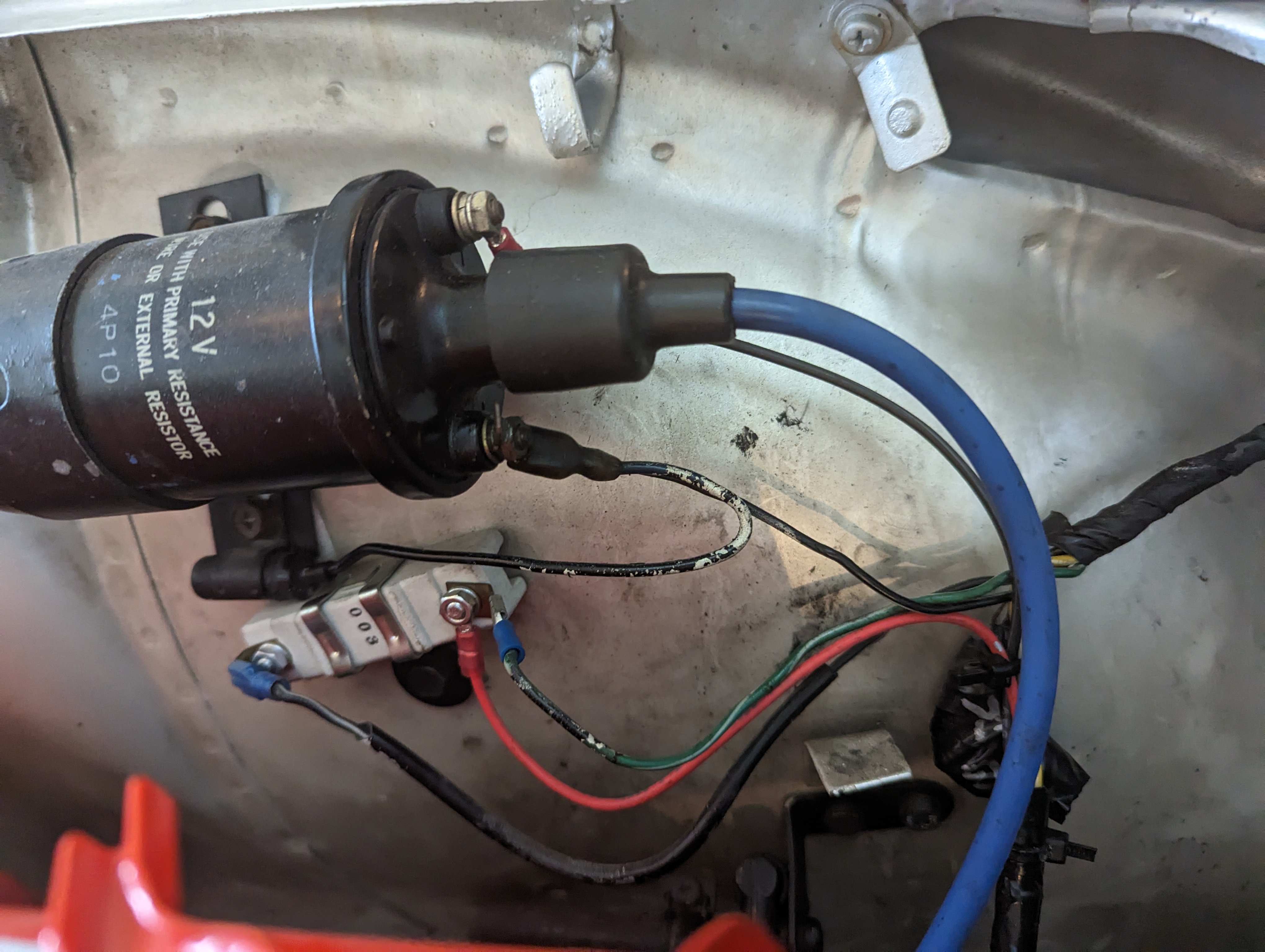

I have a related question. I installed the Pertronix Ignitor and it starts fine, but since then the fuel gauge is not accurate. It doesn't seem to move off of about 2/3 full, even when I run out of gas. 😞
Some wiring pics.
Edited by Dadsun
Interesting, Pure coincidence or it has to do with a bad ground? I can't - of the top of my head- say what this could be.. what has the ign.circuit in common with the fuelmeter? .....  ground?
As your meter stays on 2/3 full, there is obviously something wrong in the metercables, take a good look at the schematics..
Some wiring pics.
Very unlikely they are related. Start a new thread on the fuel gauge, and I'll give you some tests to run.
