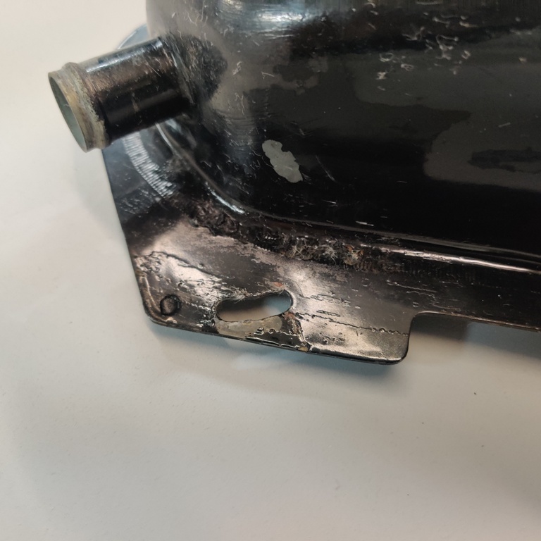

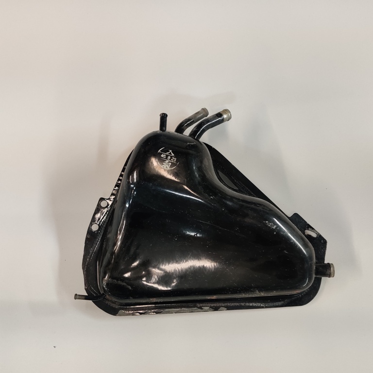

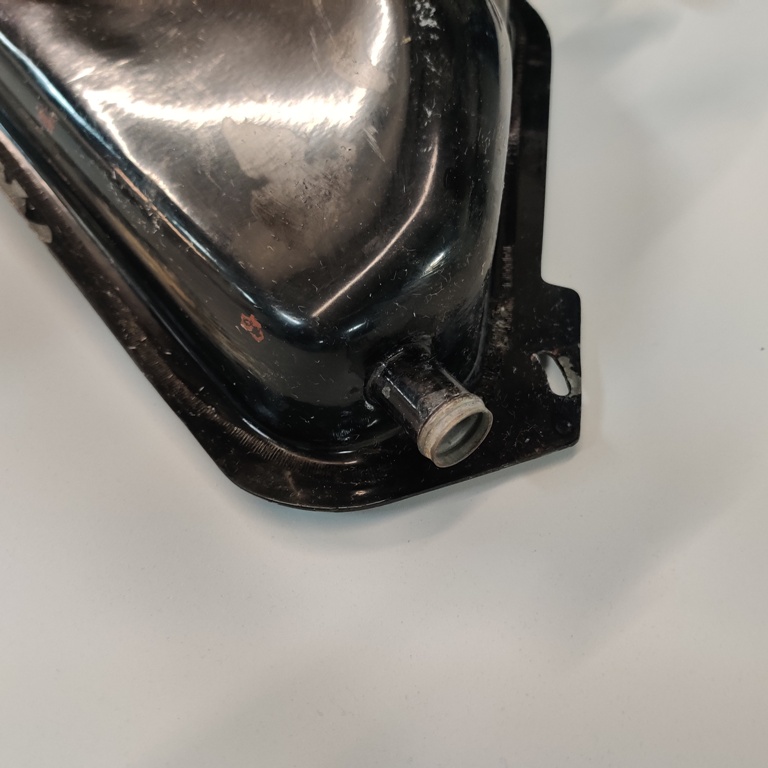

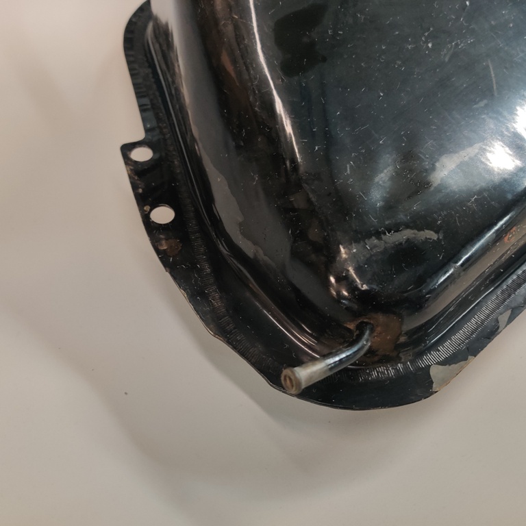

Overall view of "as installed" orientation, front bottom, back bottom:

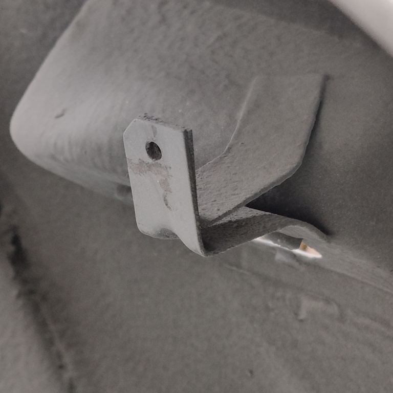

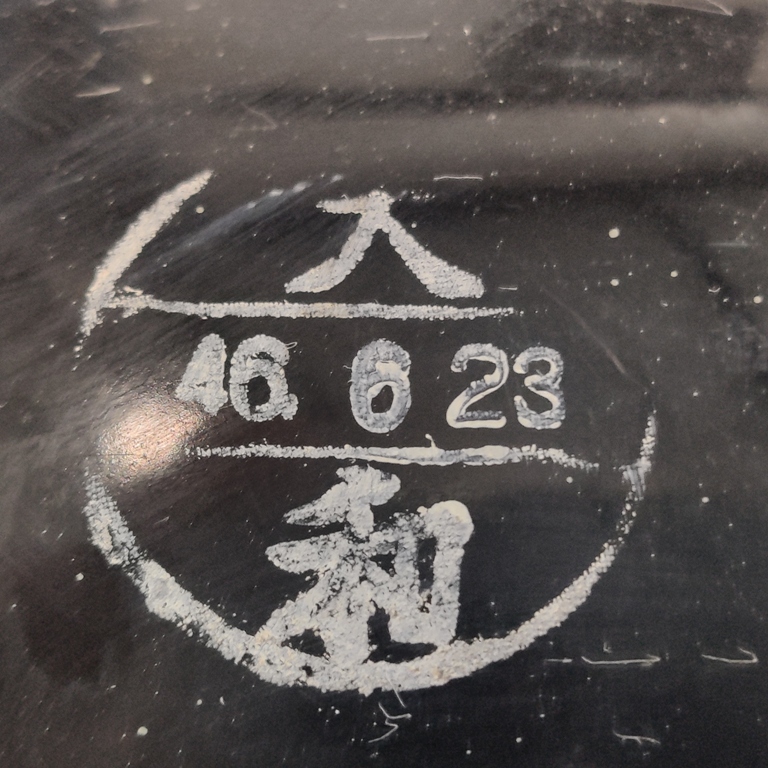

rear mounting tab detail, top front, date stamped on the tank... I don't know how to read that, maybe @KatZ can tell us?

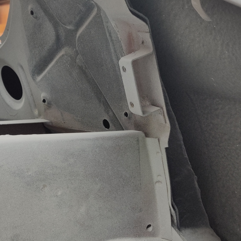

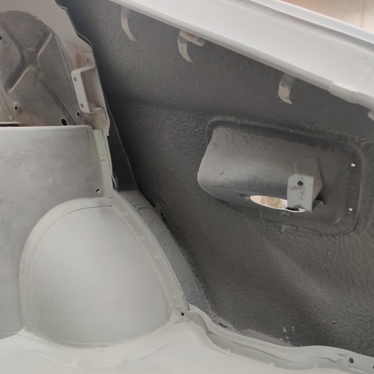

The mounting location in my 6/1971 car:

Ha! It would appear that my car, being manufactured in late June of 1971, received a metal tank "pre-maturely"!
Foosman, for what it is worth, fabricating brackets to fit a later metal tank looks easier than fabricating a tank.  Though, if a plastic one in good condition can be found for a reasonable price, then that might be the best route to take.
The '46 6 23' date stamp translates to 23rd June 1971.
'46' = 46th year of Showa = 1971 (First year of Emperor Showa's reign was 1925).
'6' = Month of June.
'23' = 23rd day of the month.

Yes - thanks @inline6for the pics, seems like adapting from my mounts to the later tank should be pretty easy.  I already have the later tank that a PO hacked in there (although they never secured it - it was just sitting loose behind the interior panel), and reverting to a plastic tank seems like a problem waiting to happen.  Might require going to a "later" interior panel, in case the bulge is different.  I'll have to check my 7/71 which should have the later metal tank (and panel) from the factory, although it has the series 1 diff setup (which also should have ended in 6/71) so who knows.

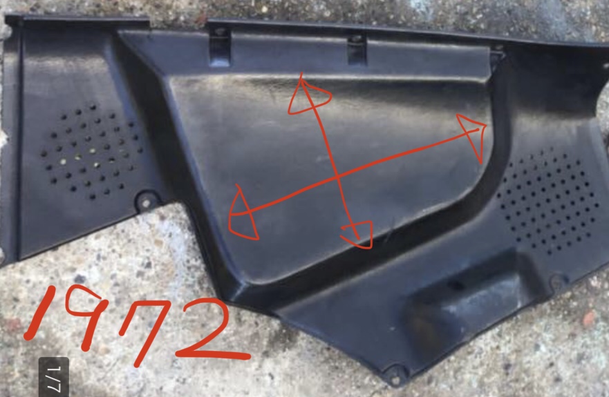

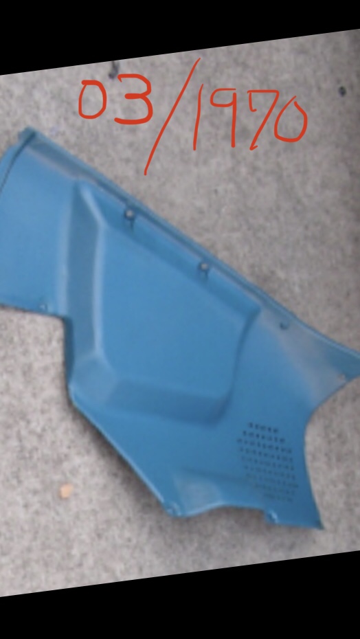

Hi, just a reminder of the difference between the two of interior trim panel. The Blue one is an early type which has a small box for the plastic tank. The black one is a later type which has a larger box for the metal tank. If you put a metal tank into an early car, the trim panel would not fit properly.
Kats
Edited by kats

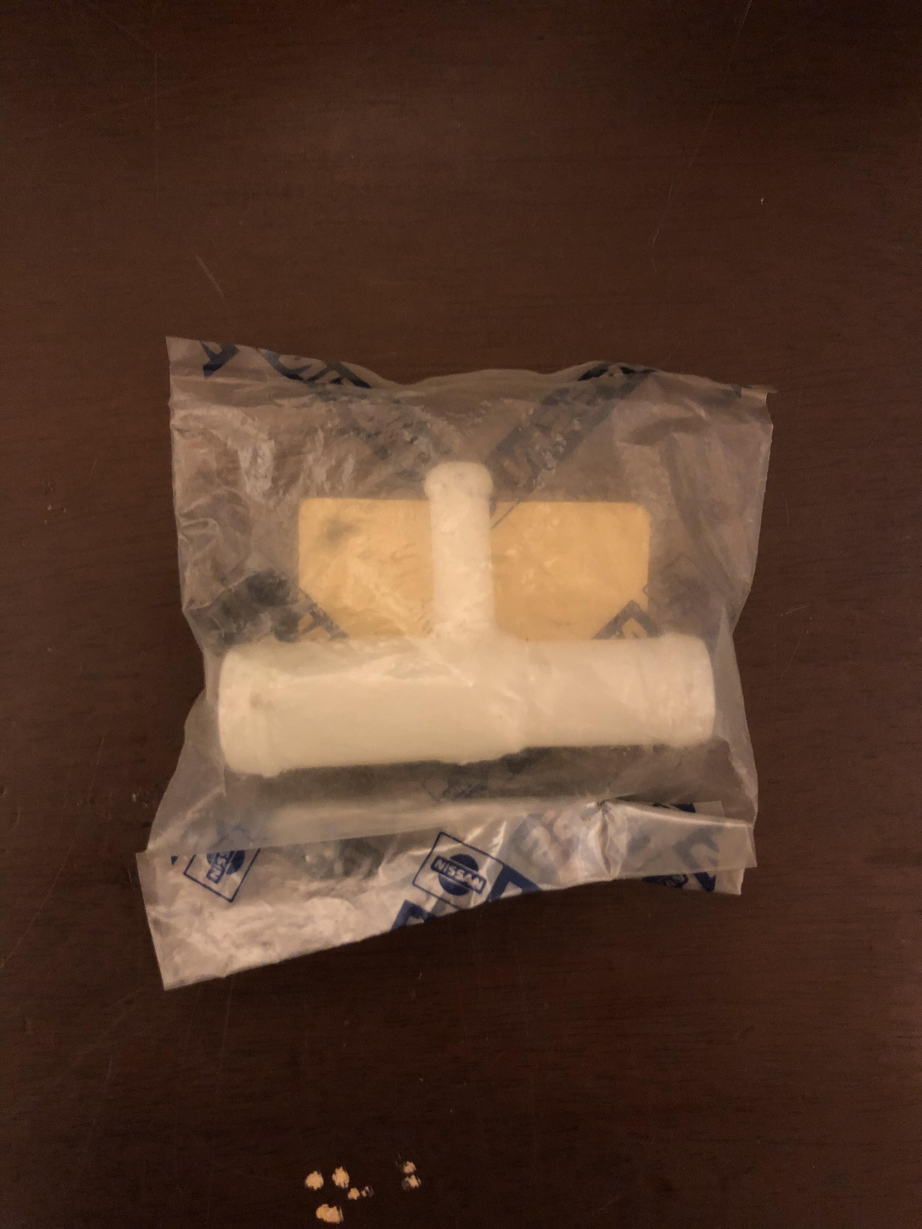

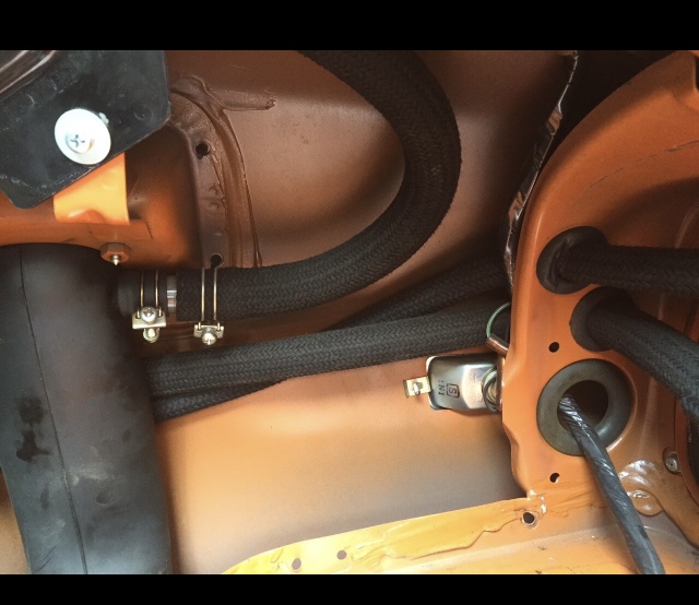

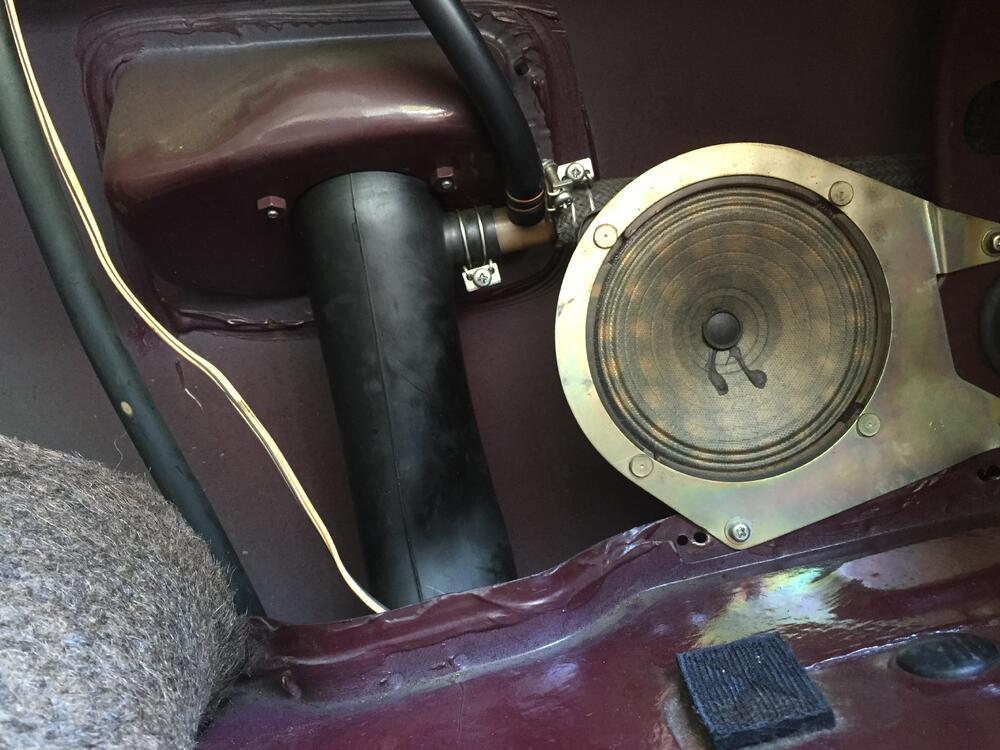

Hi dutchzcarguy , my Fairlady 240ZG has the same configuration. The three way connector pipe for the vent tube is also made of plastic and it tends to be brittle as it gets old especially the nipple for the small diameter tube.
The J shape bold vent hose from the tank is connected to this three way connector. And a small diameter tube is climbing upward to the clip on the upper edge of the quarter panel then going down to the rubber grommet to drain outside.
The hose I showed here is for the US version and it has longer end than the one for the three way connector.
So, the US version hose 17235-E4600 can be used for the Fairlady Z series also the cars without vapor tank. You just cut a little bit to fit the three way connector.
The orange is 12/1971 US Datsun 240Z,  the maroon is 06/1972 Fairlady 240ZG.
Kats
