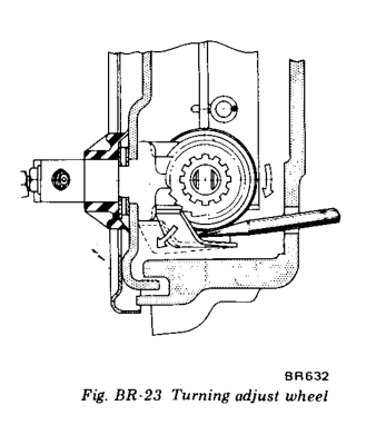

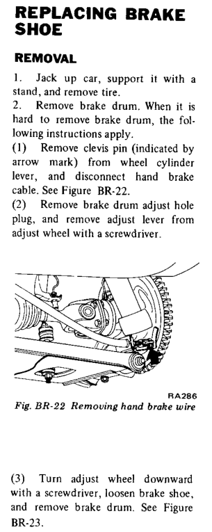

I don't see any access to the interior to adjust or move anything.
There should be a hole (on the flat front of drum) that is (possibly) closed with a sort of lead.. through that you can alter the brake.. see service manual.. but i would hit the front from the drum with a hammer.. just light hits all over them.. maybe some heat helps too?
That hole in the drums lets you turn the adjustment wheel on a 240. Not 100% sure if the 280s have that adjustment? but if you can't get the hole lined up to the toothed wheel then it's no good. Hit the drums with a rubber hammer or small sledge if you have replacements. My country arse would try dragging it with my lawnmower to unstick them, been there done that. LOL
  • Haha 3
It says: "Remove brake drum adjust hole plug" What beautiful english... 🤬
I would say: Remove plug out of brake drum adjust hole..  😮
( Because i would name the thing that's meant, first..  You guys.. tell me what is the better english? )
When I first noticed them stuck, they were only dragging.  It was possible for two people to push the car.  I disconnected the cables and with the help of a friend, pushed the car back and forth to try and free them.  No joy.  Unfortunately in the intervening time since then, they have become too stuck to push.  I hired a tow truck to move the car to my new house, and he had to literally drag it out with a winch.  No lawnmower I have access to is going to free them up!  I'm in the process of moving, and may not get to it for a week or two.  But I'll have another look at the drums to see if I can execute the process in the FSM.  The key will be seeing if I can apply enough torque to rotate the drums into position.
