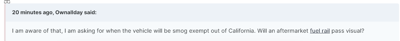

I am aware of that, I am asking for when the vehicle will be smog exempt out of California. Will an aftermarket fuel rail pass visual?

Your question specifically said California.
https://asktheref.org/Services/Smog-Check-Results-Review/
Why did my vehicle fail the smog inspection?
Vehicles can fail a Smog Check for any number of reasons, some common reasons for failing a smog check include:
  • Excessive tailpipe emissions
  • Modified with non-approved parts or computer programing
  • Check Engine light or OBD monitor failures
  • Faulty sensors or computer controls
  • Vacuum leaks
  • Other
