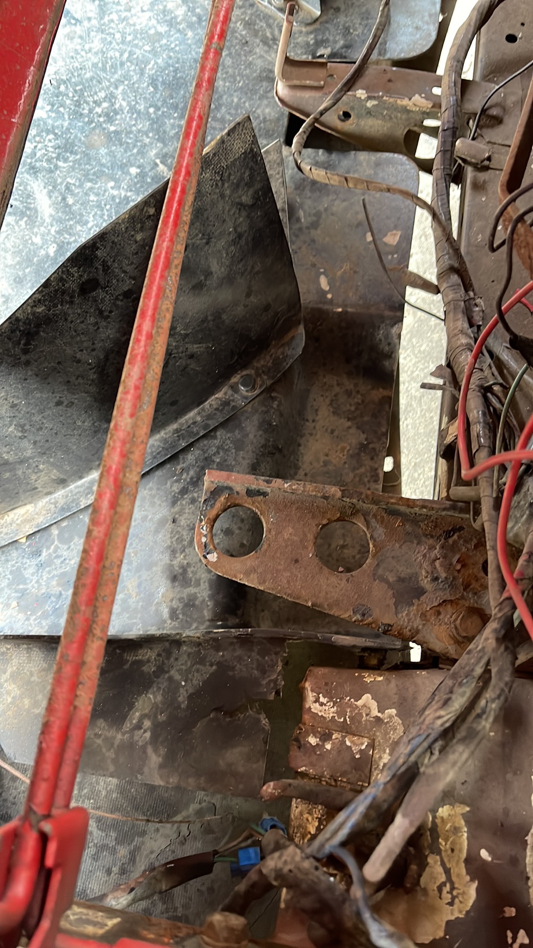

Could you see the chopped  bracket which is used for the cars non-G nose S30? This is how Nissan Shatai did at the assembly line.

Ah I see, the side grill mount bracket.
 I will be back with car tomorrow and check for the bracket condition.
