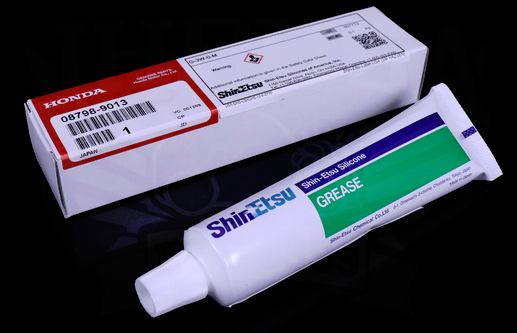

A couple of ideas:
1.  Get yourself a tube of ShinEtsu grease and apply a good amount around your hatch gasket. Keep the hatch open overnight to allow the grease to soak in and expand the rubber a bit.  This technique works well with leaky t-tops and may help your situation.  Then, take the car out for a run.
2.  It is hard to tell in the photograph, but it looks like you have a Fujitsubo Legalis R exhaust system installed.  As goofy as it sounds, I would try using about a foot length of PVC pipe (or similar) and attach it to each of your tailpipe tips and make the seal air tight with something like aluminum tape.  Drive around the block with the widows down and then up to see if the extension makes any difference in the fumes.
These suggestions may seem a bit unorthodox, but you have pretty much tried the all normal remedies.
4 hours ago, DatsunZGuy said:
A couple of ideas:
