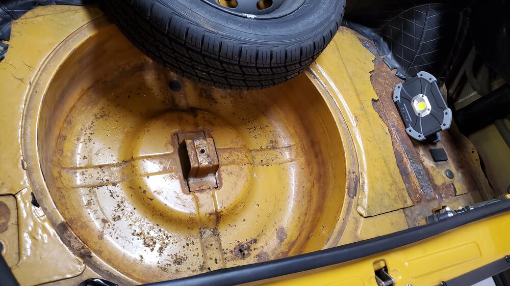

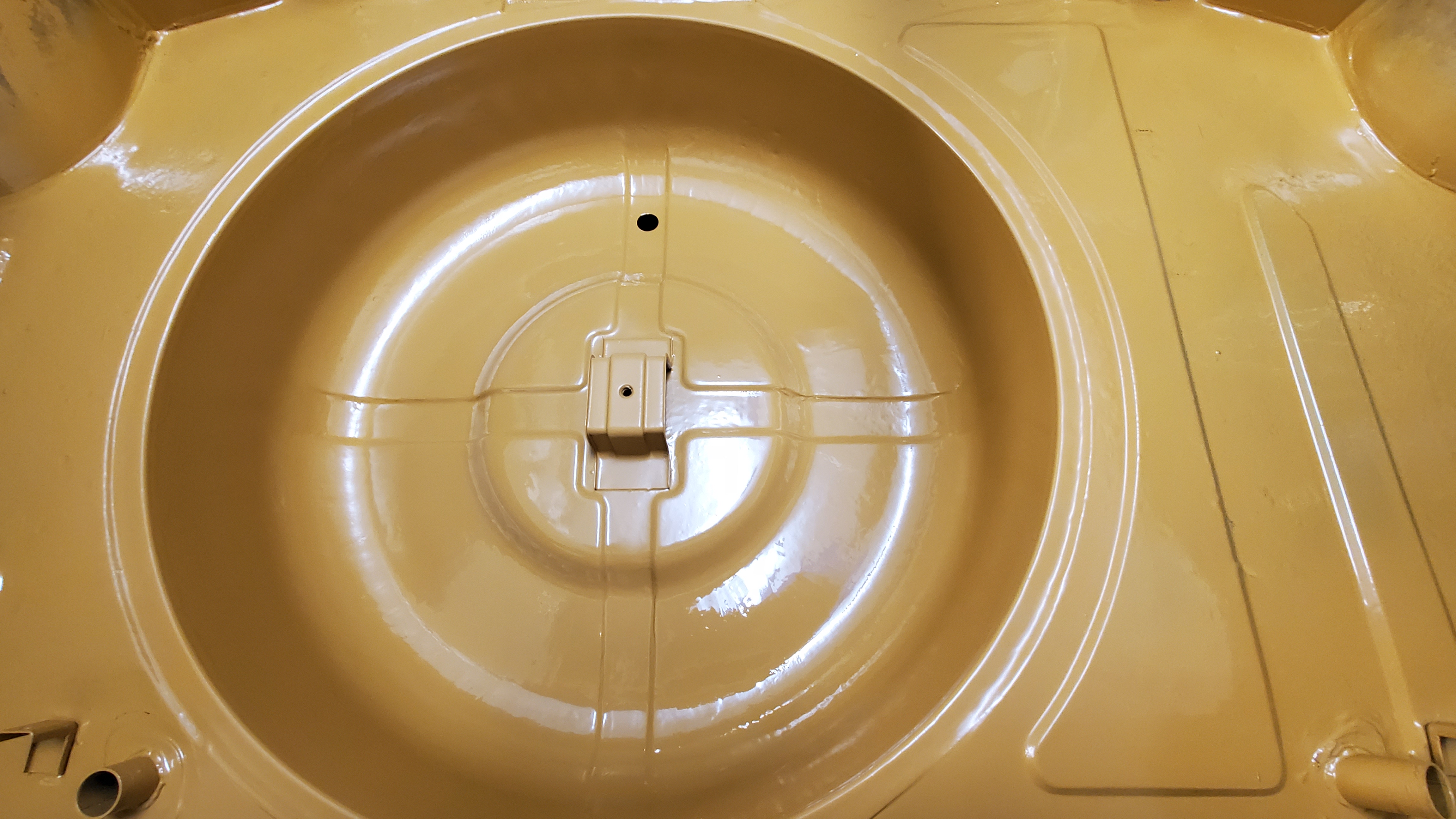

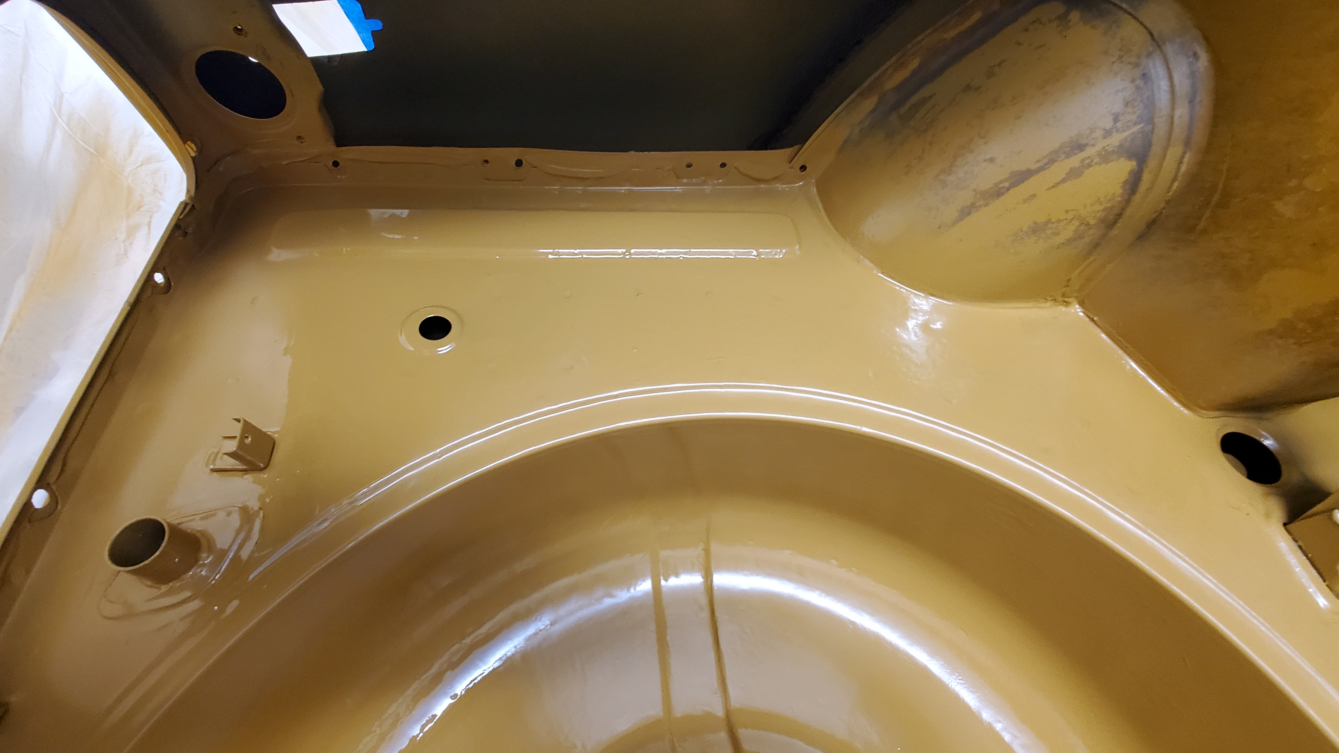

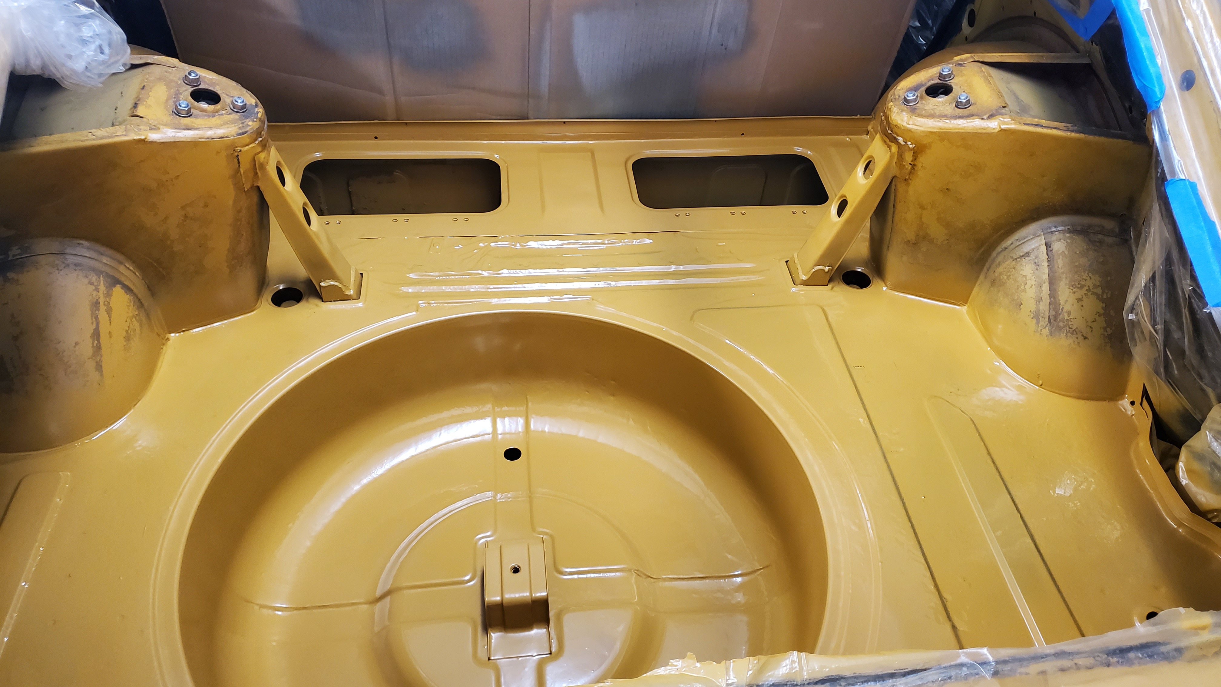

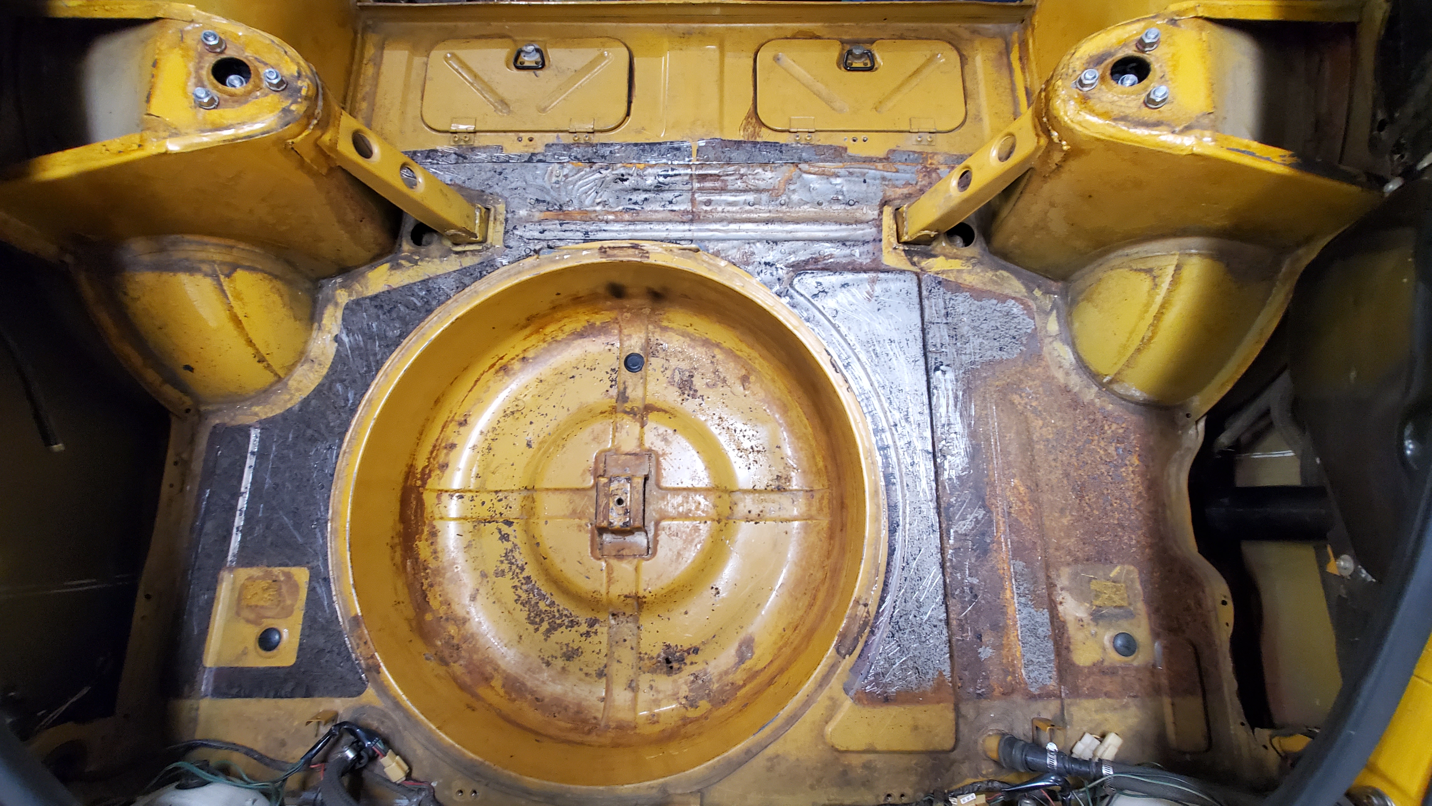

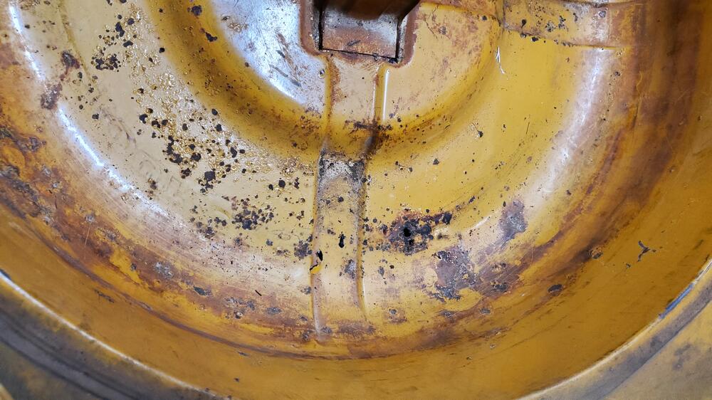

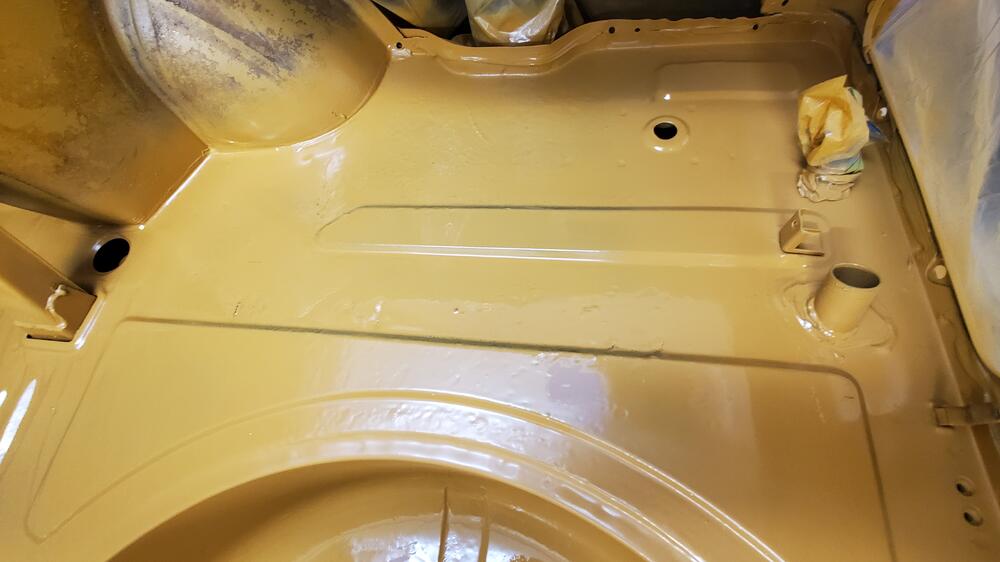

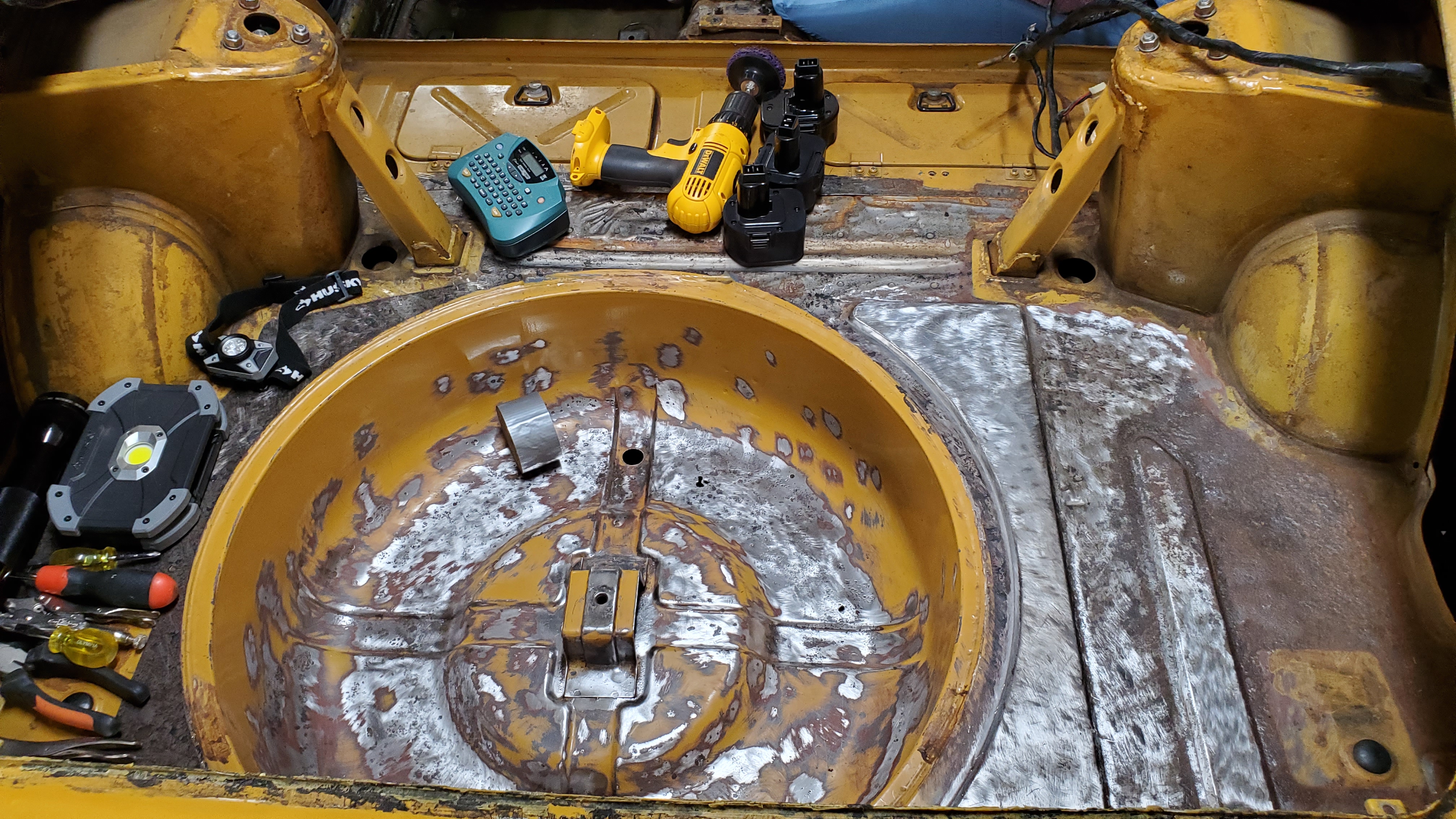

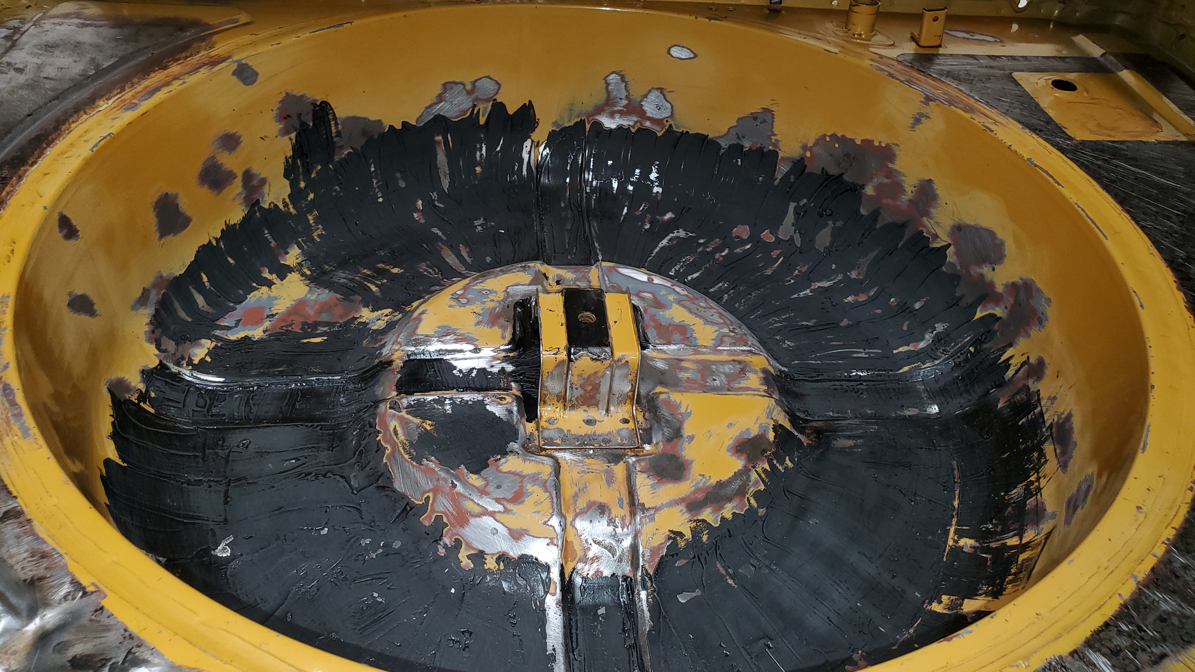

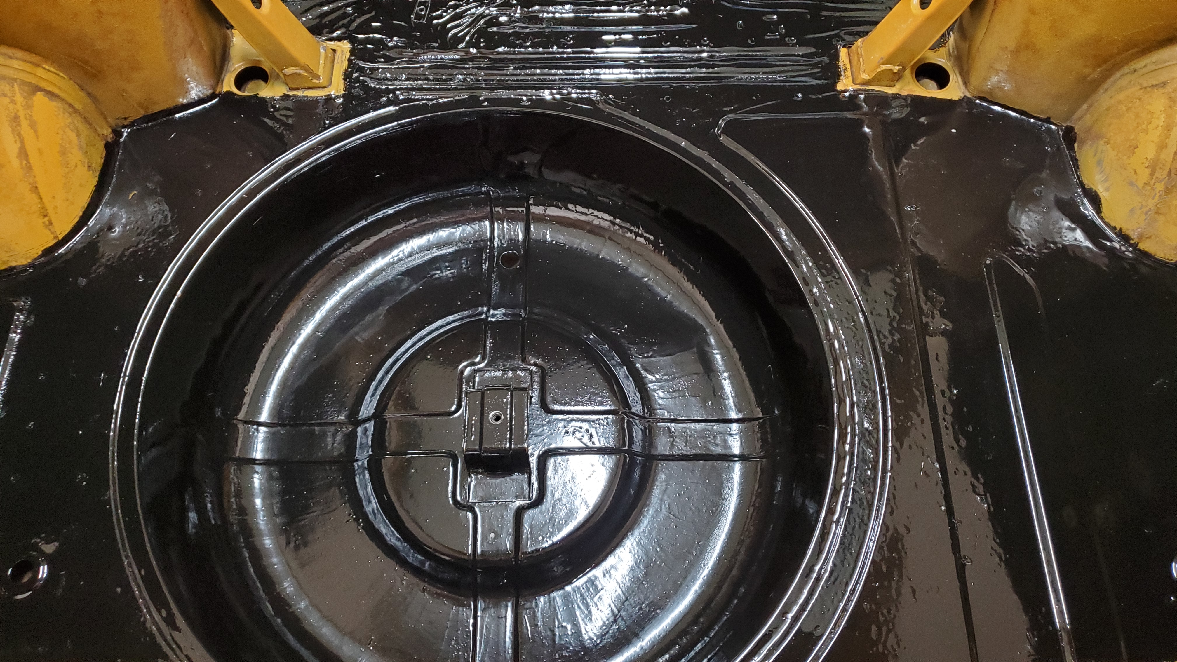

Good timing on this question as I was just going to update the group on my progress.  I havent actually put any of the hoses in yet as I got distracted once I saw the condition of the old sound deadening and wheel well.  I figured that all needed to be dealt with first so I stripped the entire back of the car and went to town.  Once I got it all up I found that most of it was just surface rust from trapped moisture.  The wheel well had some small pitted spots and a few poke through but nothing big enough to get a finger through.  Everything was sound so I got some POR 15 patch and paint and ground it all down, prepped it, filled it, POR painted it, sanded it and finally finished it with one stage spray cans since I don't have a sprayer or air supply or anything resembling professional gear.

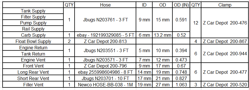

Before I get to before and after pictures, back to the hoses.  I found that some of the supplied information just wasn't working for me so I sourced a few different items to better fit what I needed.  I had started by looking for things pre-shaped for some of the funky bends before knowing the spring door trick (which is awesome).  So I had already purchased from Z Car Depot the bent hose for the front vent.  Since I had that in hand the rest of the shopping list diverted a bit from recommended.  The biggest issue I had was that the 17 MM recommendation for the filler vent just would not fit.  I had to get a 19 MM hose which now fits perfectly.
So in summary here is my shopping list and what I had purchased from a length perspective, some out of need, some out of direct measurement.  I also had a need for all new clamps as the PO had a hornets nest of crap everywhere.  Hope this helps people starting from scratch.

Before
Midway
Done

Ok, now I’m completely mixed up…in your chart you have the hose description and the length and in another column you have the quantity?  I’m just looking to get everything together, then drop the tank, replace then re-install…..hopefully!  Hahahaha.   By the way….really nice job finishing the spare tire tub!👍
Thanks, it took a while but worth it.  So for my chart I grouped hoses of the same ID size since most places you buy a hose its precut to a certain length or you can buy it by the ft.  The left side of the chart is all about the hose you need to buy, the right side is about new 2 wire clamps (if you need them).  Here's an example, if you buy qty 1 jbugs N203761 at 3 ft length it will cover the 4 places on your car on the left of it in the chart (tank supply to hard line, hard line to filter, out of filter to mechanical pump, out of pump to rail).  All of those hoses are the same ID from tank to rail.  if you buy qty 1 that ebay item (only sells 5 ft) then you can replace the 2 hoses from rail to carb.  Thats 6 hose sections in the car overall for the 2 lengths/parts of hose listed.  Then on the right I matched the OD for those two hose types and they all will fit in the z car depot part 200-476 clamp.  Thats why on the right they are grouped like that qty 12 (6 hose sections x 2 clamps).
Hopefully that makes sense now.  Of course this assumes you wanted to replace all fuel / vapor hoses tank, engine, etc like I need to.
Sorry, i see my chart it was the one thing i missed.  Its from Newco BLACK BRAIDED HOSE BB-038 M19X4.4
https://www.newcoproducts.com/index.php?route=product/product&product_id=4053
I corrected the chart now in my original post.
