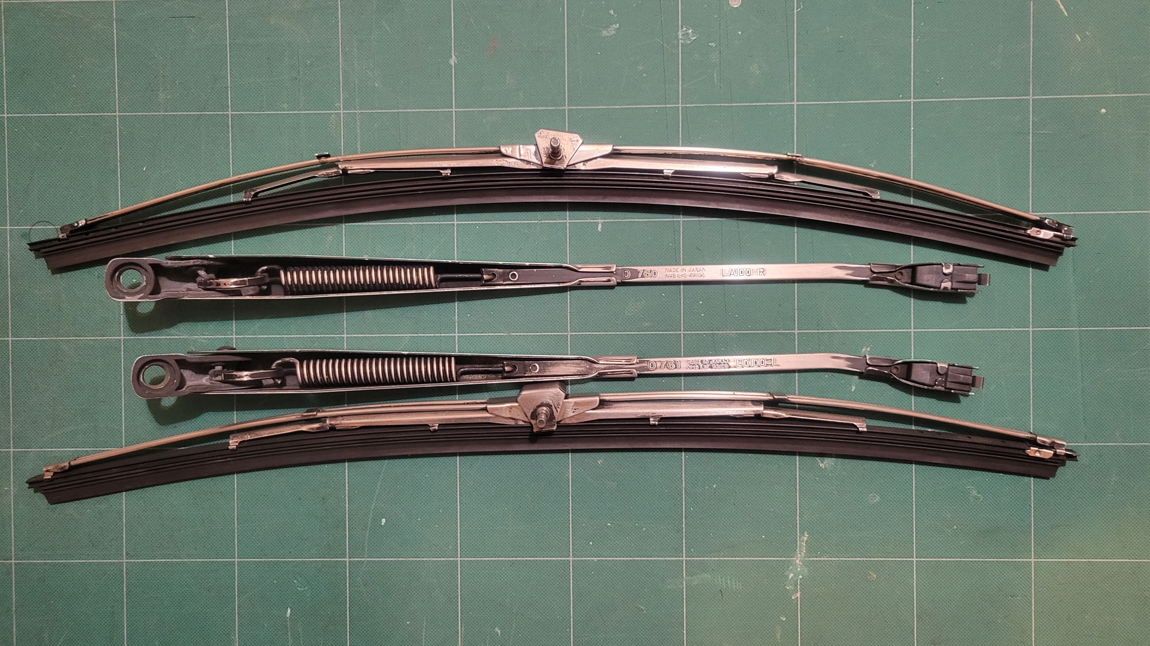

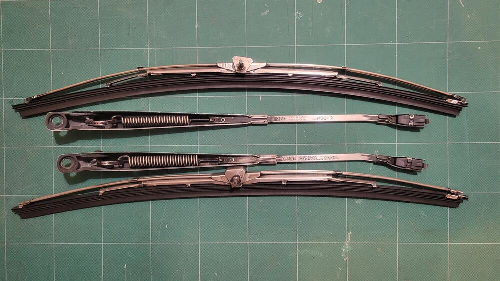

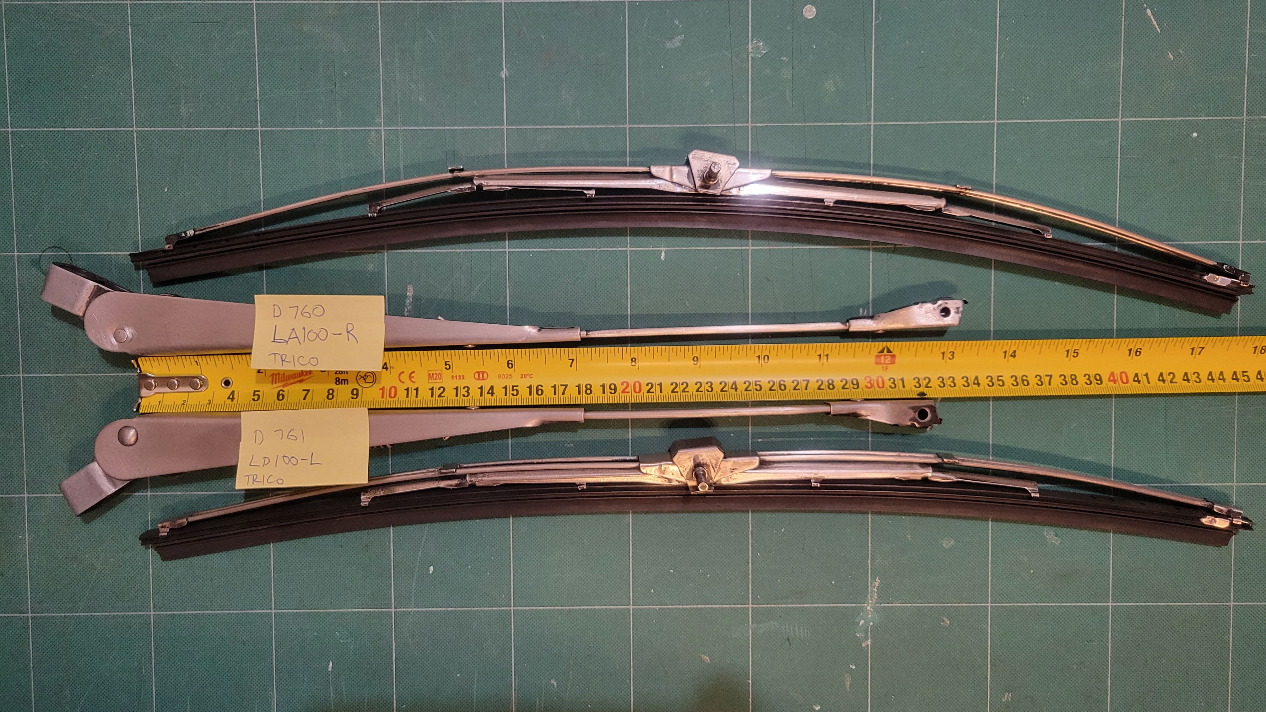

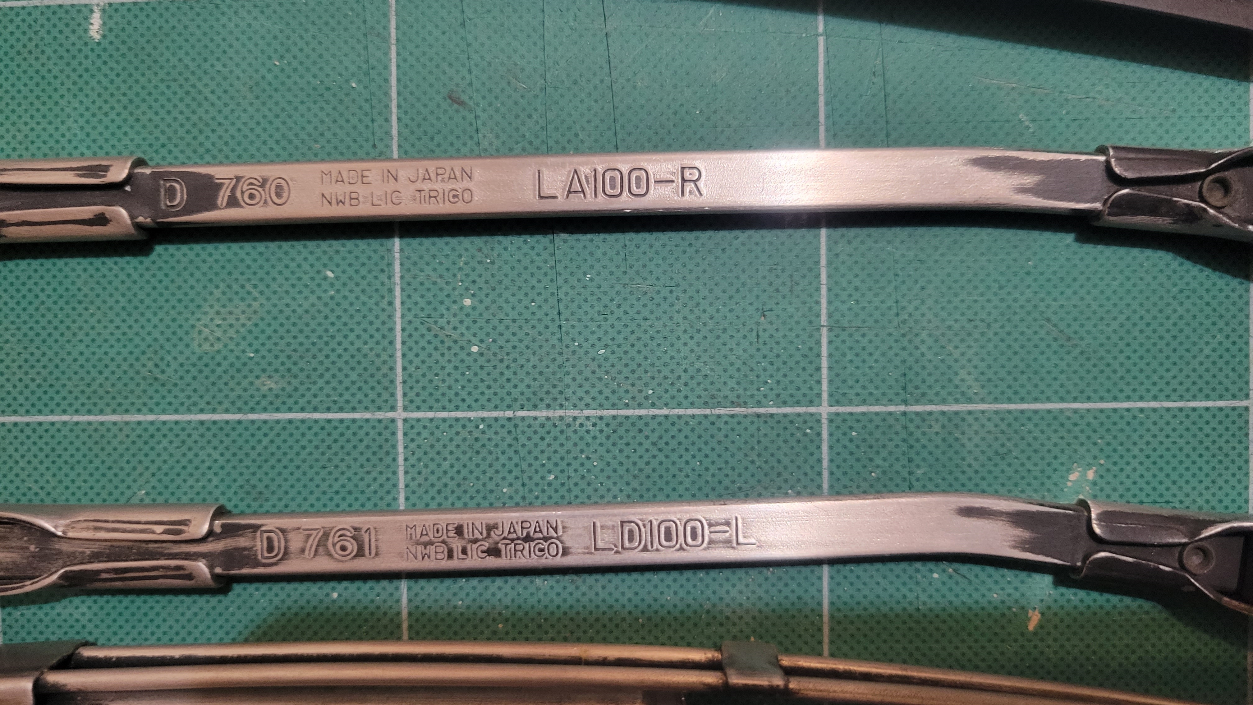

Here is a pair of 280Z arms and blades that I got in trade from @240260280a few years ago. They are not actually correct for my 7/70 240Z but after I removed the black paint they looked good to me. The arms seem to identified left and right by the markings as these in these pic of mine.
The right arm is longer, but only by half an inch. (The zero on the tape is in line with the center of the rivet, the photo distorts the view.)

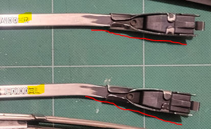

You're welcome. Actually I saw 280Z in the topic title. I did notice one other difference between the right and left. The end of the left has more of an angle than the right.

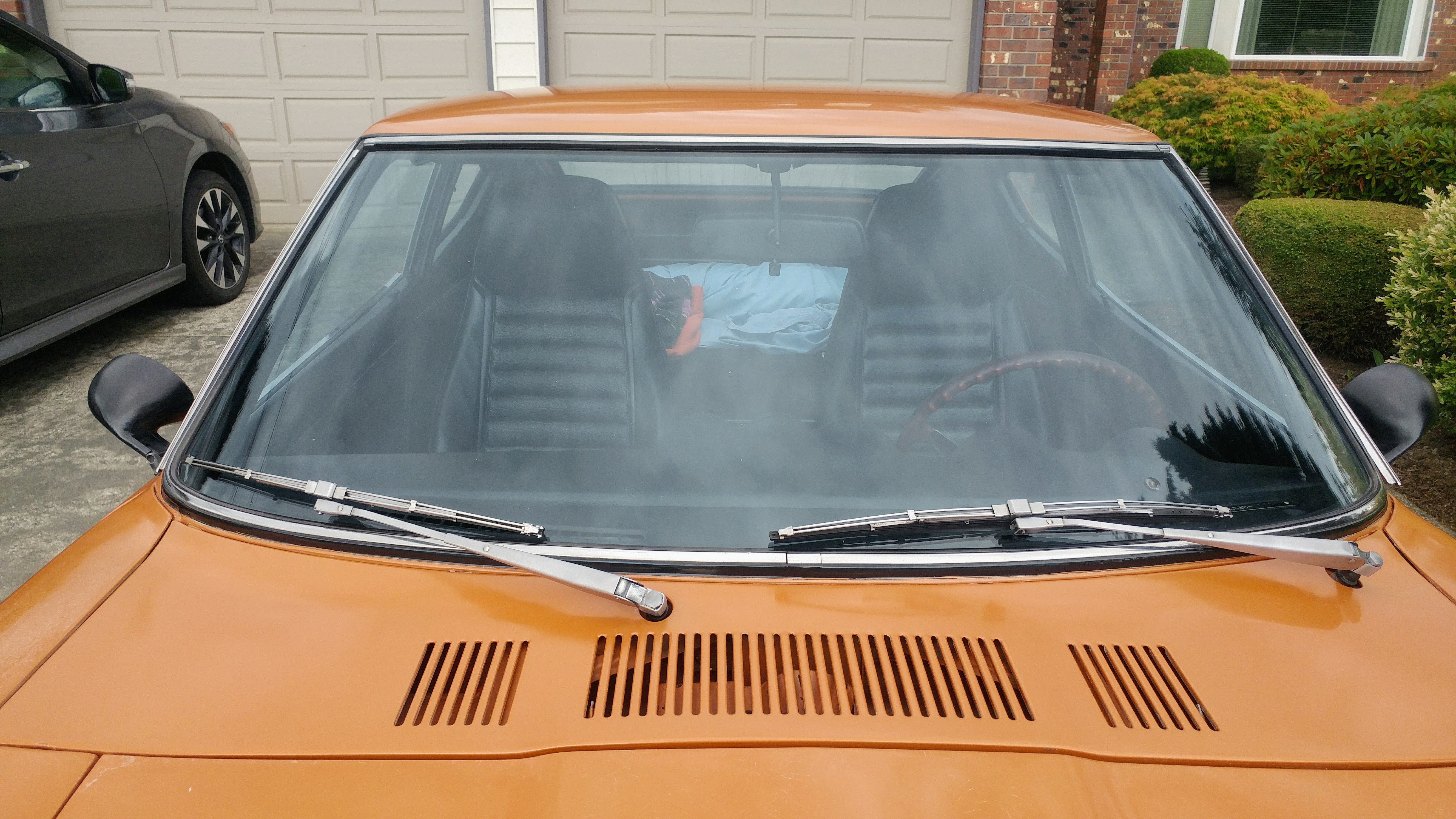

Well, after all that, I got out the arm that was still in the car and looked at it, comparing it with the pictures in this thread and...
...it isn't even a wiper from a 280Z.
When I bought the car it had a bunch of parts in the trunk, mostly its own.  There were a handful of parts form other cars in there.  I guess this is another one.
So I guess I'm looking for the set.  Thanks for your help guys.
