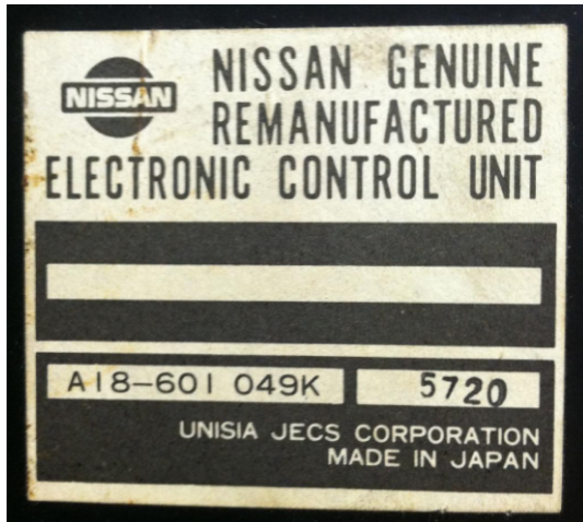

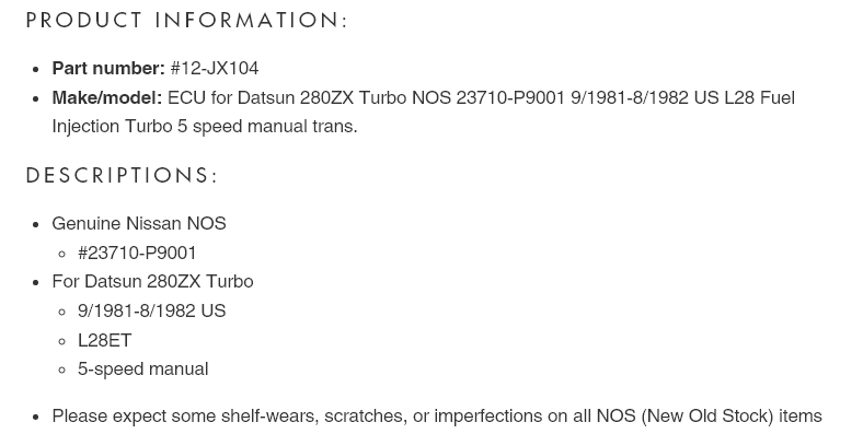

Zed Head Posted March 24, 2023 Share #3 Posted March 24, 2023 On 3/18/2023 at 6:23 AM, dutchzcarguy said: usa version will not fit Will not fit or will not work? Check the FSM wiring diagrams. Get some part numbers. https://www.zdriver.com/forums/fs-240z-260z-280z-280zx-70-83-242/82-280zx-turbo-ecu-nissan-remanufactured-unit-35890/ https://maseraticompound.com/products/datsun-280zx-turbo-engine-ecu https://jdm-car-parts.com/products/ecu-for-datsun-280zx-turbo-nos?variant=744994189 Link to comment https://www.classiczcars.com/topic/68206-wanted-ecueccs-for-euro-1983-280zx-turbo-and-diff-between-those-from-eu-and-usa-model/#findComment-651727 Share on other sites More sharing options...

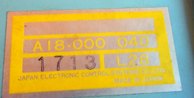

dutchzcarguy Posted March 25, 2023 Author Share #4 Posted March 25, 2023 (edited) Thanks ZED! But i only repeat what he told me, i'm just helping him out, if someone has one i give his adres (if he is oké with that.) He told me that a USA version did not fit.. (Also: a euro has 204 HP and a usa has 180HP .. or could it be that there is a difference because the usa is in HP DIN. and the euro is in HP SAE ? (That could explain the difference!) He sended me a pic of the connector of his 280zx turbo: I got a 280zx turbo service manual but they only refer to it as: The EFI control unit.. No numbers no nothing.. I see that the unit on zdriver.com has a complete different connector.. actually 2 connectors! so that's probably why it won't fit. Edited March 25, 2023 by dutchzcarguy Link to comment https://www.classiczcars.com/topic/68206-wanted-ecueccs-for-euro-1983-280zx-turbo-and-diff-between-those-from-eu-and-usa-model/#findComment-651743 Share on other sites More sharing options...
dutchzcarguy Posted March 25, 2023 Author Share #5 Posted March 25, 2023 280zx turbo USA version.. won't fit.. see connector euro and connectorS usa.. Link to comment https://www.classiczcars.com/topic/68206-wanted-ecueccs-for-euro-1983-280zx-turbo-and-diff-between-those-from-eu-and-usa-model/#findComment-651744 Share on other sites More sharing options...
