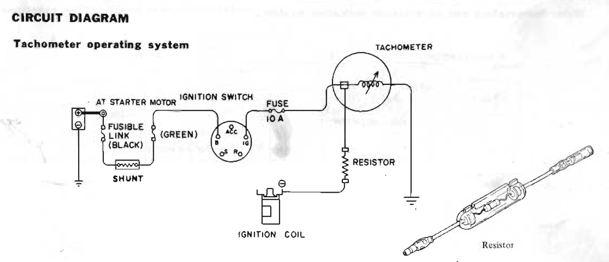

Anyway,  just for viewing pleasure, here is the FSM schematic of the tachometer in a 260Z.  I assume that the square with the line through it represents a switch, probably a transistor, that is actuated by the square wave from the coil negative terminal.  You can see that the tachometer just passes current with each pulse from the coil.
