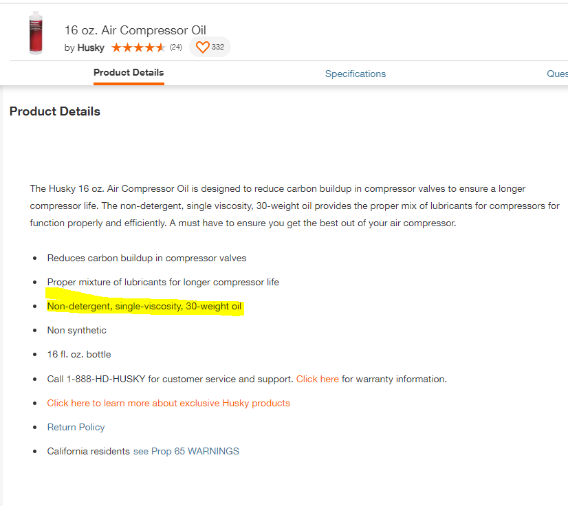

Chime in gents, I’ve been told that you use 30W Non detergent in compressors. Did the labeling on the Husky bottle list what the contents and viscosity?

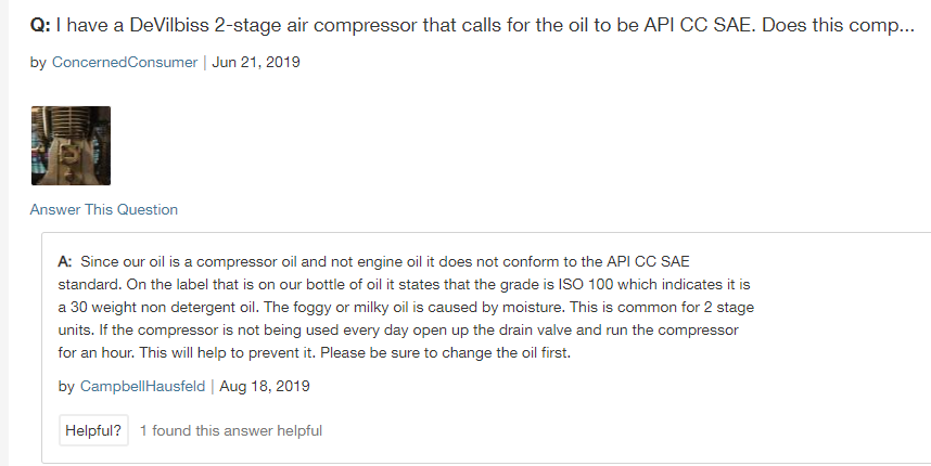

I looked at the Q&A on the oil Garrett used.
13 hours ago, inline6 said:
Yes.  For many of those years, it got little use.  I am unsure of how many times, but probably about 6.  I just changed it about a month ago before I started on a rather lengthy round of blasting all of the black parts for the car I am restoring.  I was shocked at the price of the compressor oil - nearly $12 for each 16 ounce bottle.  And it took 3 and half of these.
https://www.homedepot.com/p/Husky-16-oz-Air-Compressor-Oil-HDA10700AV/100096995
You’re an exception.
Oh.  That is interesting. Thanks Steve.  Looks like I should investigate API CC SAE and ISO 100 - consult my compressor manual and may need to remove and replace the $44 dollars worth of oil I just put in recently.  I'll investigate.
