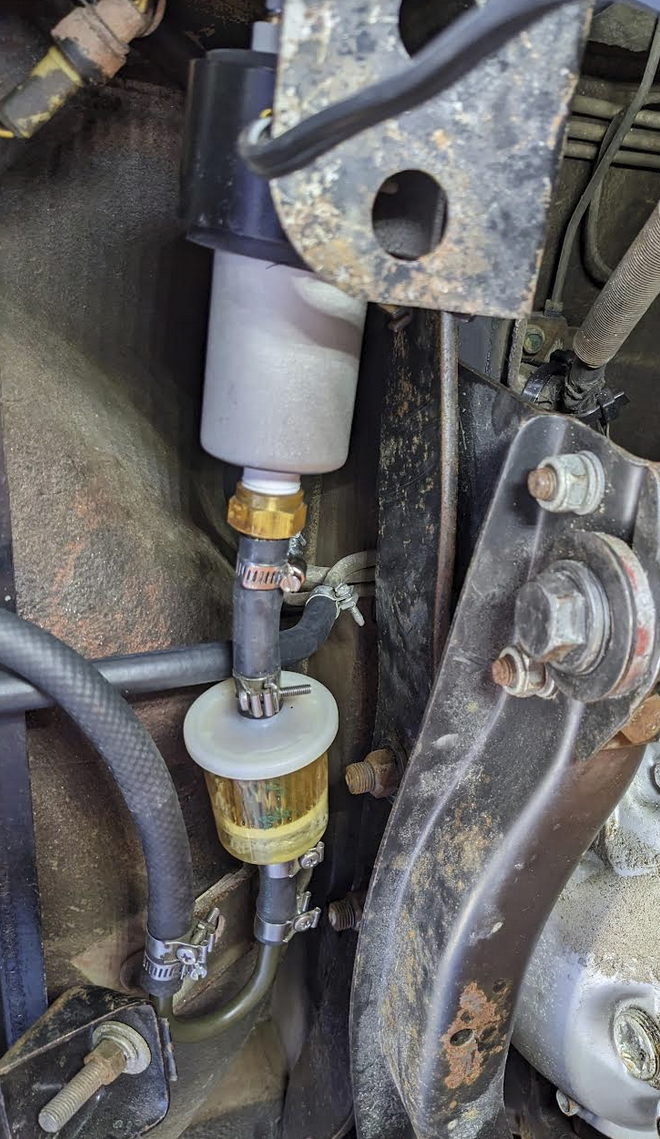

I've got 2 Zs with the plastic pre pump filter. They stay full of fuel. Does yours? It looks close to empty in your pic which could be something simple in the flow direction. If those pumps aren't fed adequately they'll overheat and live a short life.
@siteunseen The picture was taken when I just installed the pump. The pre-filter is full of fuel - that was the first thing I checked this morning. It has become a habit to check on rust coloring of the inside of the tank.

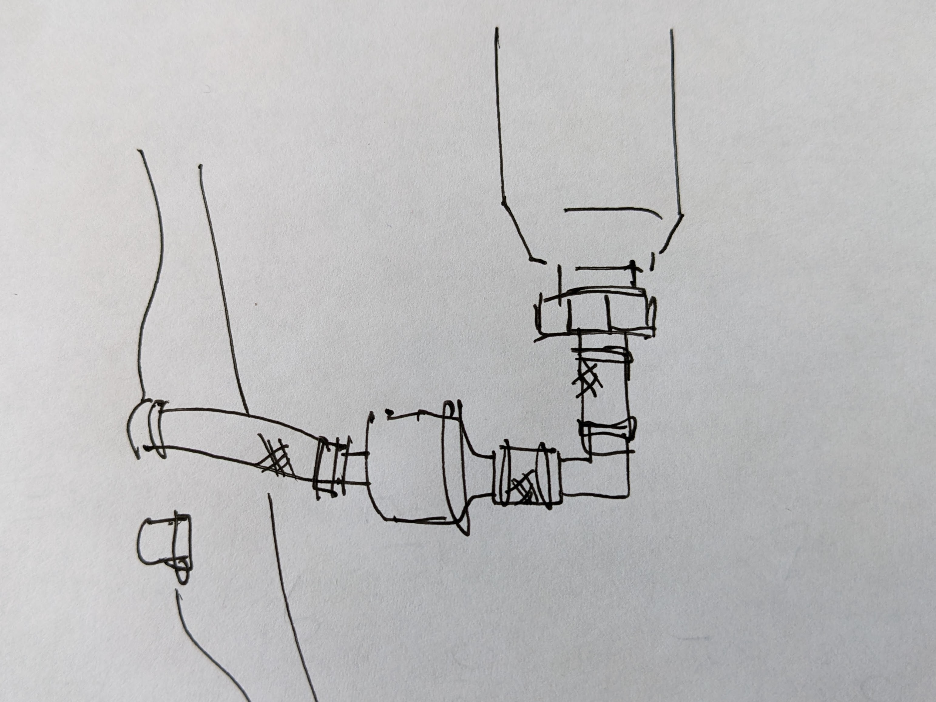

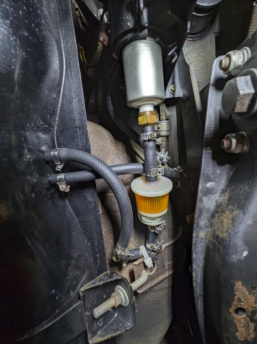

Can you simplify the input side? The feed is very convoluted. Have you had the same setup since the first pump you installed?
Perhaps the elbow right off the pump, so the filter is more inline with the tank outlet. I dunno. Looks problematic to me.
@HusseinHolland Thanks. I am going to either try to find a 3/8 u-shaped fuel hose for this or will use a U-shaped 3/8" aluminum joint (I have a brake line terminating kit). I do have a fuel pressure gauge inside and monitor my fuel pressure. Usually it is around 30-36 psi (idle, full throttle).
