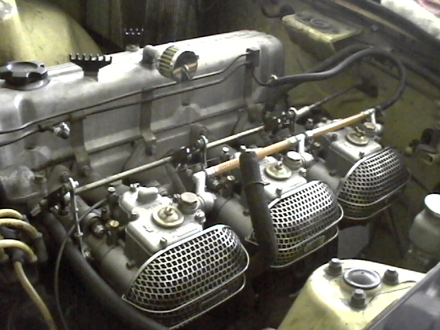

Hi. I'm installing a triple weber set in my 240z. With the new intake manifold there's no place for a pcv fitting. So now i have a hose, coming from the block that suppose to hook up to the pcv, hanging around. Is it ok to leave this hose hanging? If i have to hook it up to a pcv, how would i go about doing so? There's no pcv fitting on the new intake. dunno what to do.

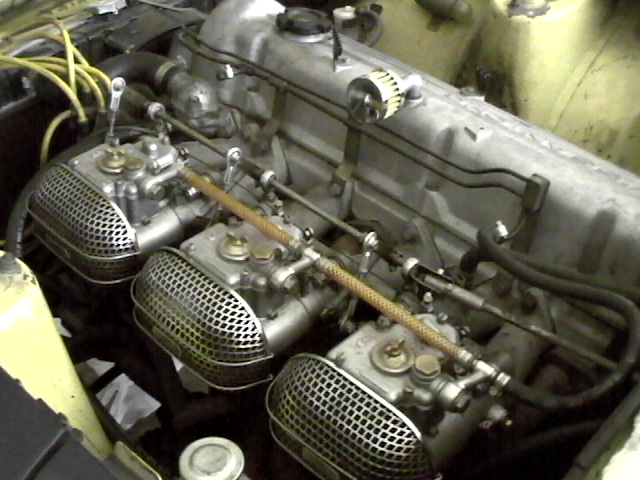

yeah i got a filter for the breather. I'm just wondering what should i do with the hose the goes to the pcv valve from the engine. I've attached a pix of the setup. The hose that's sticking up between the weber is the hose i'm talking about. It goes to the pcv. But my manifold for the weber doesn't have a fitting for a pcv valve. Can i just leave it hanging or plug it somewhere? I've attached a picture of my set up. I would like to here your thought about it. Can't wait till it hits the street:D -Kevin
