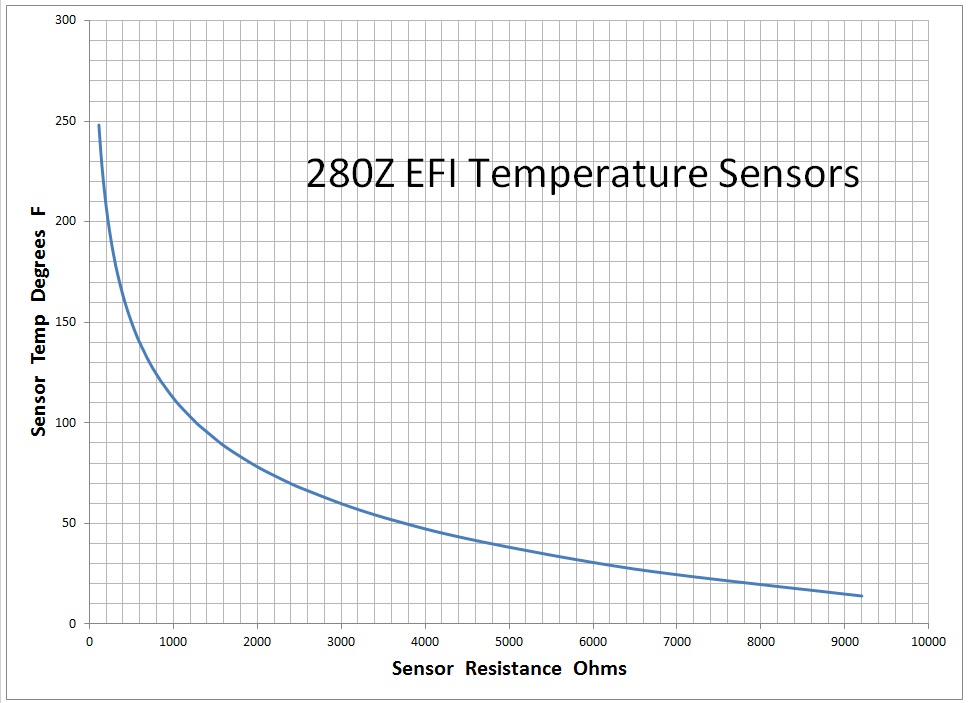

Compare the resistance measurement result to this.

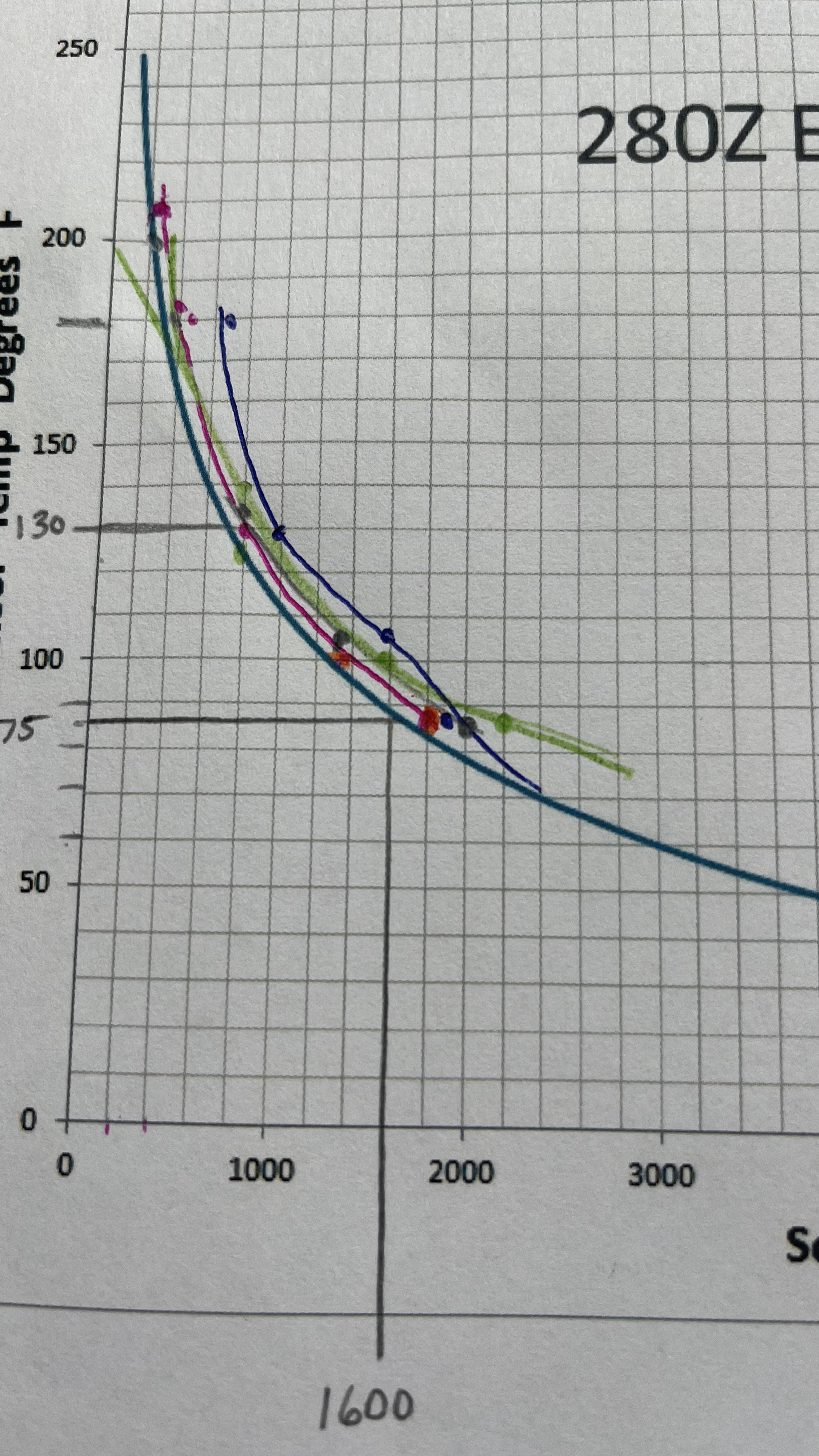

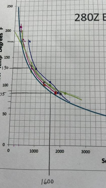

Thanks for the chart Bruce.   I printed it out and plotted the 4 sensors I had including the one I pulled from the head.
The one that came off the car had the worst/richest curve of all of them.

Job is not complete and ran out of time. Here is the temp sensors graph I made putting them in hot water on the stove.
Blue was the one installed on the car.

Here is Nissan's documentation from the 1980 EFI book.  Since you're mostly looking at a warm engine, the resistance at 180 is probably the most relevant.  I'd guess that their spec is 250 to 275 ohms, by eye (edit - probably more like 300 to 350 on the high end since the line is 500.  Of course, they are just lines on a piece of paper [pixels on a video screen]).  Seems to match what CO's plot shows.
Yours all seem rich.  Did you measure at the sensor pins or at the ECU?  Might have resistance at your bullet connectors in the sub-harness oe at the EV1 connector itself.

I read more of your details and see that you have 180 marked.  How did you get the water temperature set?  Must have taken some time.  Could be some error there.

Zed, thanks for the FSM ref. I put all the sensors in a pan of hot water with a thermometer in the water and heated the water to various temps on my stove (wife was at work [emoji6]). I will say the sensors react very rapidly to cooling.
I wanted to get a baseline of the sensors before I put them in the car.
