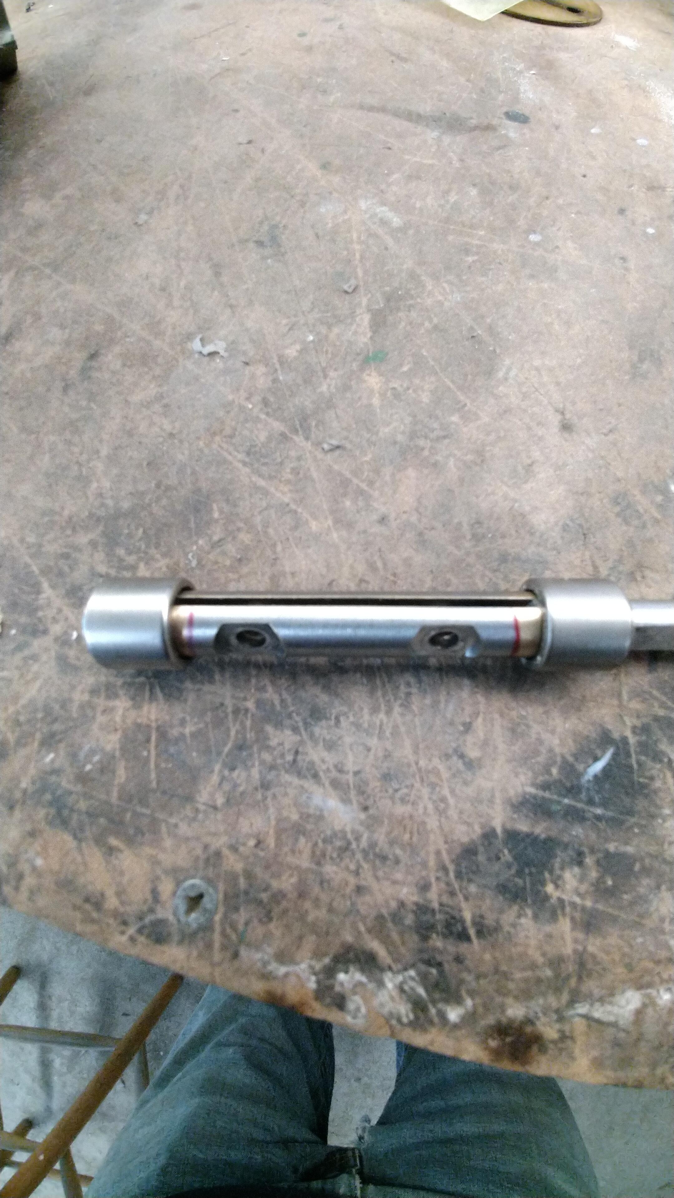

I'm no carb expert, but on the ones I've messed with the wear appeared to be on the shaft. the chrome plating had been worn through, and once that happens, it exposes the (even softer) brass underneath, and things spiral quickly from there.
billgtp posted a pic of one of his shafts, and it might be a trick of the camera, but I think I can see the brass color peeking out at both ends. Between the bearings and the marker lines?
As for availability of new, I have no idea. Certainly any well tooled machine shop could make them, but at what cost?
  • Agree 1
So as @Captain Obvious says, when I took apart thee  set of worn carbs that I’m modifying (eventually!!) I found that worn “collar” was 9.5mm and the wear on the bush was about 0.4mm.
The wear on both ends was 180° with 90° being the most worn but interestingly the wear was 90° offset rotational from one end to the other!

He did tell me if I want new shafts he will make them out of stainless steel. But it was me that said no. I would like to see what the carbs do with just the new bearings.
If I have a problem I will have him make shafts. He is not charging me a thing for doing this.
  • Wow 1
Hardened and polished throttle shafts paired with bearings would be best. Those bearings are designed to run against a pretty high quality surface finish.
For example, the versions offered by McMaster recommend a surface finish of Ra = 8 microinches
Where...  Ra surface.jpg  :geek:
That said... Even without hardening, new stainless shafts with a good polished finish will be worlds better than worn soft brass.
  • Confused 1
