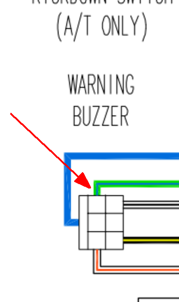

You could install one without too much trouble. Just intercept the fuel pump wire here.
That connector is on the driver's side under the dash. The green/blue is the fuel pump positive.
Here are the parts I suggest:
  1. 14 gauge wire (green would be good.
  2. 2 of these connectors: http://www.vintageconnections.com/Products/Detail/78 You only need 1, but you may need an extra male terminal.
  3. A switch. I would go with a 20A switch like this: https://www.amazon.com/dp/B0BGX6Z3Y1
Back the terminal for the green/blue out of the 6 pin connector with a small jeweler's screwdriver. Put that terminal in one of the connectors you bought.
Assemble the switch in this order: female connector - wire - switch - wire - male terminal into the 6 pin connector where the green/blue wire was.
When the switch is on, the fuel pump has power. When the switch is off, you killed fuel pump power.

Your 77 should already have one in the AFM.  When air flow stops the fuel pump power is cut off.  Your fuel pump should not be running when you turn the key on.  Only at Start and when the engine is running.

@Yarb For your project, I would advise doing it differently. You'll want a different connector and an inertia switch, too. I'll send you a PM when I get home and can get all of the part numbers/sources.
