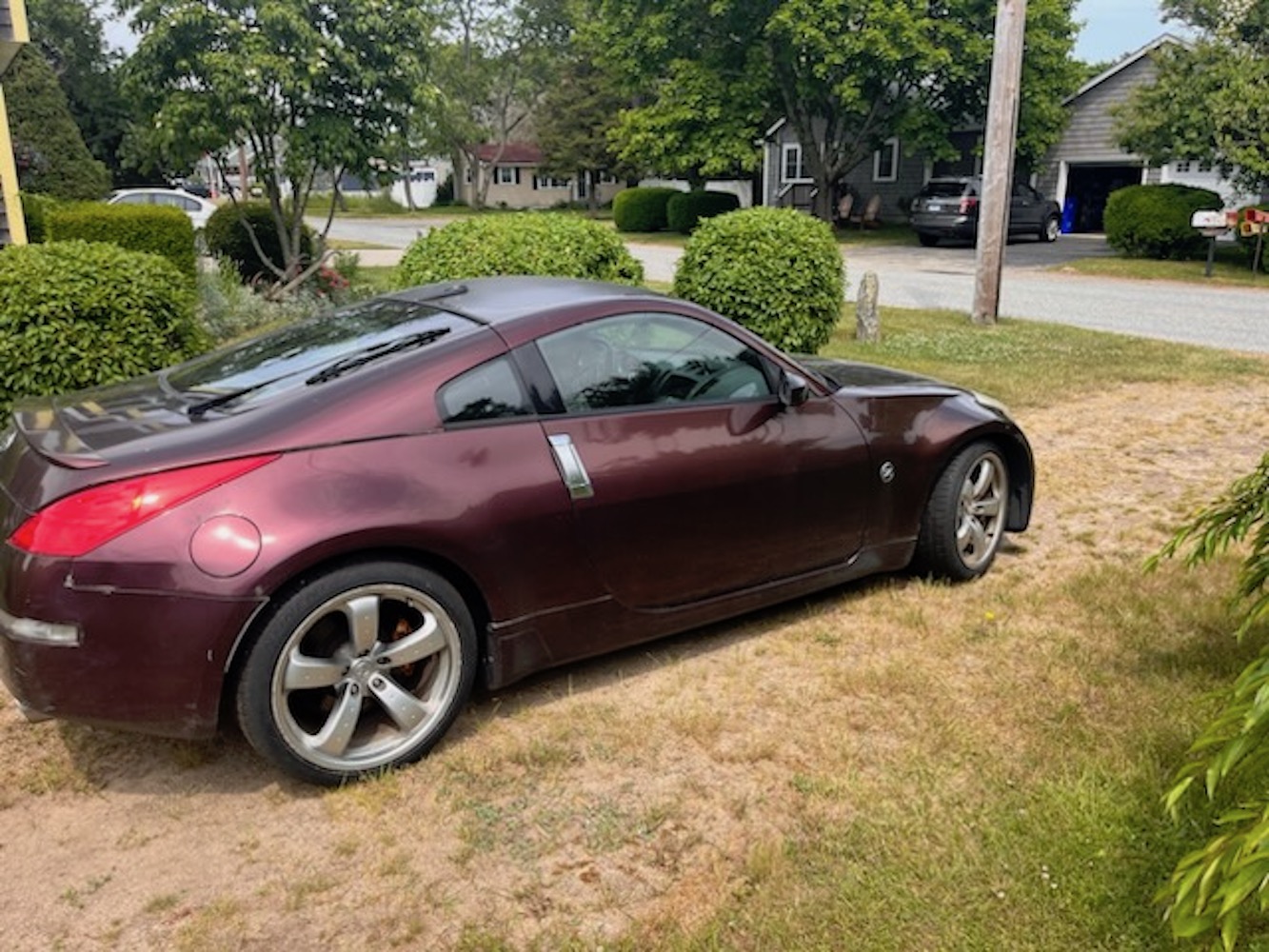

A neighbor who is also an old car buff stopped by about a month ago, he told me his wife's uncle had an '06 350Z that wouldn't pass inspection in RI ( I had told him earlier that I was considering a drivetrain conversion at some point in the future). The car is mechanically sound, so having the entire vehicle for the cost of an used engine & CD009 trans of unknown pedigree made sense to me. My personal experience with buying JDM drivetrains has not been pleasant.

Just now, Zed Head said:
What failed?  The top looks in good shape.
Apparently the rear subframe attachment points are rusted to the extent that they would not expect it to last 2 years - which is the duration of the RI safety inspection.
