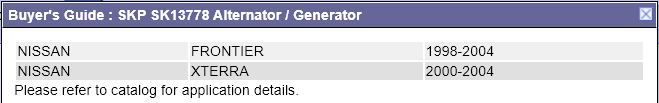

I haven't had any issues with the Frontier alternator I bought from Rockauto. https://www.rockauto.com/en/moreinfo.php?pk=8829284&cc=1359200&pt=2412
Rockauto has several other brands listed as new (not reman). You also have to buy a plug like this to integrate it into the wiring. https://www.amazon.com/gp/product/B07ZMN2B59
Attach that plug to a 2 pin connector from Vintage Connections (http://www.vintageconnections.com/Products/Detail/79), and you can plug the new alternator into your car.
Last, but not least, you'll need to replace the ring on the alternator charge wire with one that can go on the M8 post on the alternator.

I'd probably go to a salvage yard and look for a Frontier or Xterra.  Just for fun.
  • Agree 1
It has to be a 4 cylinder Frontier or Xterra to have the correct pulley.
11 hours ago, chaseincats said:
To use the frontier alternator you need to do the wiring mods you noted though, right?
Yes. For the 78 it's easier than for earlier S30s since your car is already set up for an internally regulated alternator.
