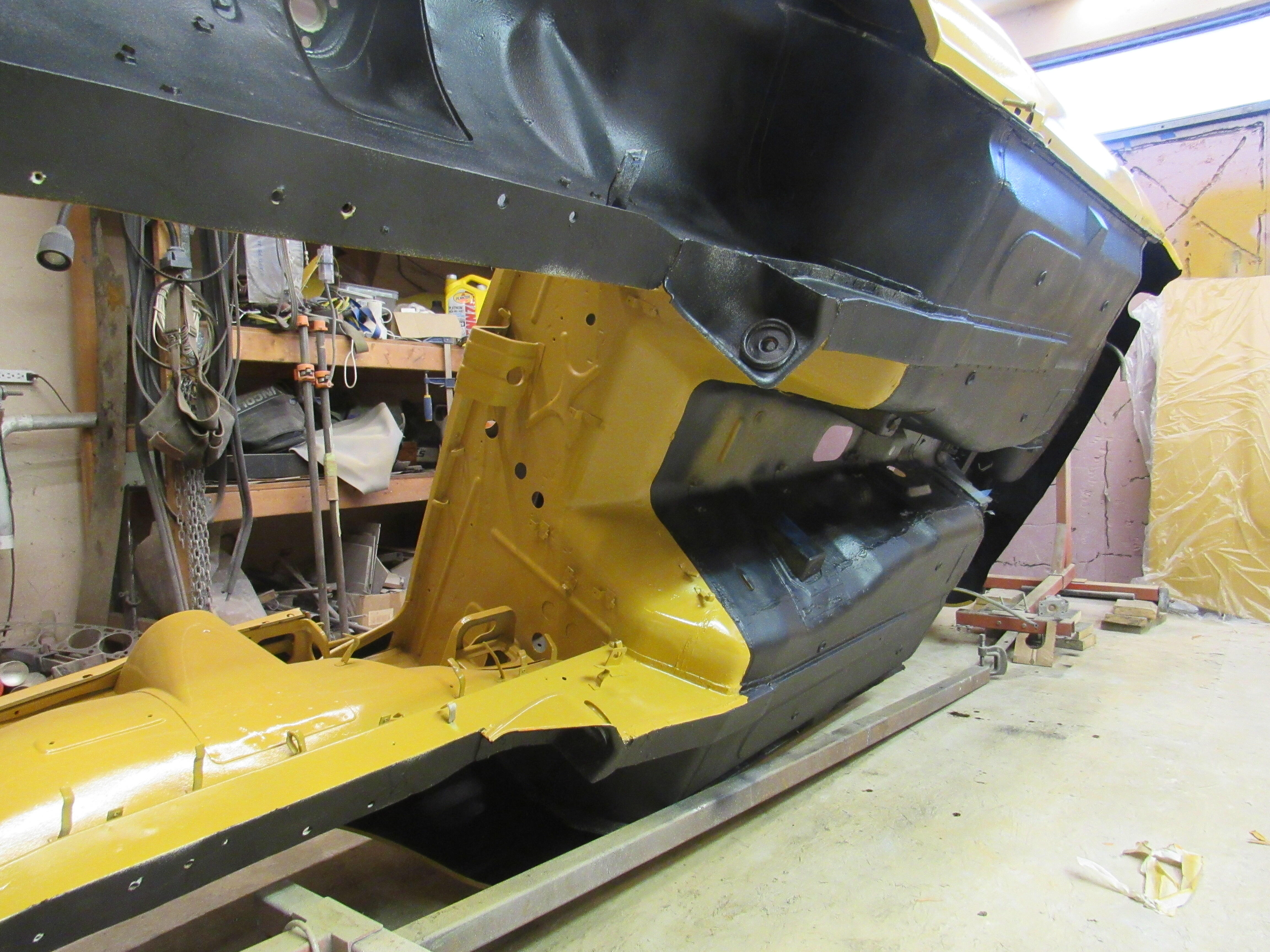

3 hours ago, Patcon said:
Will you leave the interior in primer or color it?

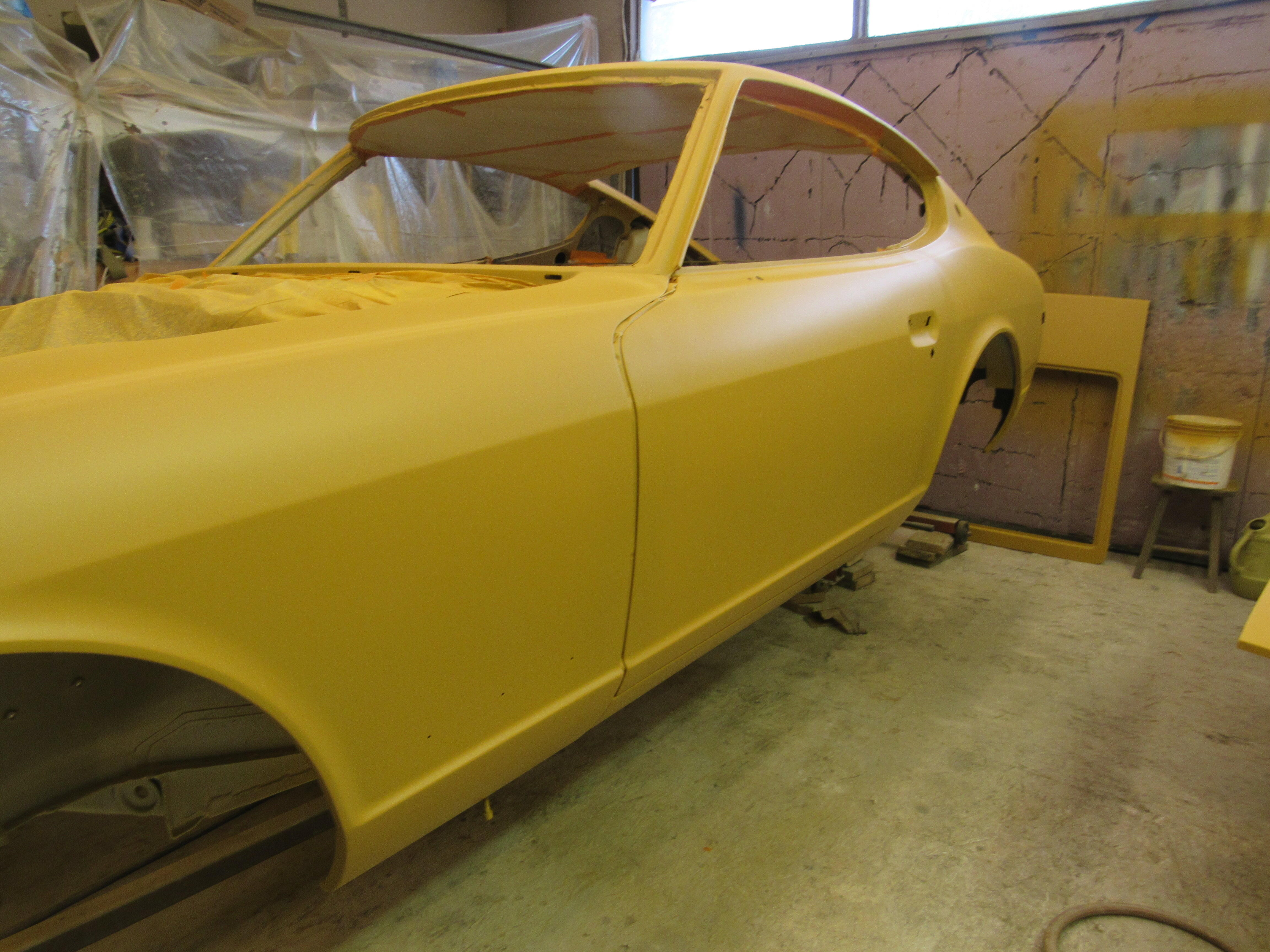

The interior is coated with epoxy primer so it's sealed, I'll clean it up and apply the tar mat right over top of that and the original insulation over that.  Yes, things are proceeding at a good pace, we are in a little warm spell at the moment for the next few days so it allows me to get the shop nice and warm, perfect for painting.

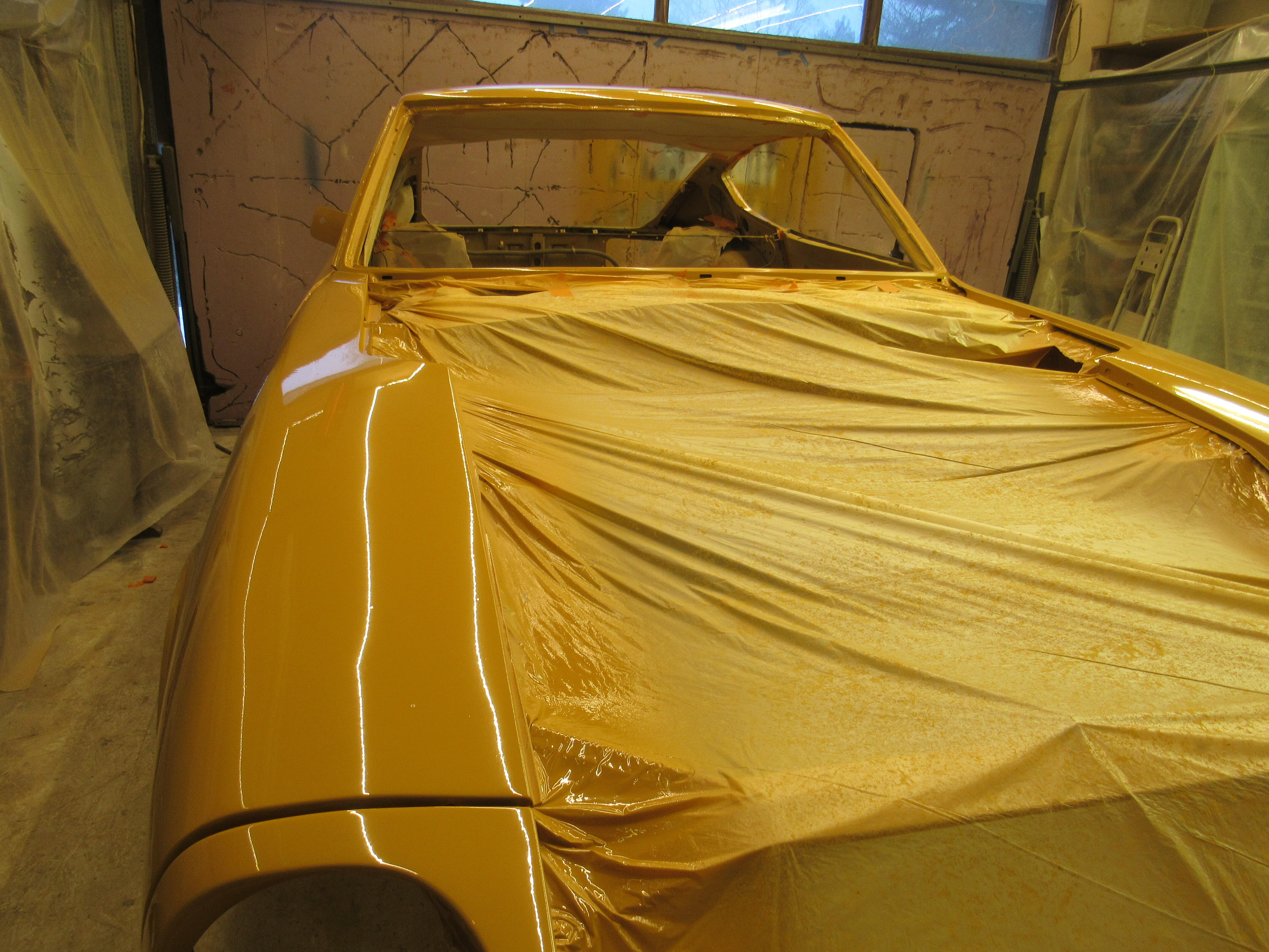

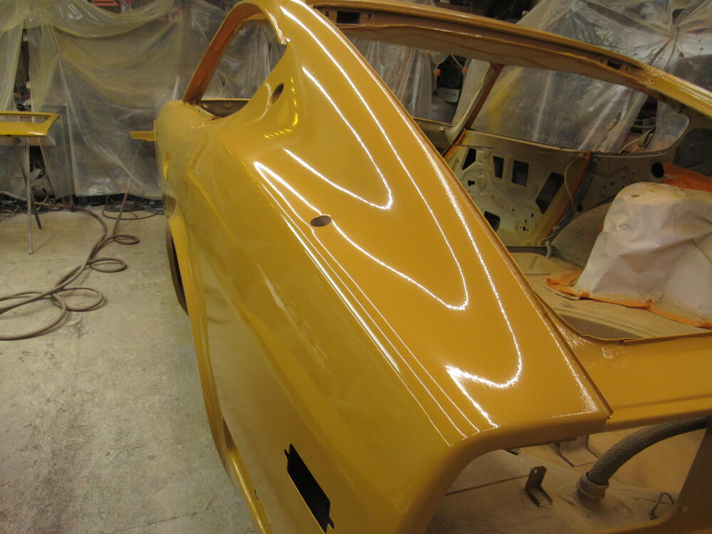

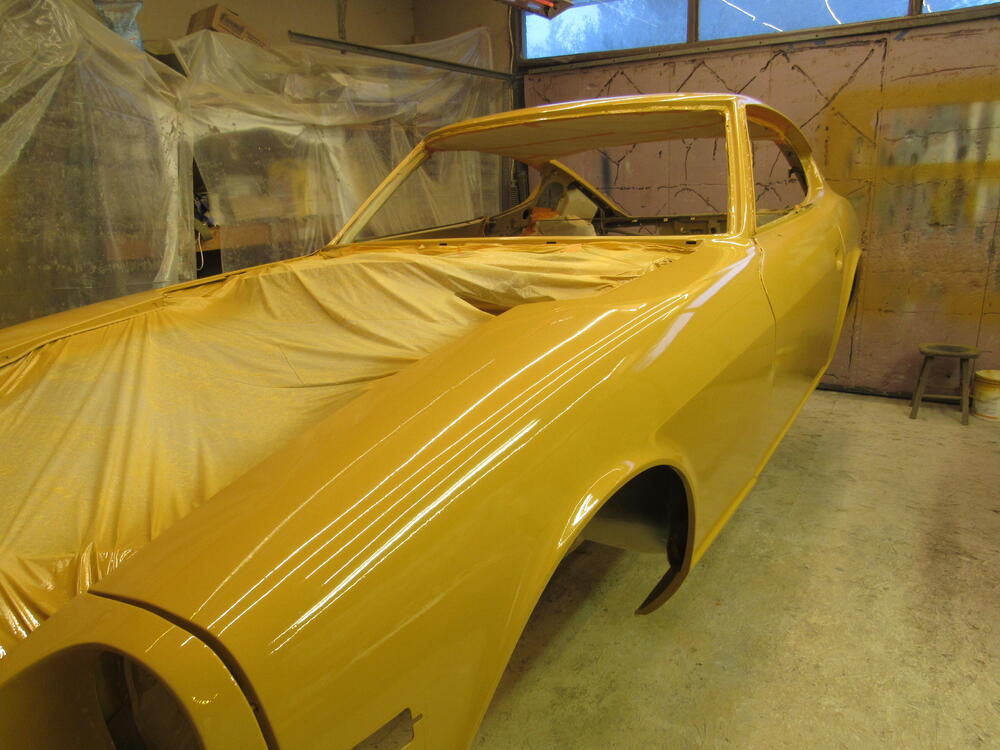

It's always hard to tell from photos displayed on monitors, but the colour looks great! It doesn't look as brown as the sample you gave me when I was there. How does it compare to the inside of the hatch lid now that it's on some car parts?

What do you do about overspray at the door edges to prevent blowing in on the door jamb?
I should have taken some pics, I tape off the door and fender panel right at the edge, after spraying paint/clear I then remove the tape.  There is always a little lip of clear coat at the edge of the tape, I wet sand that 1/16" lip with 600, then tape the painted door jamb leaving that 1/16th" exposed, paint the rest of the panels and remove all the tape.  Again, there is another lip of clear coat, this time I leave it until it is hard then with a nib file take most of it off and the rest of the blending happens with the various grits, 1200, 1500, 2000, during wet sanding and polishing.
It's a pain to be sure, but I find the final finish is better than spraying everything at the same time. The only time I did spray it all in one go I found a I ended up with drips and spots where I brushed up against the just sprayed surface.  It also allows you the get complete coverage around the hinges from both sides, the factory sprayed it all in one go and the coverage on the front of the hinges was spotty due to the front fender being in the way.

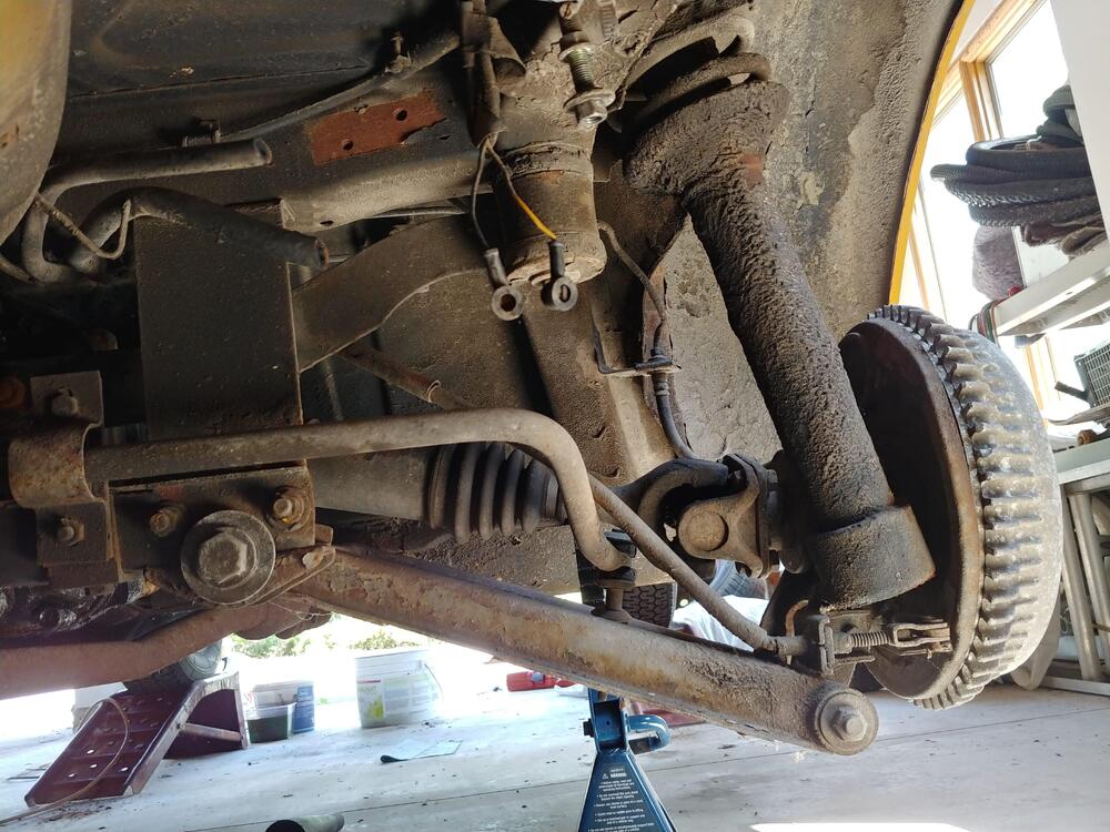

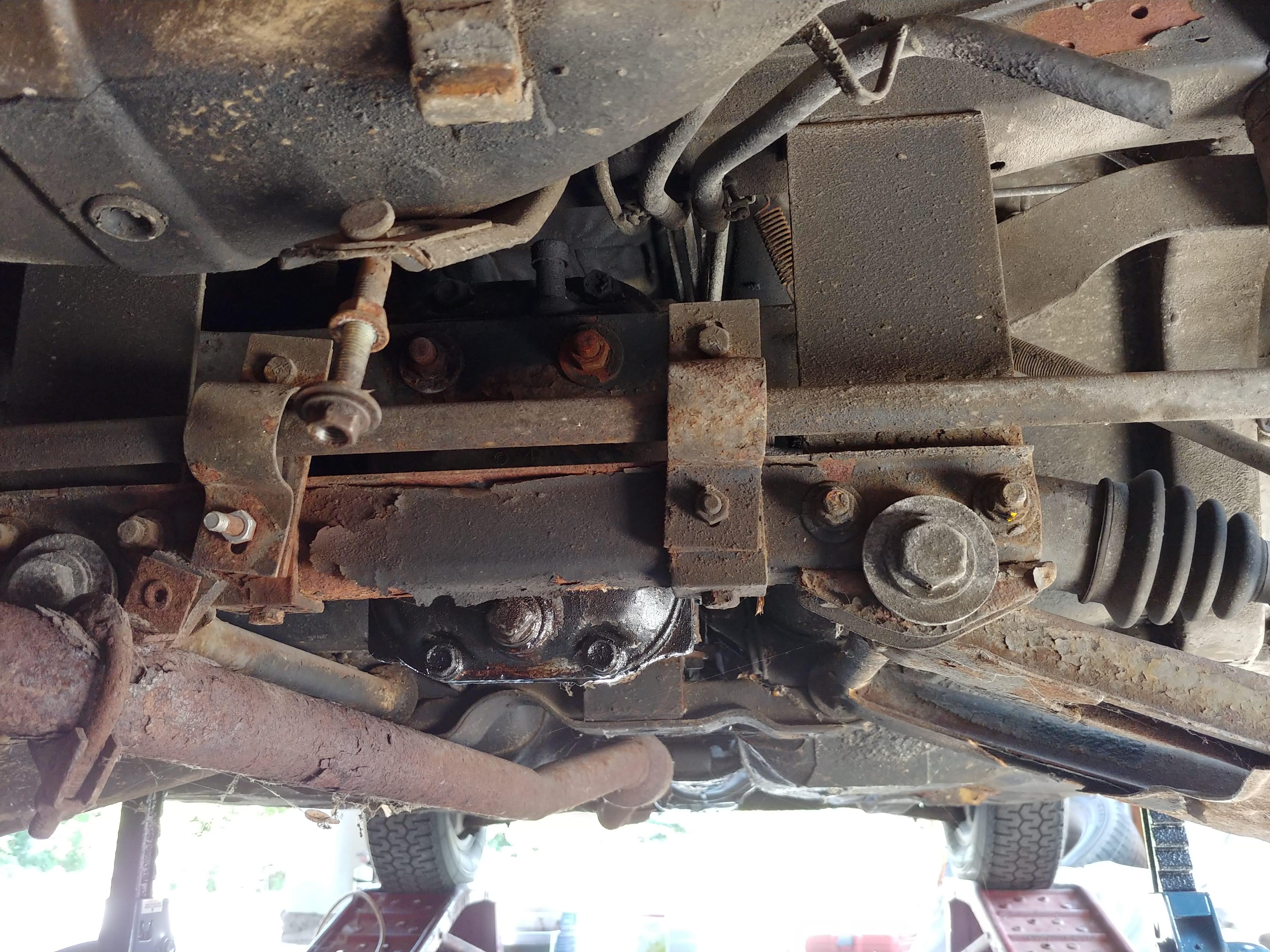

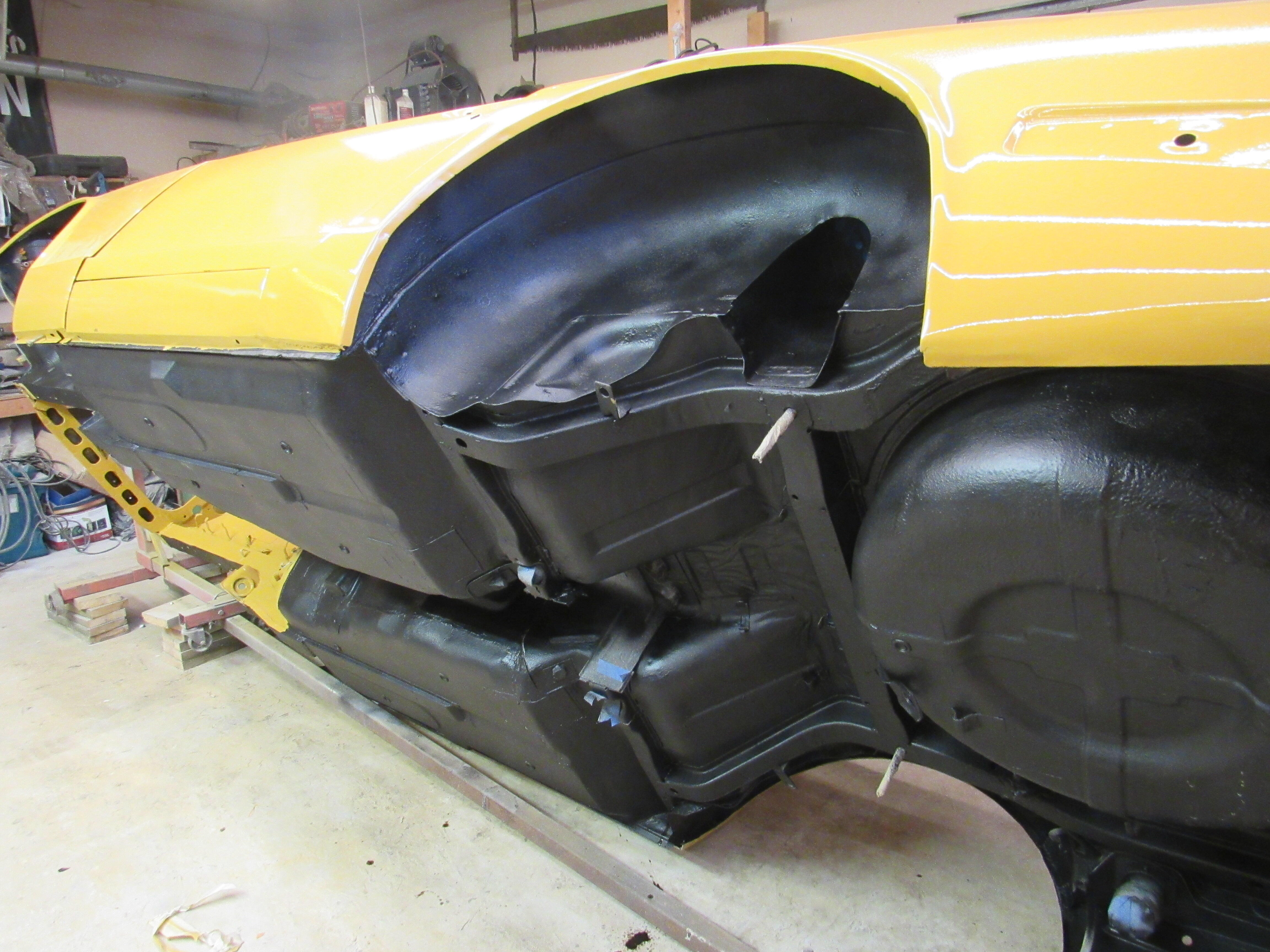

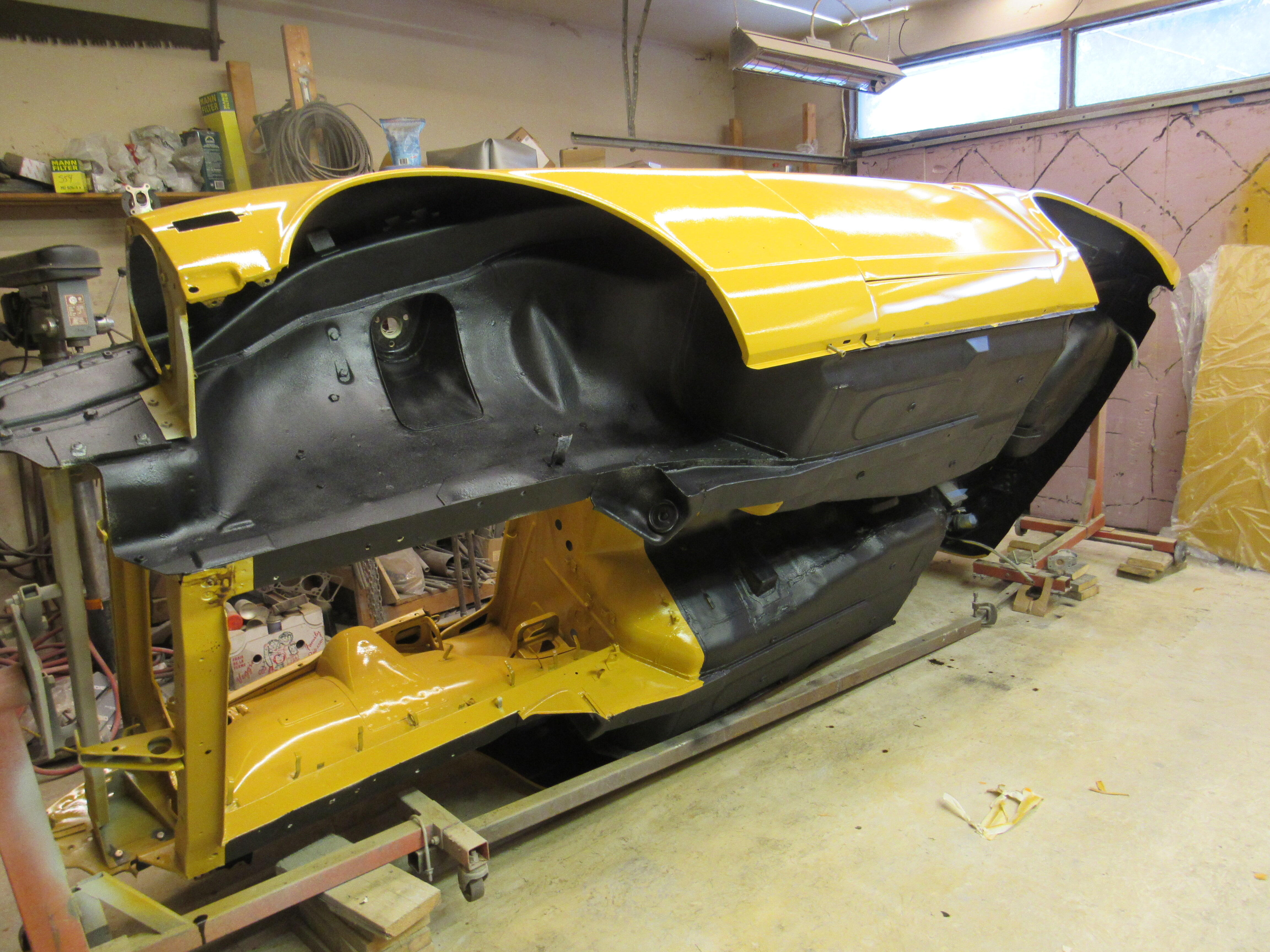

Not that anyone in this forum needs a reminder of how these things looked "in the wild", but here are a few shots of what the underside of the car looked like when I started poking at it in 2020.
Looking good. Thanks man!

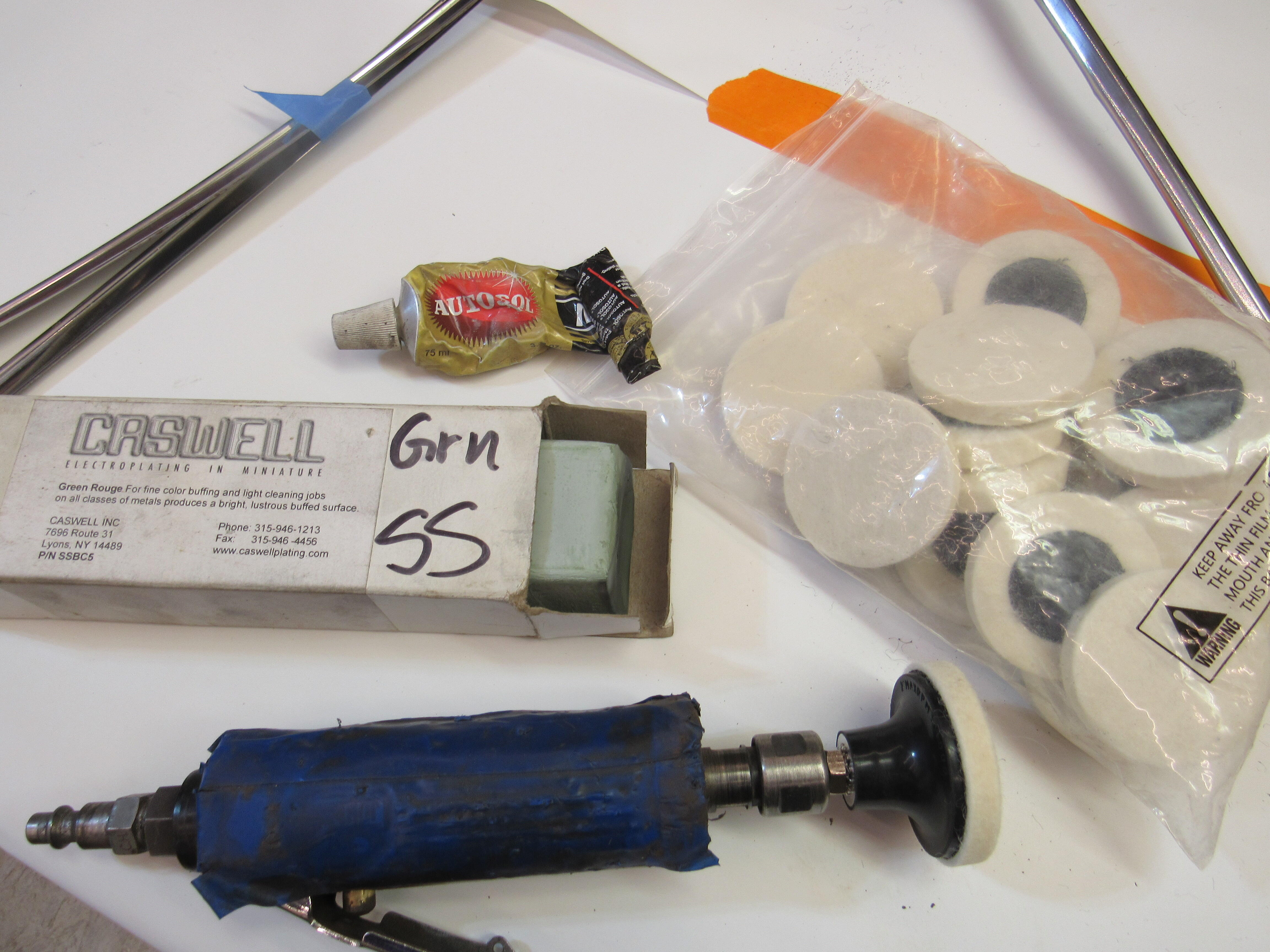

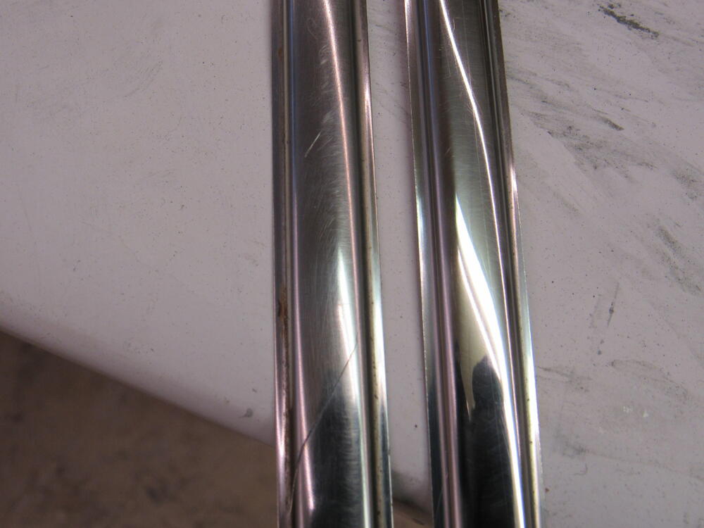

@grannyknot Thanks for including the tips on restoring the SS trim finish. I need to do that to my door frames, both existing & the later ones I will be converting to later on.
Edited by HusseinHolland
Thanks but the credit goes to Patcon.
