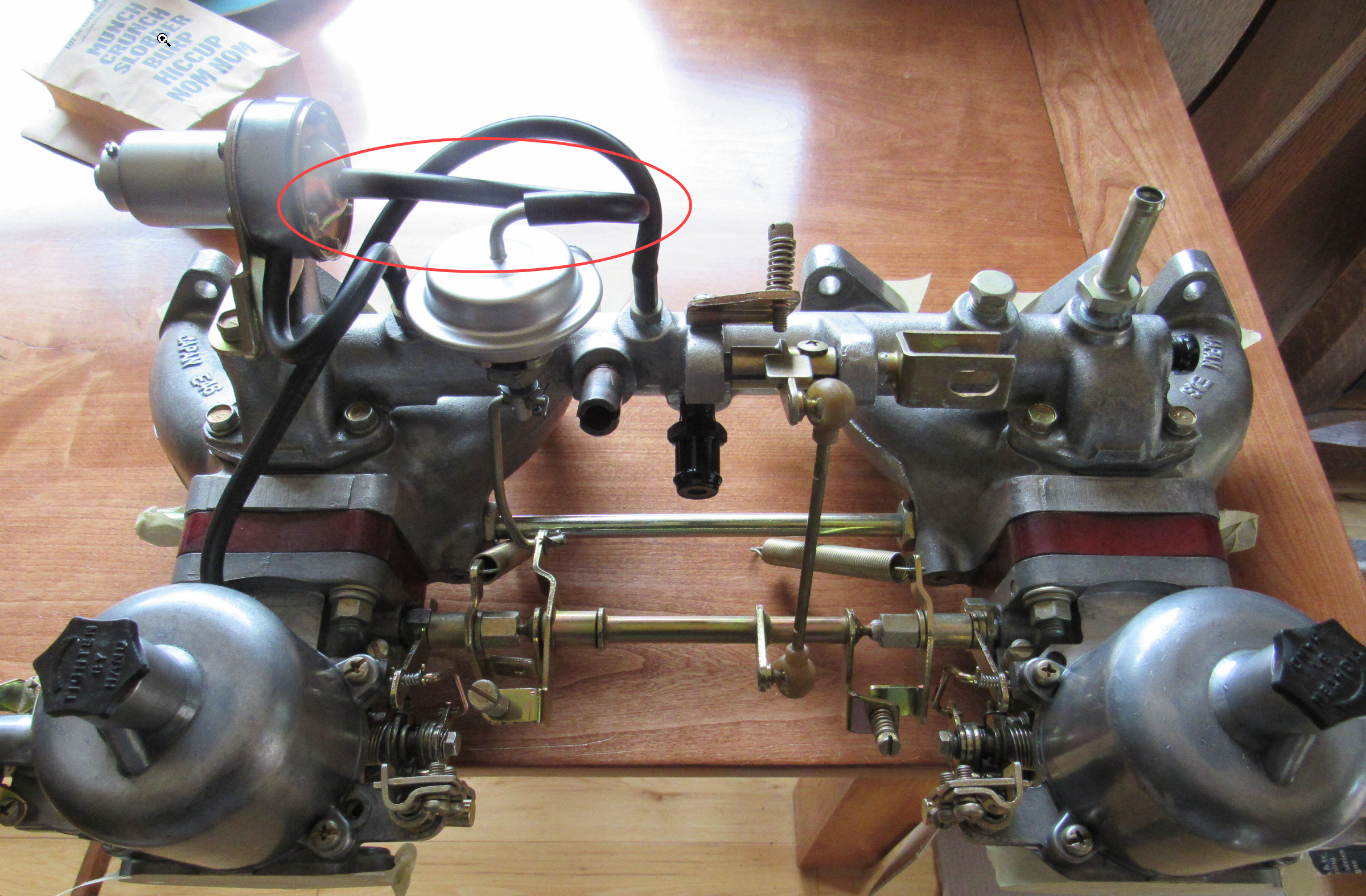

Did you have a close look at the hose I've circled in the picture? I believe it's a solid piece of rubber. I thought it was interesting that someone would actually have manufactured such a thing. I don't think any of the pollution control stuff was functional. The air pump had been removed and the air conditioner had been installed where it was normally mounted.
I wonder what valuable things the mice stored in the ventilation system, aside from the jute from under the carpets.
As far as the dash goes, I'm keen on preventing the cracks from getting longer. If holes at the ends of the cracks are effective, it's better than having them extend farther into the dash.
Hey man, I just work here.  If it's on the car I take it off and make it look shiny and put it back where it was, if you got a problem with the way the hoses are routed, you'll have to take it up with the owner.😉
Shiny is what it's all about! I'm not keen on that pollution control stuff getting in the way of my driving! It mostly looks like a bunch of vacuum leaks waiting to happen anyway!

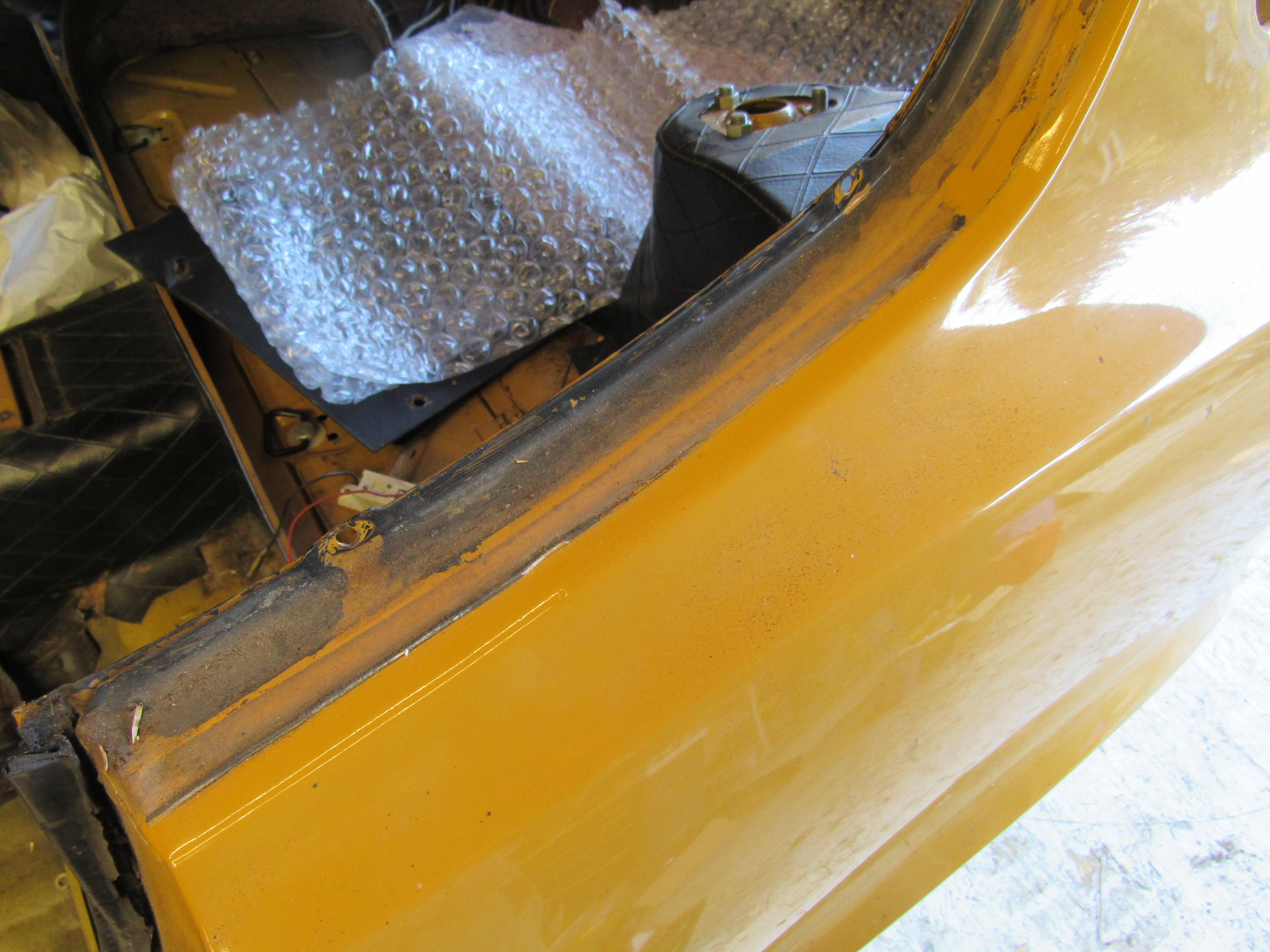

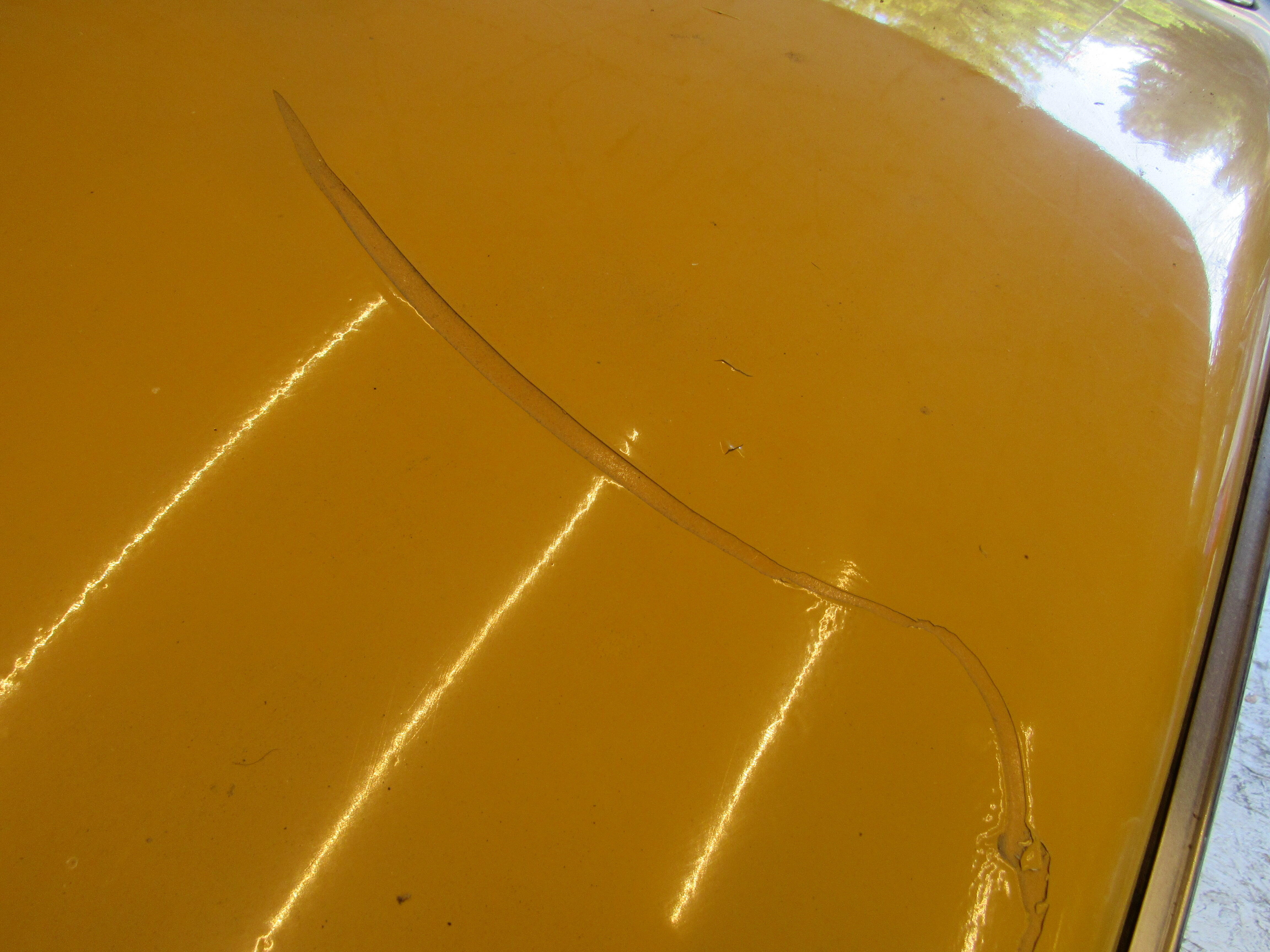

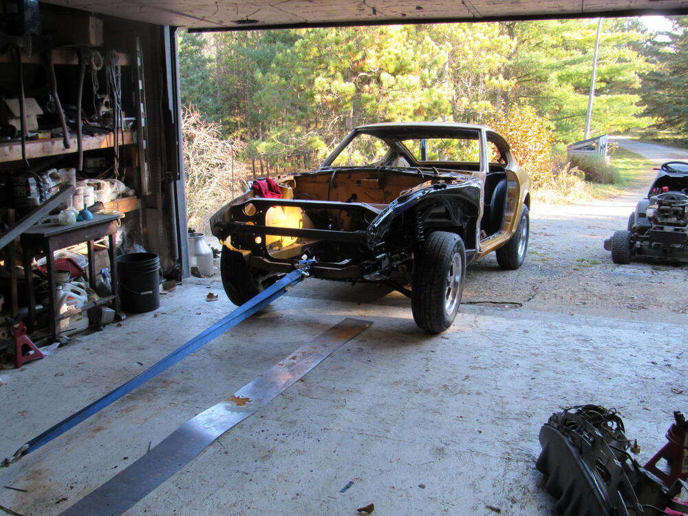

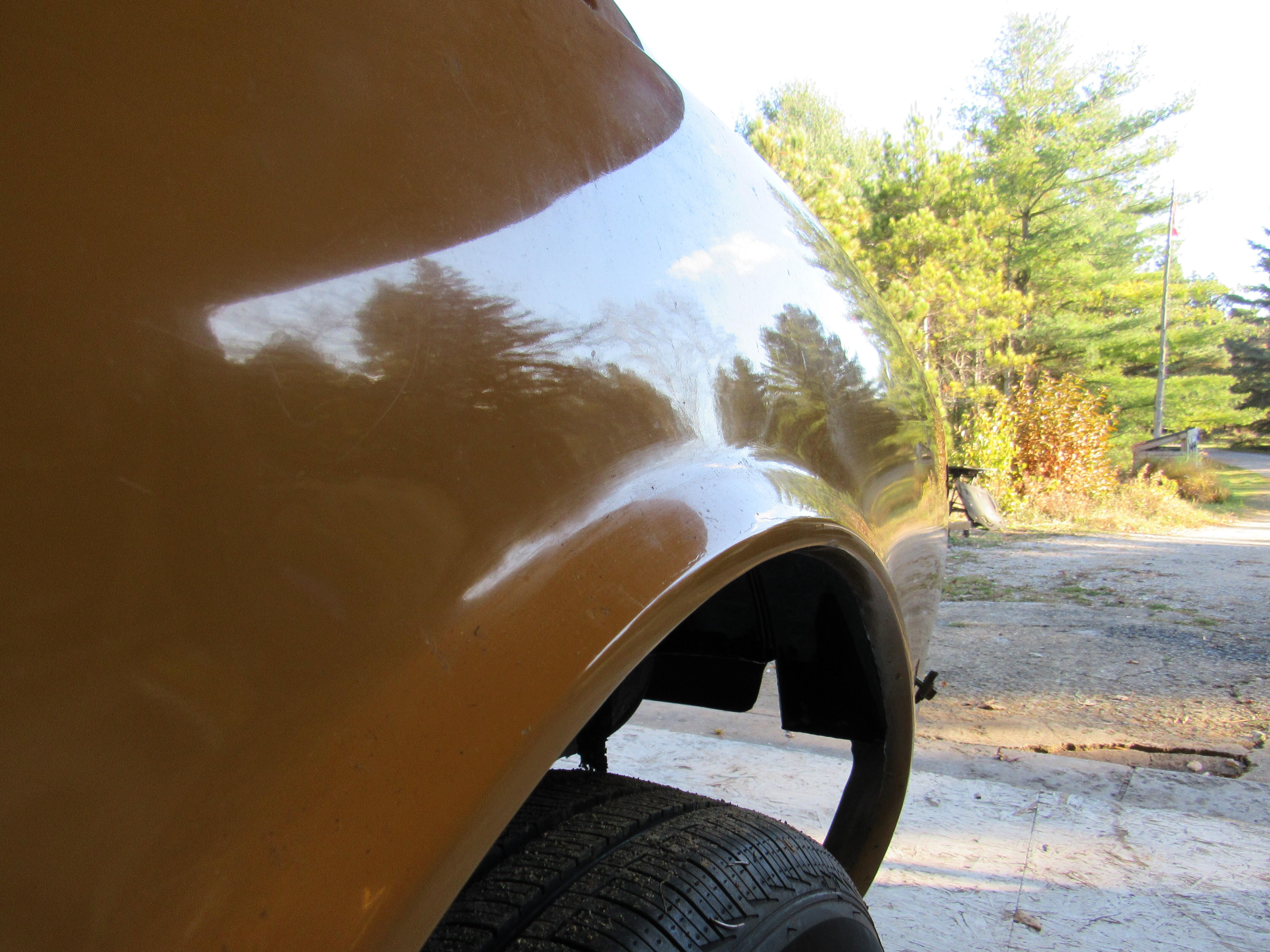

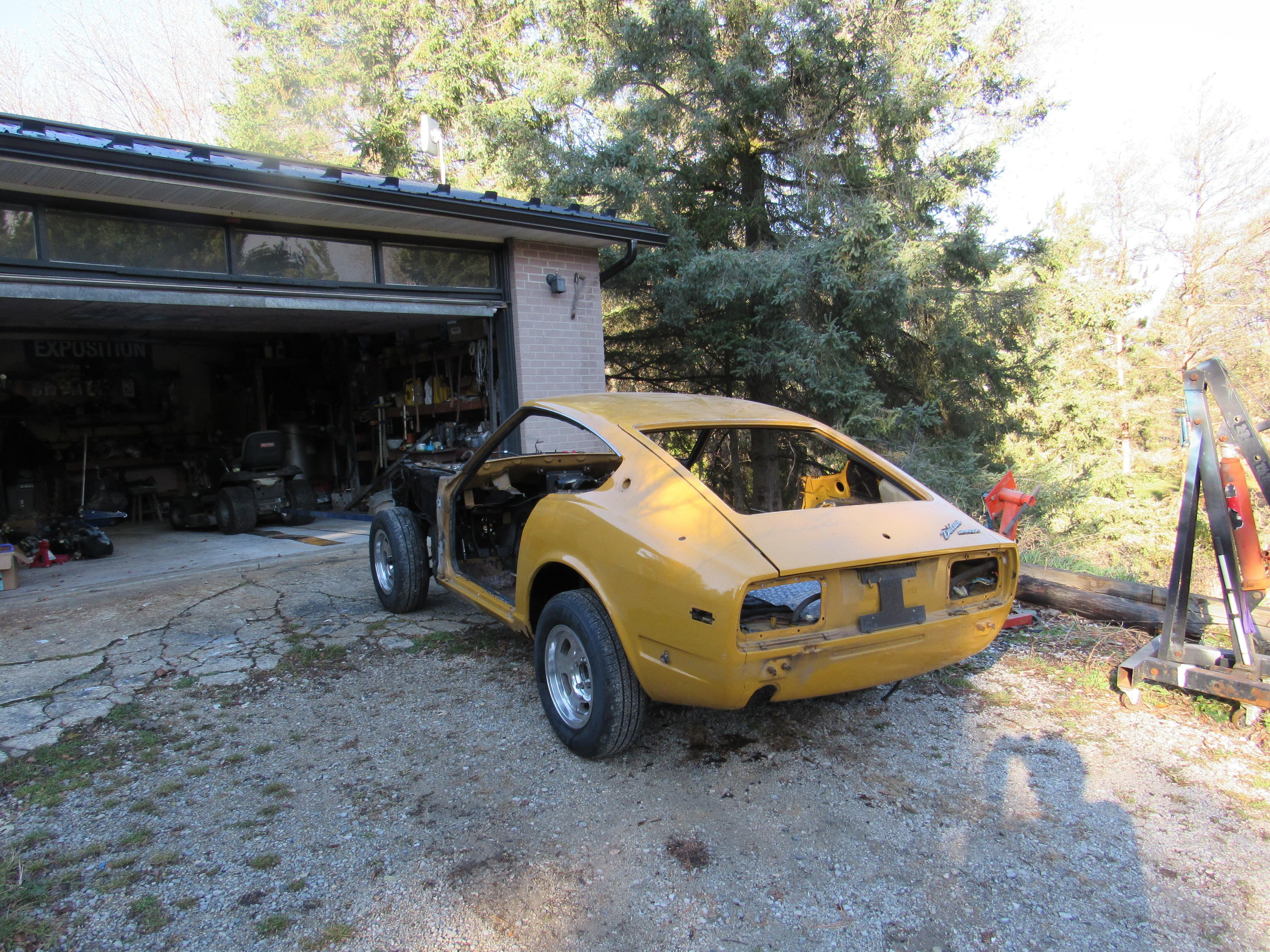

Well, I'm a month late getting her into the garage but will still have lots of time to get the work done and have her out on the road by the spring.  Now that I have some proper light I can get a better idea of what it's going to need.  Only 2 small dents and one 3" crease to deal with, looks like rear wheel arches have been replaced and the filler has eliminated the main body line, have to dig in there and repair that. Here is what can happen when you a get a quicky paint job. Shrinkage.

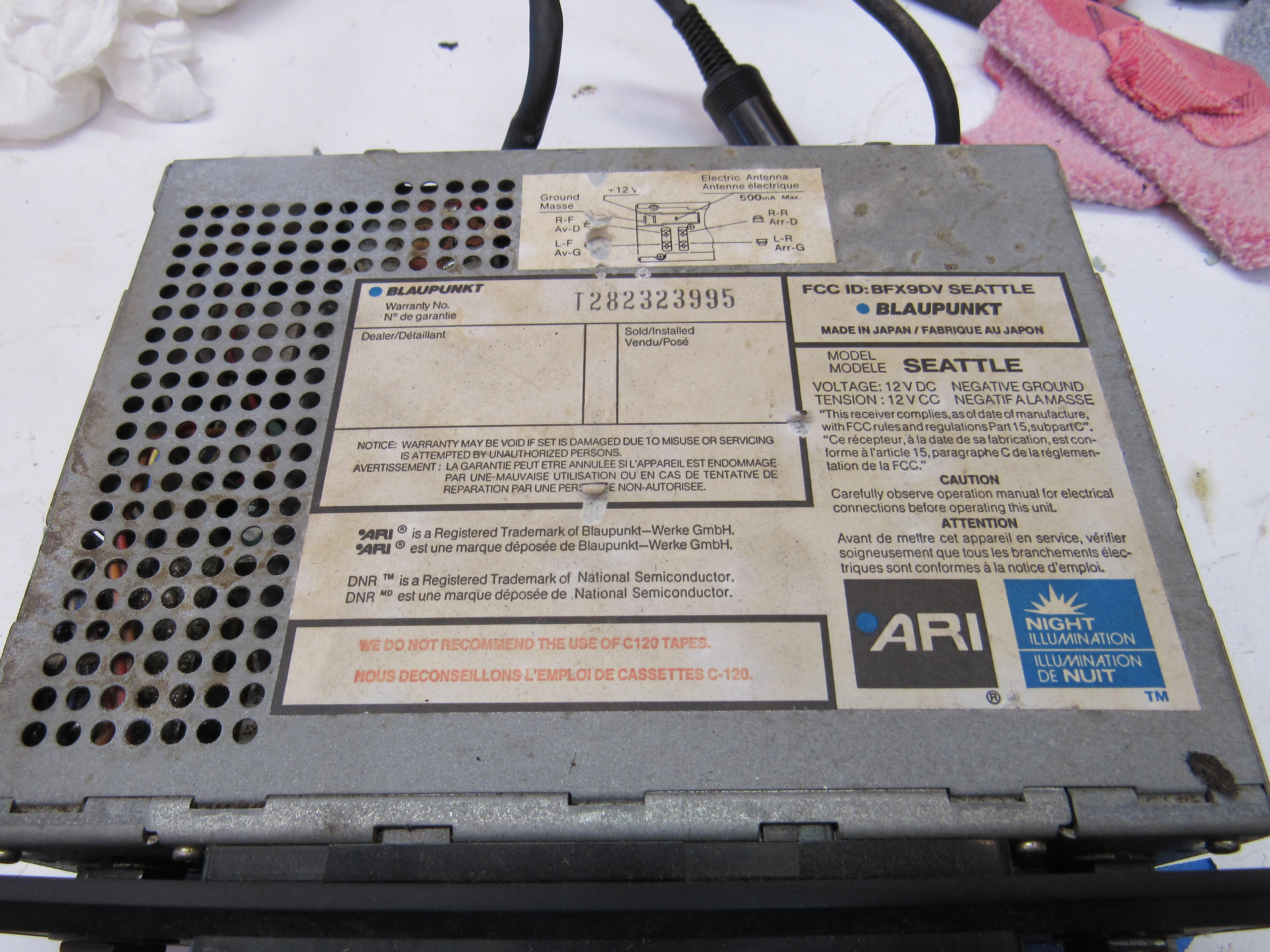

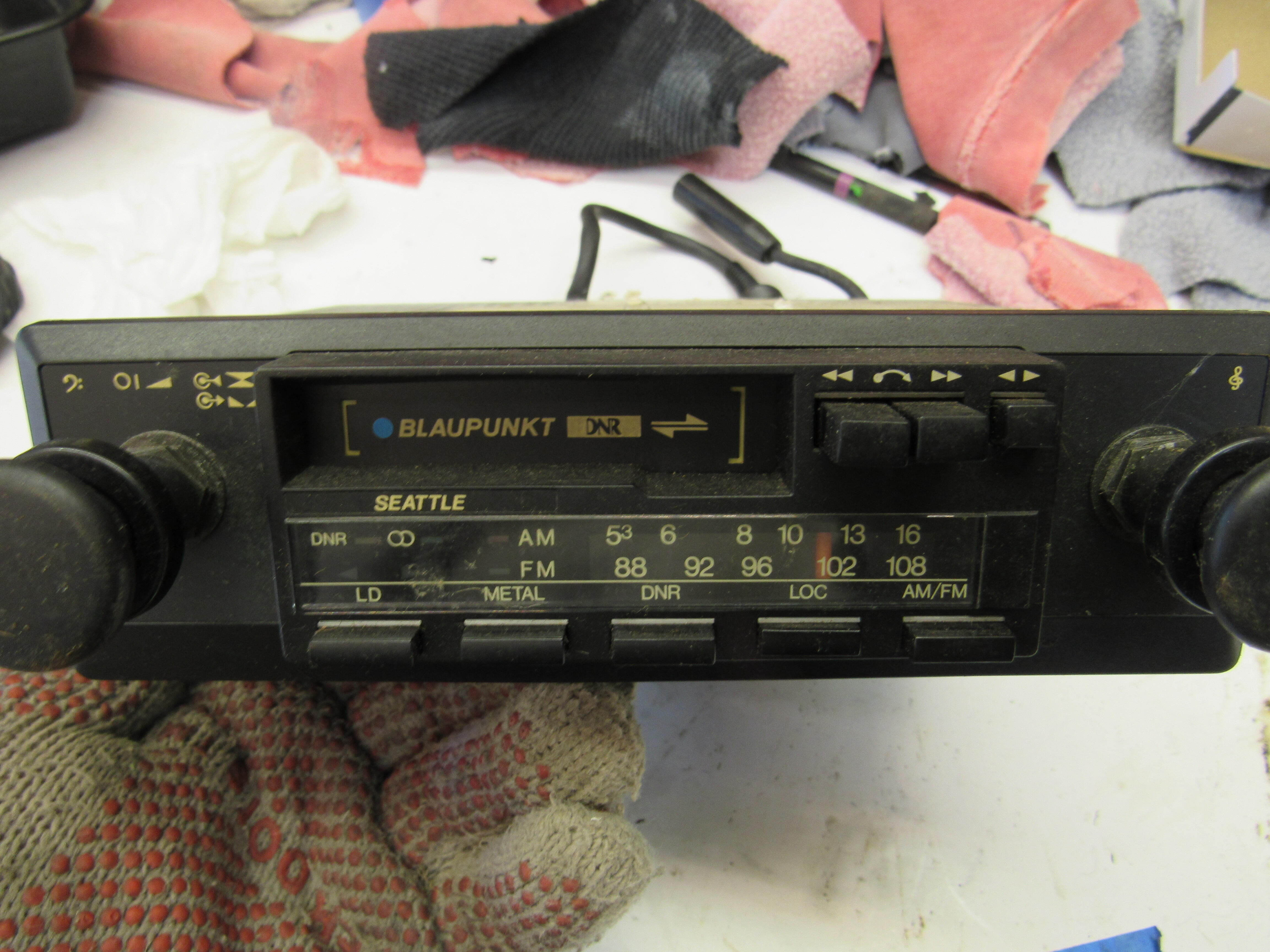

Took lots of pics of the original black paint that was used at the front grill and around the doors, I've never noticed that the black paint extended up into the quarter windows before.  Firewall insulation in near perfect cond. A Blaupunkt BFX9DV Seattle Cassette deck, that is definitely going back in.

That would be great, but it isn't a priority. I agree it would look better without it, but I don't think any of it is doing any harm.
I thought the passenger rear wheel well looked original - thought it still had the weld marks, where the driver's side doesn't. The paint job was pretty terrible. I suspect it was done just before the car was sold. Looks like the radio/tape deck is late '70s/early '80s vintage, so it probably came with the car (I didn't get the car until 1994). I did install a set of rear speakers in a piece of wood that ran across the back of the hatch. Sadly, I also hacked out the piece of plastic at the bottom of the slot in the console so it would fit better. I remember regretting it even as I was doing it! At one time I had the original radio (and some gauges) from either the '72 or '73 that I owned back in the '80s, but somewhere along the line I got rid of them. Too bad. The good news is that I still have a few old cassette tapes hanging around!

I bought one of those 'legendary' Blaupunkt AM/FM cassette players for my Z back in the day ( ~ 1980).  It was a top-end unit costing $$$ (c/o Kromer Radio in downtown Toronto).  It worked like a champ for about 1 year (just out of warranty, of course), at which time a small, unreplaceable plastic drive gear split at the root of one of the teeth, leaving the tape drive useless.  I was not amused.
Unless Chris has hooked this one up, I can't honestly claim that this one is still working, either! I was playing tapes in it in the late '90s, but it's been sitting in the garage for a lot of years since then. It's possible that the mice stashed some of its important parts in the ventilation ducts.
I haven't powered it up yet, no speakers, blew out the dust and it looks pretty good.

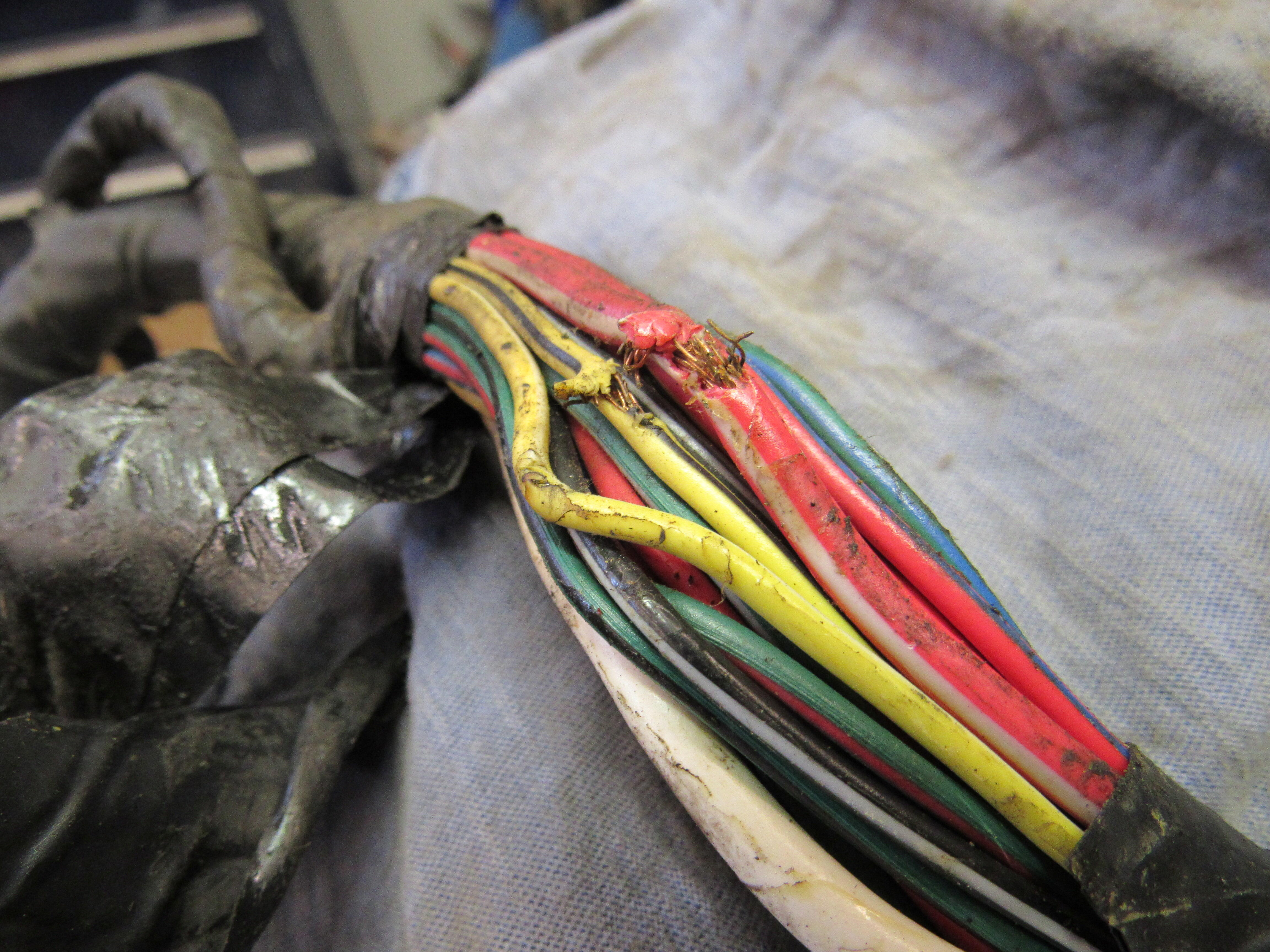

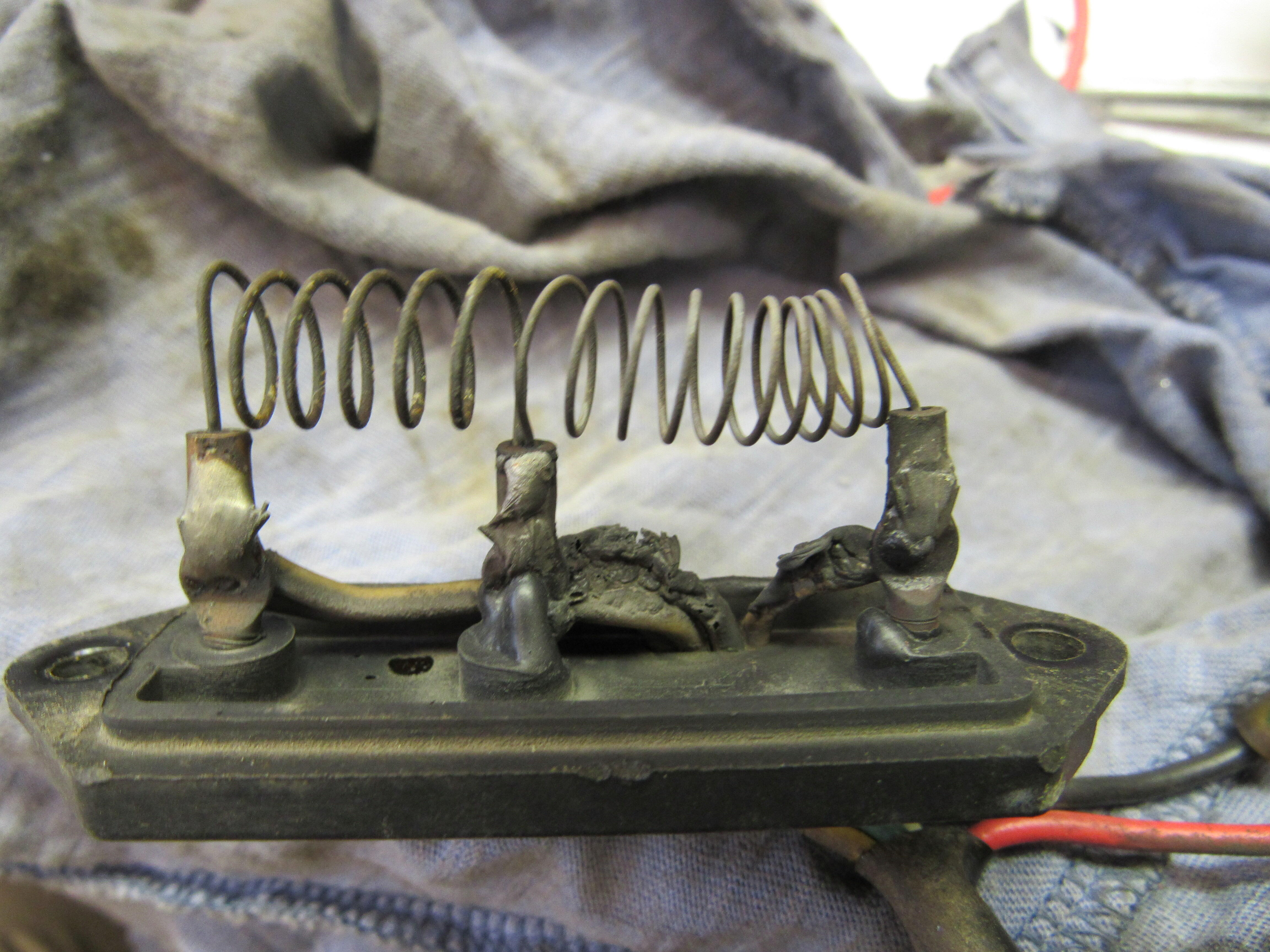

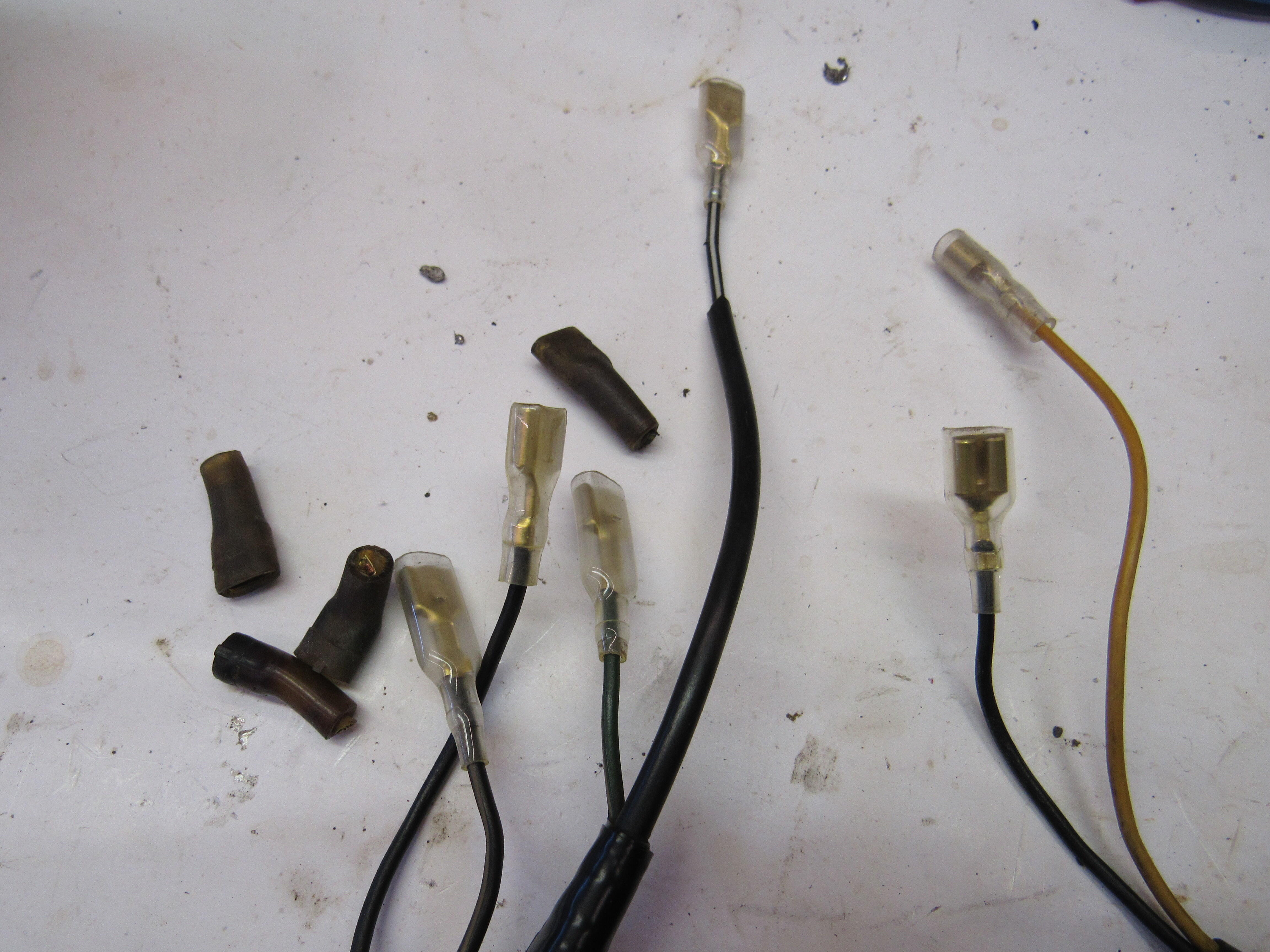

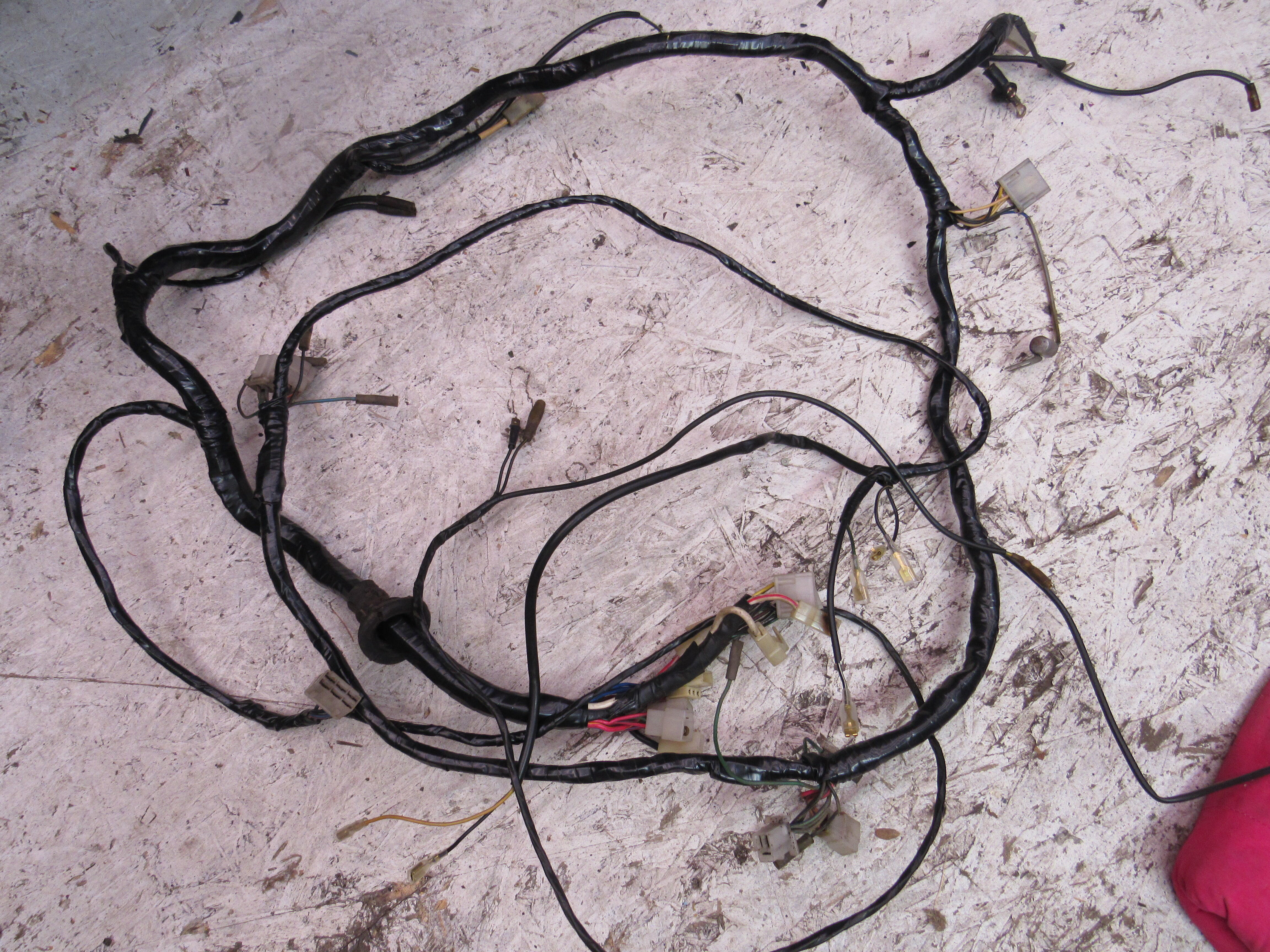

Tore down the heater and blower box, no surprises, filled the heater core with CLR and let it sit over night then back flushed. One melting event but there is still continuity so just cleaned it up with a brass brush. Laid out the engine bay wiring harness and stripped all the tape off to check for melts and breaks, only found a couple, the 2 breaks are right where the harness goes through the firewall, someone pulled the firewall rubber grommet  off and let the wiring harness ride on the edge of sheet metal.

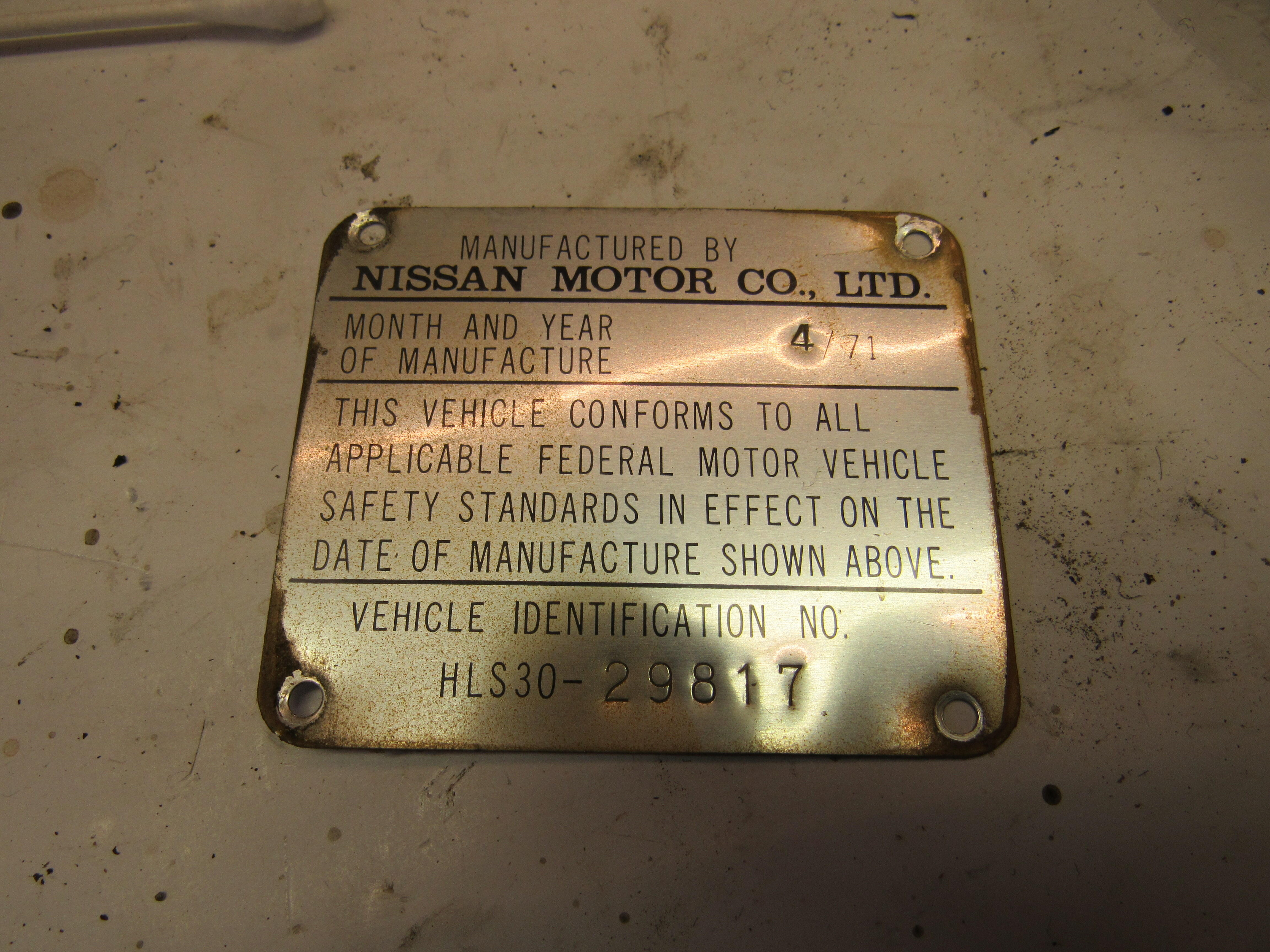

I drilled out the VIN door tag, to remove the respray paint from the edges I applied a tiny amount of Aircraft paint stripper with a Q tip and rubbed it with 0000 steel wool.
