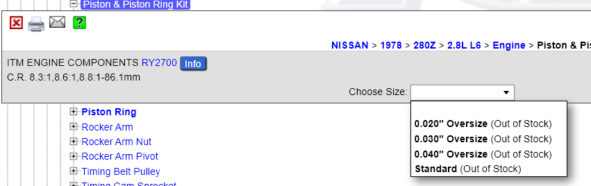

Similar conversations have happened over the last few years.  You better check parts availability before going too far.  Oversize pistons are not readily available.  You could end up with a freshly machined block but no parts to put in it.  Your engine will sit at a machine shop in out-of-stock parts jail, with a big bill waiting.
I see what looks like rust pitting in addition to scoring.  Looks like an expensive starting point.  Probably better off to find a different used engine.  They still pop up here and there.
https://www.rockauto.com/en/catalog/nissan,1978,280z,2.8l+l6,1209260,engine
Yeah I made sure pistons are which were my main concern are available. TopEndPerformance has 87mm forged pistons that can be made and rings are included. Main problem is forged pistons are overkill in my opinion and making the cost more than 1k. I went ahead and contacted three engines I see for sale, the blocks don't look promising though.
