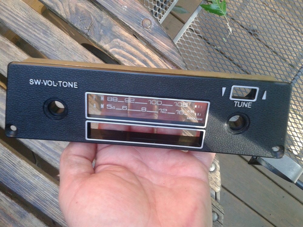

Doh! Sorry, I'm looking at that faceplate and it clearly says tune but I'm thinking it is the antenna toggle switch from the earliest faceplates for the series 1.
  • Agree 4
That hole above the word tune is the antenna up and down toggle on my early '72. From what I've seen the really early radios had the antenna up and down vertical.
What threw me was where was the pre-set buttons slot. LOL
