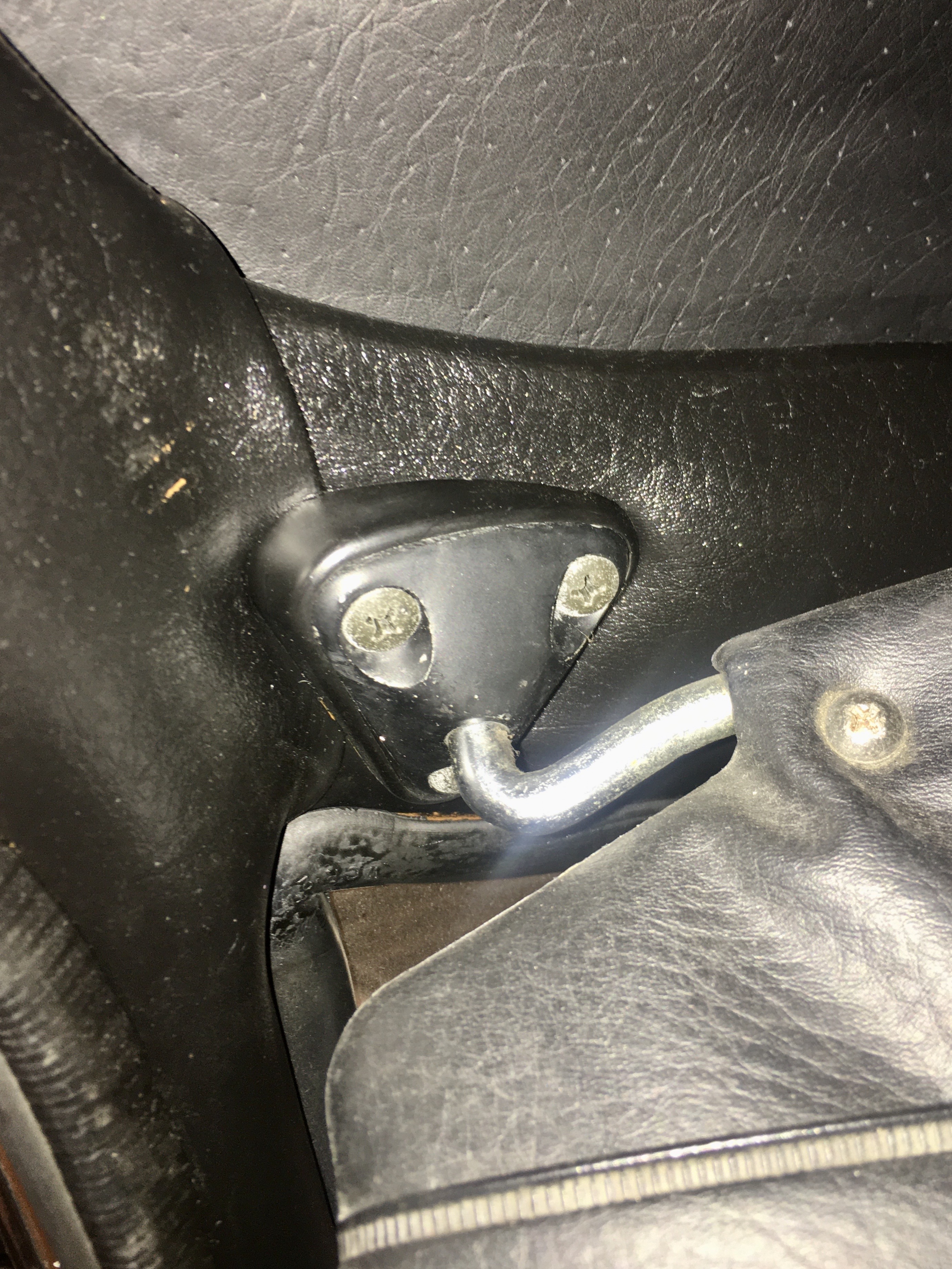

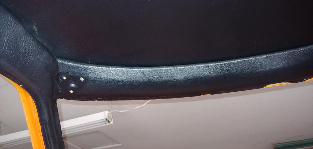

And here is a pic that might help with the corner joint.

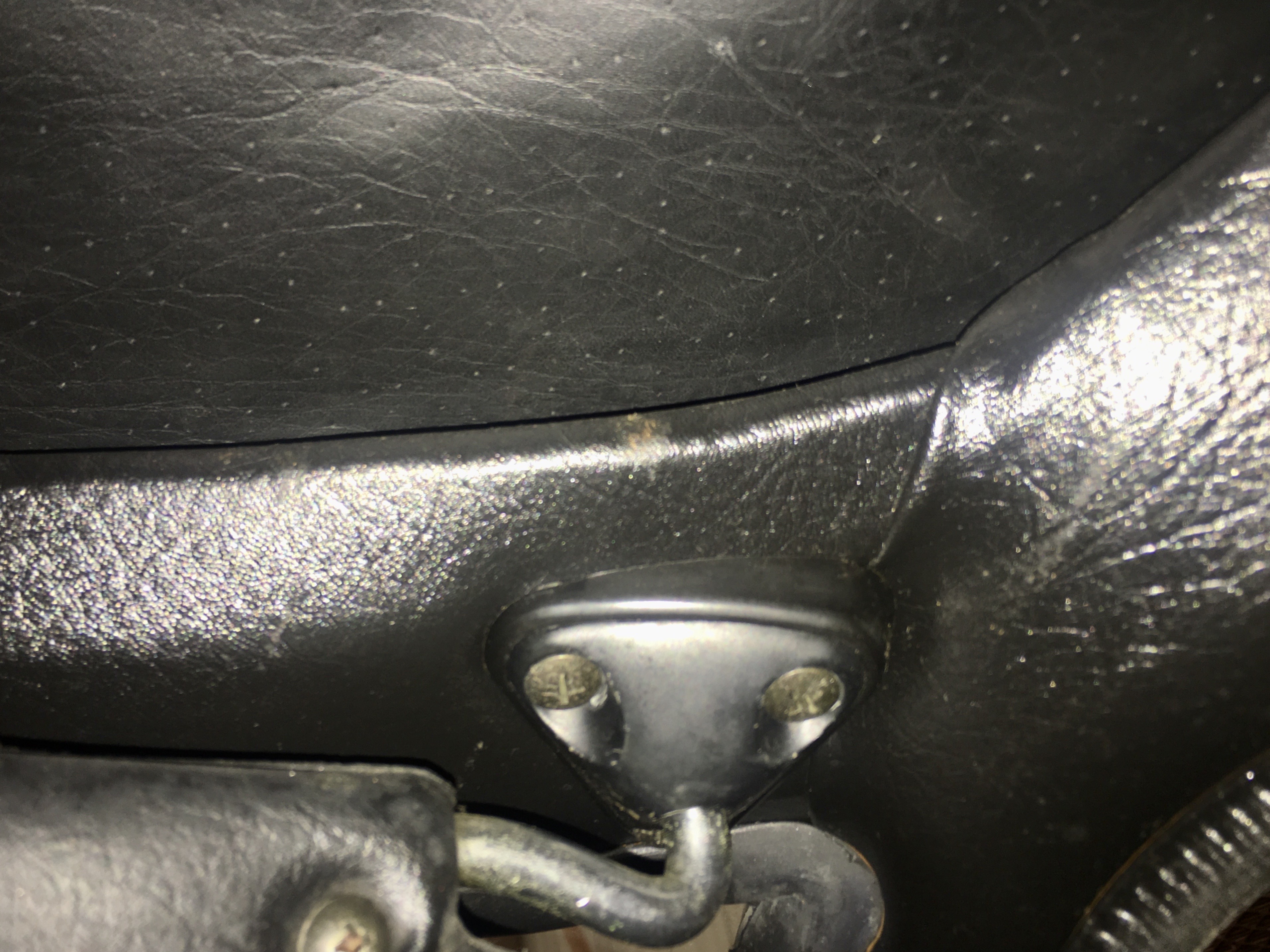

As promised, although a bit late, here are the corners on my 72. The center portion above the windshield was placed first, the right and left sides next. The windshield goes in last, the rubber gasket going over the vinyl, holding the edge down.IMG_0676.jpegIMG_0674.jpeg

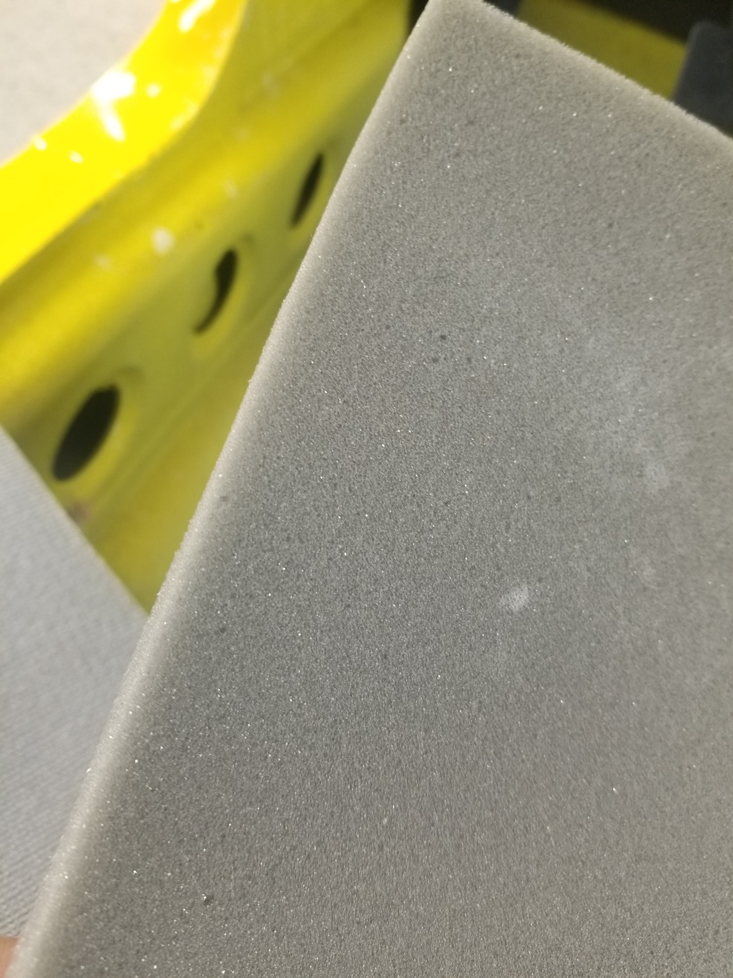

When we pull that vinyl the thin foam always stays glued to the metal... I think that's the easier route. I've done a few and I glue the foam to the metal and trim if I need to - then do the vinyl. The vinyl needs to start inside and be stretched out to the flanges. Glue it to the flanges. Inside up top it's held with the clips. Remember that the windshield weatherstrip is going to go over the vinyl and when it does it'll pull it tighter - so don't worry if it seems a bit "puffy" (can't think of a proper way to describe a new vinyl install without the gasket in yet...).  And the door weatherstrip will cover and pull the A pillar vinyl smooth and tight on the outboard side. The top of the A pillar can be a bit troublesome - getting the joint with the front to look correct and smooth. Remember also the visors will pull the vinyl a bit too when mounted so they may help smooth things out...

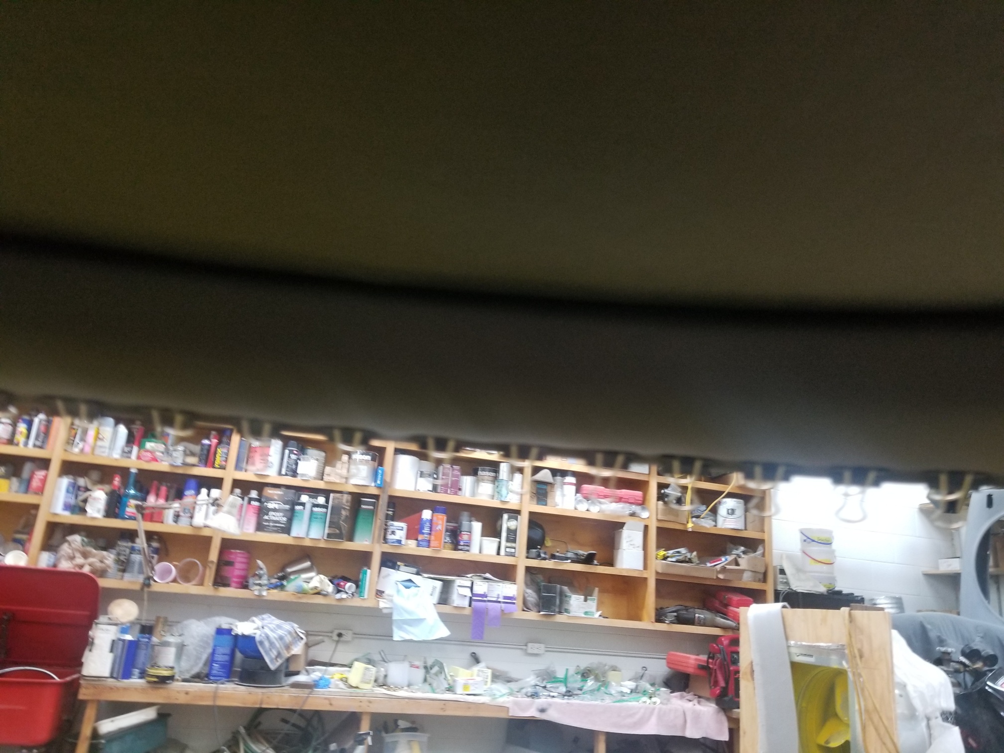

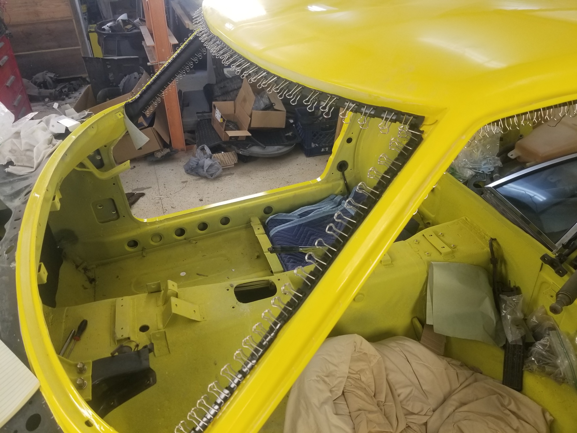

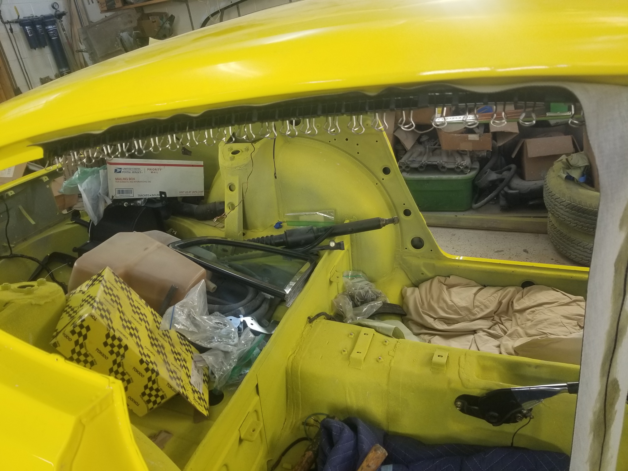

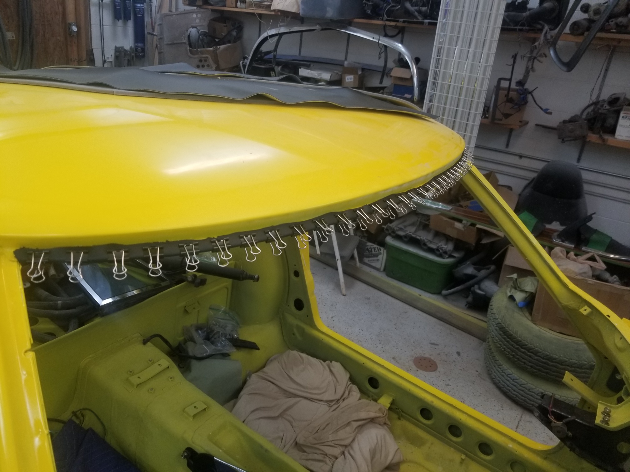

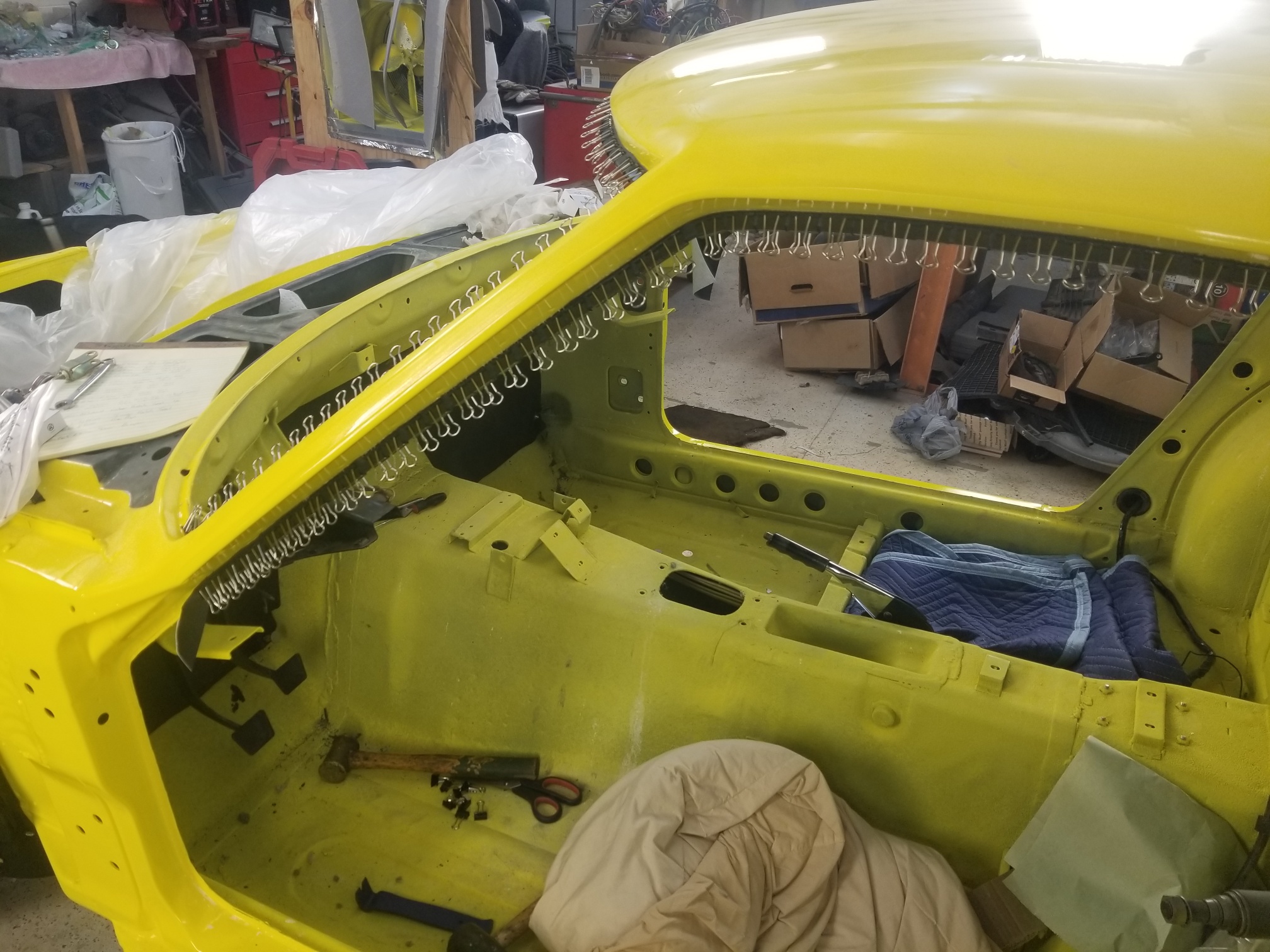

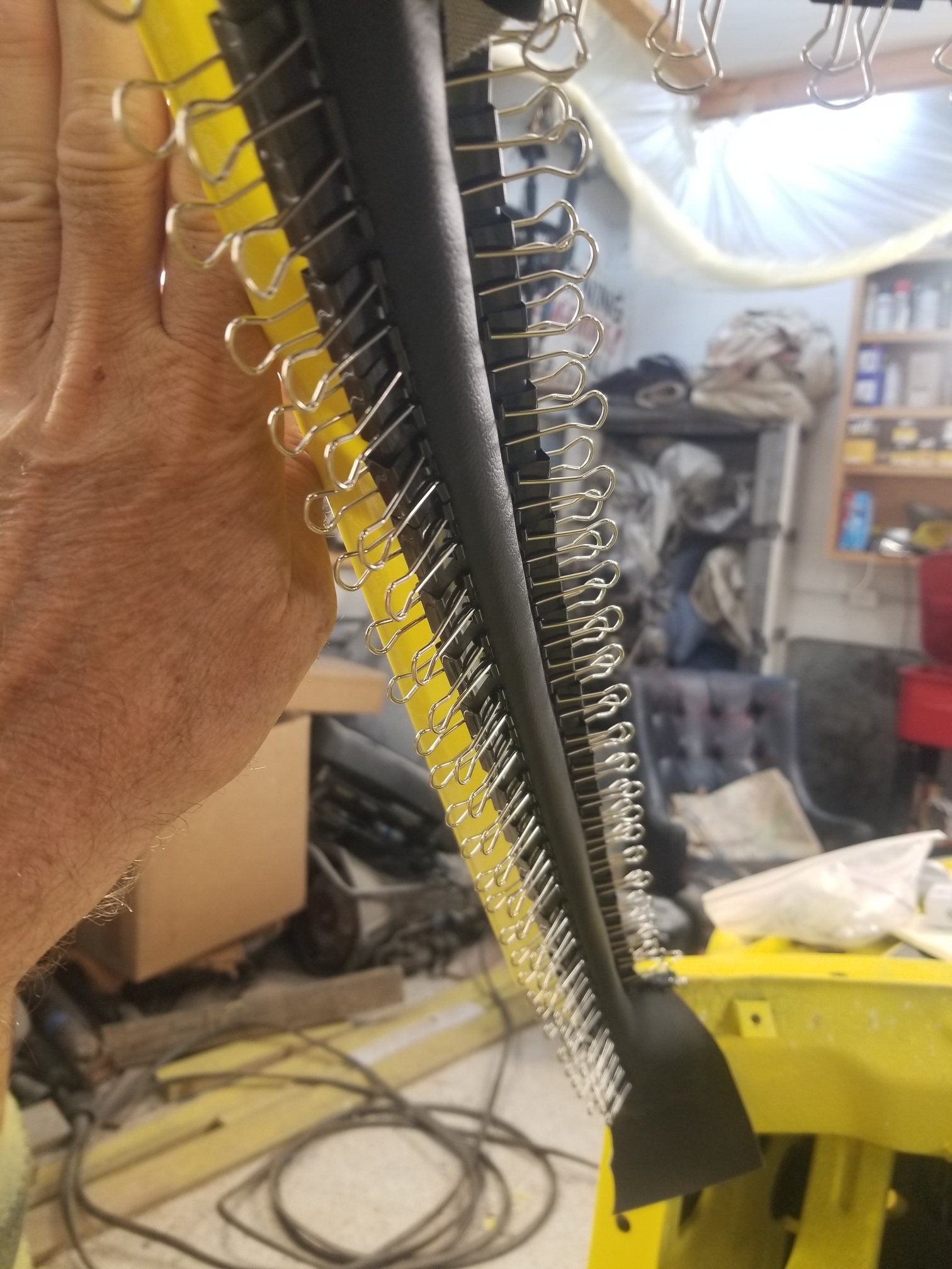

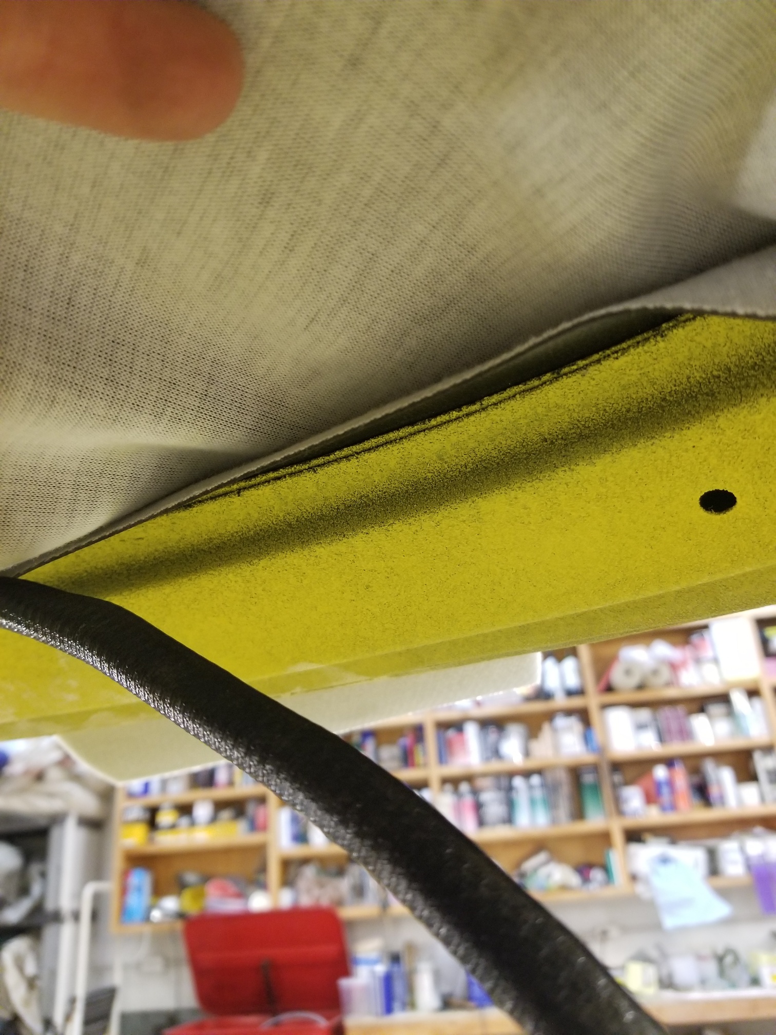

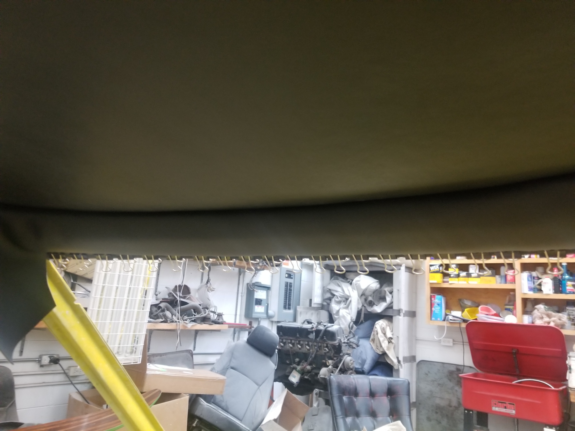

Started messing with this tonight.
It takes a second to get oriented on how the header piece needs to be to clip the wind lace over it.

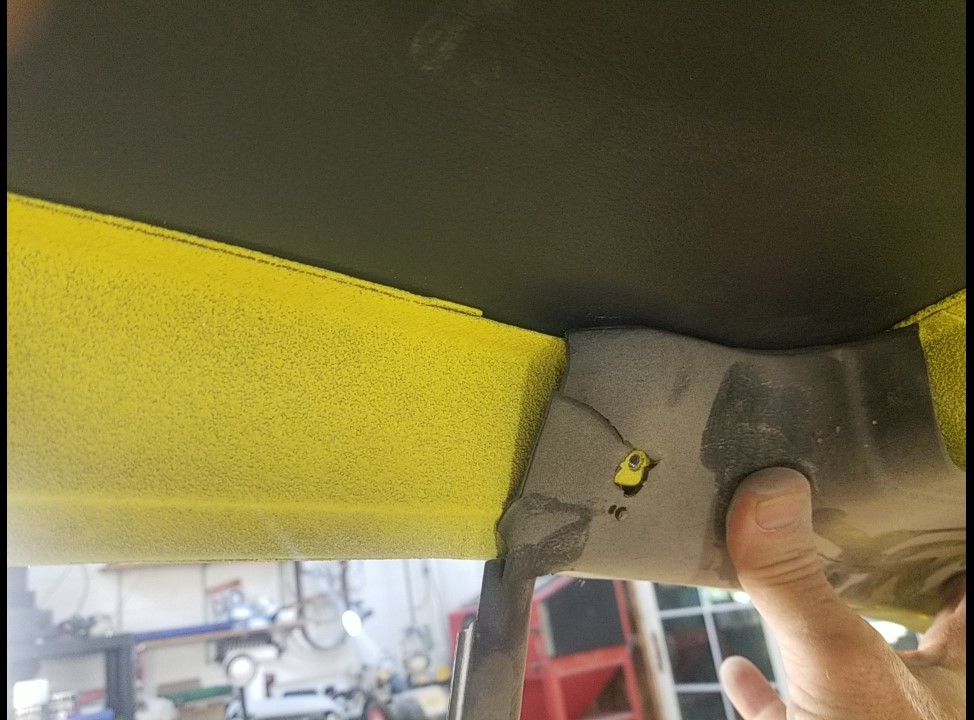

Once I get this clipped in and like it I will trim it back some. Then I'm gonna glue the foam to the metal. Then glue the header piece to the front flange...

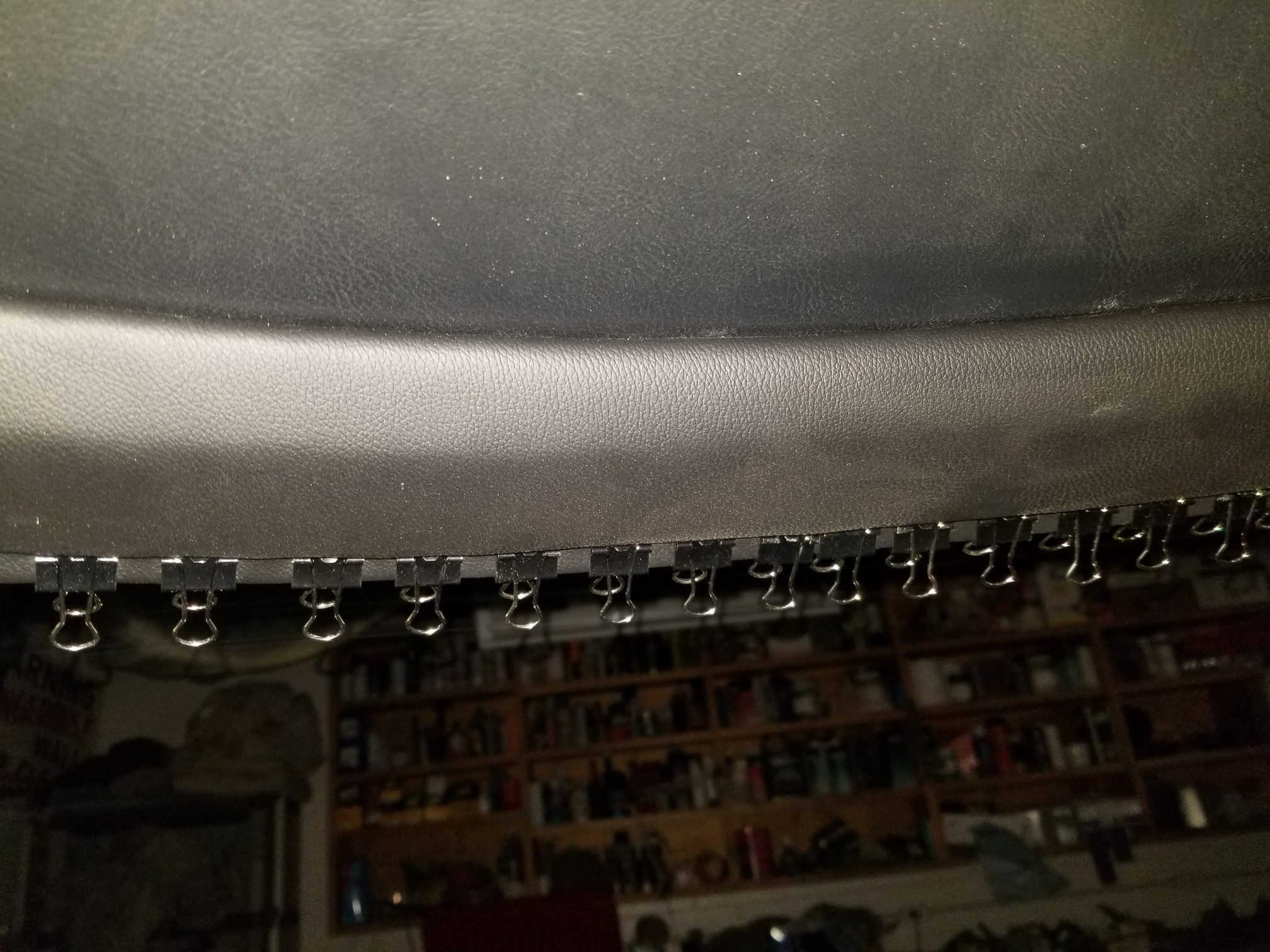

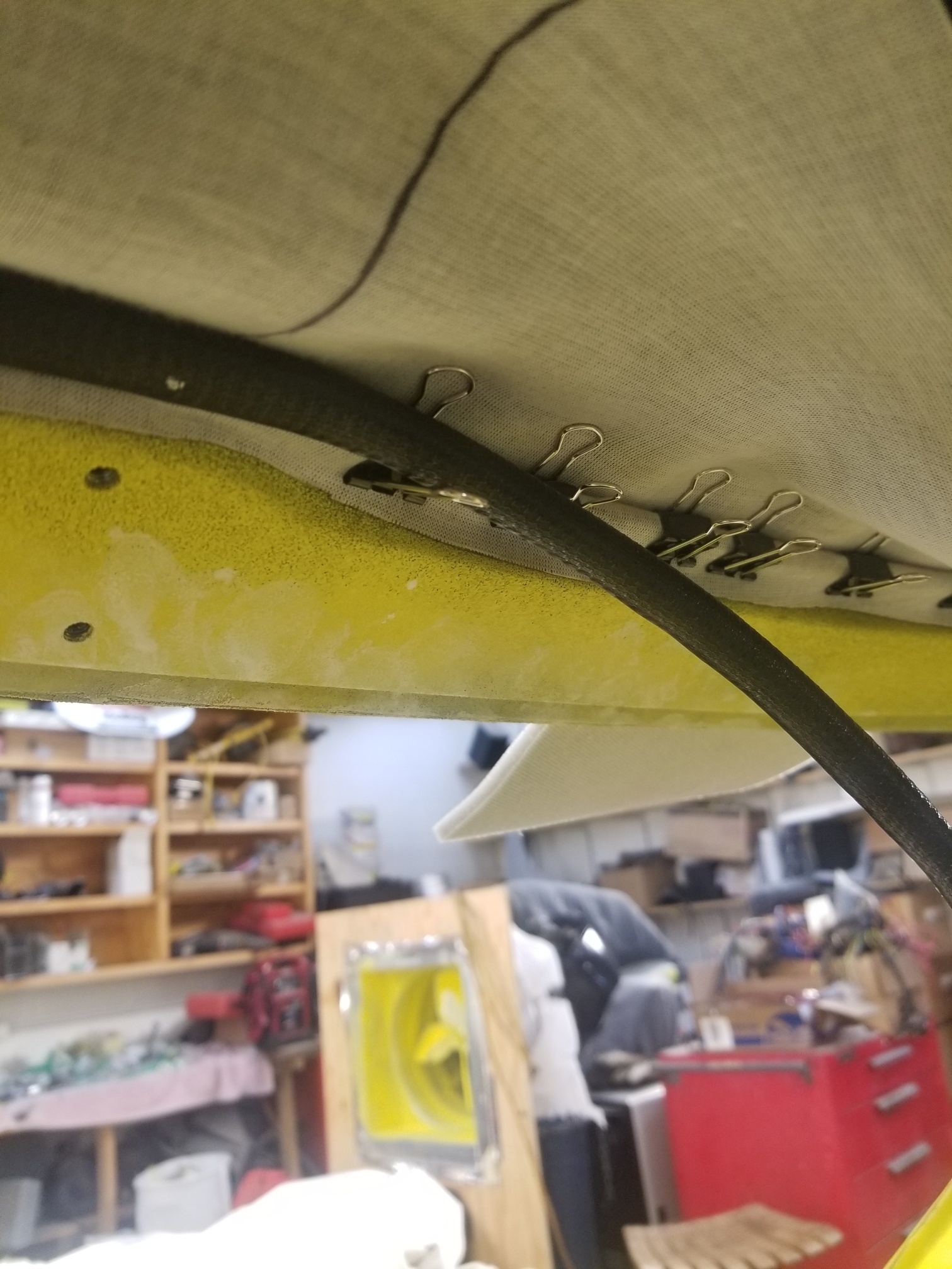

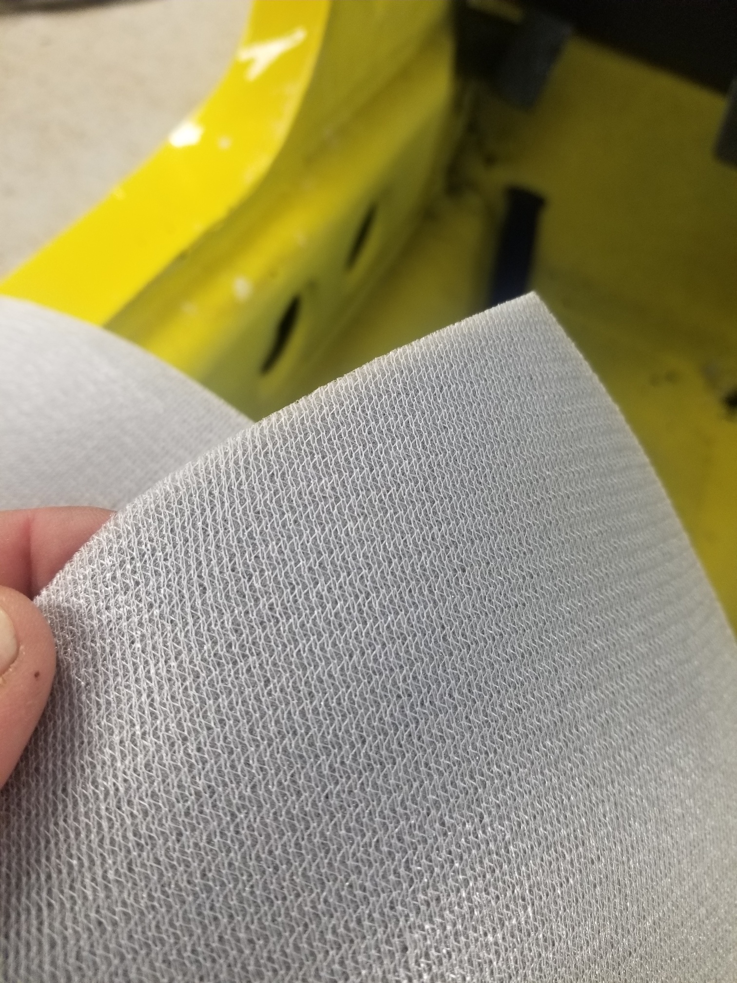

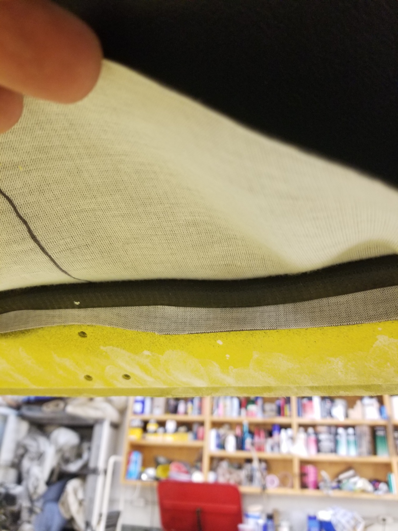

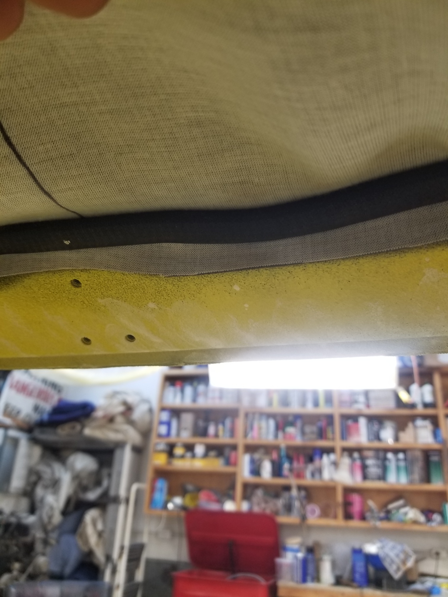

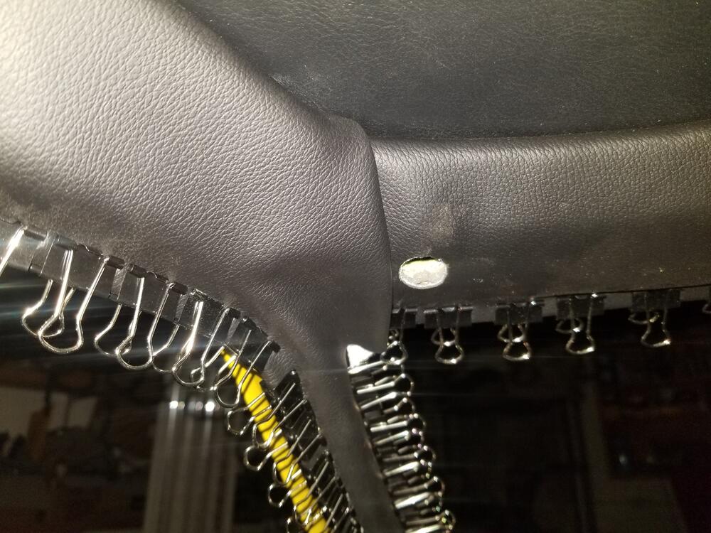

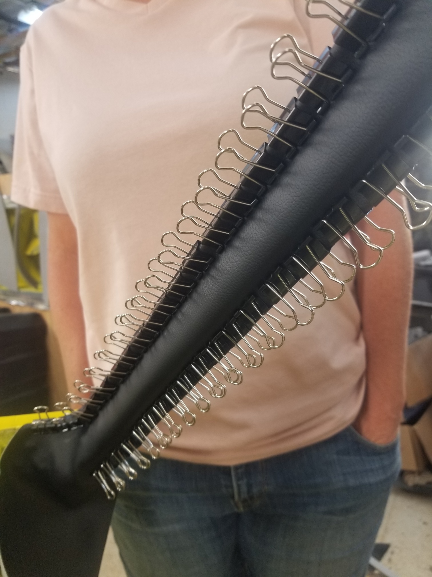

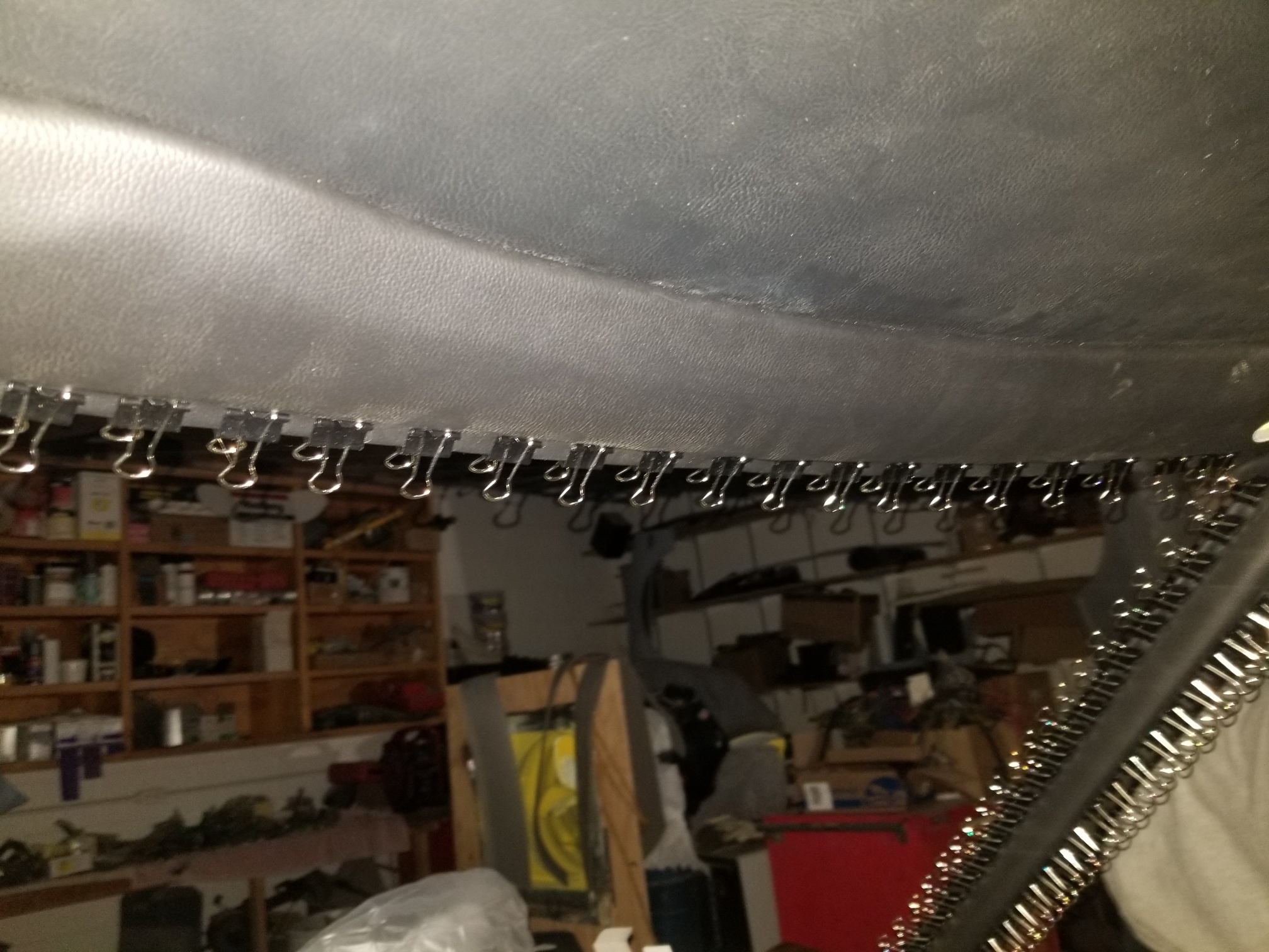

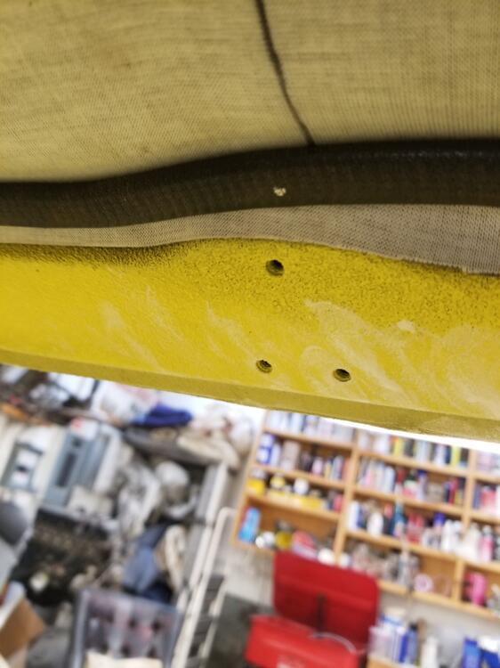

I tried to get some better pictures of the interior roof trim
I will work on this fold a little more. I glued the passenger side and it looks a little better. I'm sure I can make this detail right with a little more fiddling
