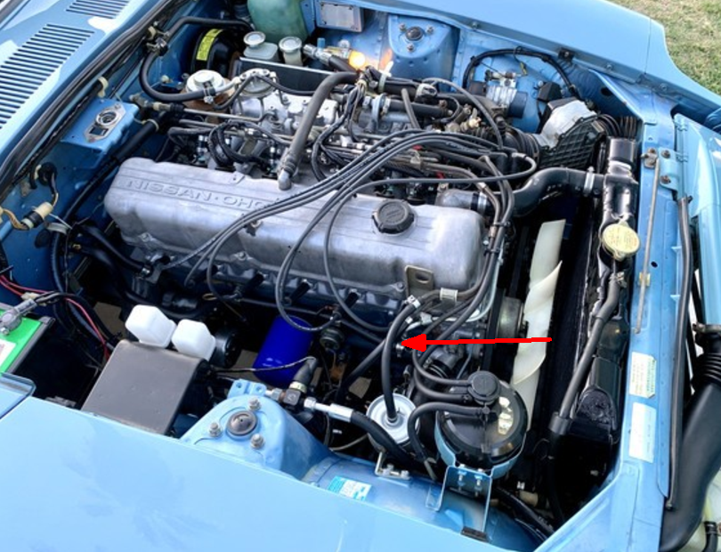

Do you have any pictures of the spot it should be in? Ive seen a few pictures and people differ on where it actually should be.

Here:
And don't use worm drive clamps. Use the proper clamps for fuel injection hose. The worm drive clamps aren't designed for the pressure you can see in that part of the fuel system.

Oh man thank you so much, I actually have one worm clamp on a injector. The box supposedly said was rated for 50psi, but it leaks occasionally. Ill change it out, any recommendations on clamps and gauge? Beautiful bay!
