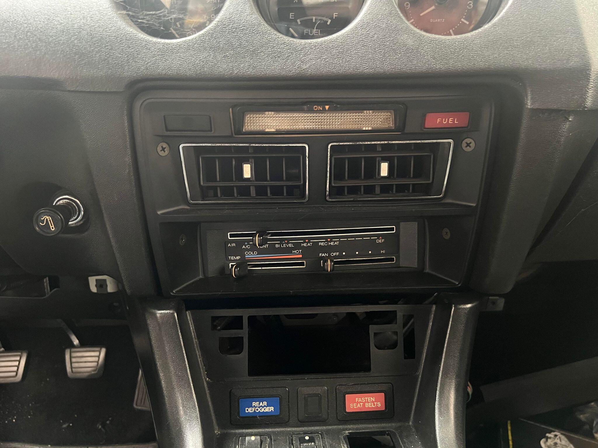

If you don't have factory AC, you're paying for many hoses that you don't need.
I responded to your threads on the blower motor and turn signals. I didn't see one on the parking lights. If you did create it, tag me in the thread so I can find it.
The car does have factory AC as far as I can tell.   I didn't make one with the parking lights yet, but I will do that now.
7 minutes ago, SteveJ said:
There's an easy way to tell if your car has factory AC. How many speeds are there on the fan switch?
I believe I would count that as four, but a picture would do it more justice than me.356554974_1444017469763100_6910280898173005140_n.jpg
