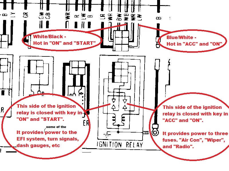

Here's a sketch I whipped up a while ago showing the functions of the ignition relay. Might help augment what SteveJ already posted.

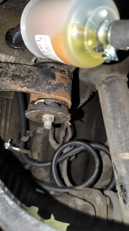

So I turn the key a few times to prime the pump to get the fuel line filled with gas, and I look under the car to verify no leaks, and it all looks good.  The only thing that concerned me is the Fram G3 filter isn't completely full, I'll include a photo of it below.  Is it supposed to only be somewhat full like that? Also, will not having the fuel damper right off the pump outlet have any effect on the car? Mine doesn't have it.

My Fram G-3 is full coming straight out of the tank, your's should have a lot more fuel in my opinion.
You can put a hose on the top side of the metal fuel filter under the hood close to passenger's side of the radiator support. Put the loose end in a gas can but secure it down. The high pressure will push it out of the jug. Unplug the small wire on the starter's solenoid and turn the key to ON. The pump should run without the car engine running. Let it fill up the jug or until the rear G-3 is full and all the air is pushed through the lines. It circulates from the tank to the fuel rail then the excess is sent back to the tank via the return line from the fuel pressure regulator to the tank.
I can't tell looking at the picture if the G-3 is horizontal  from the inlet to outlet but I would want some gravity help keep it full constantly. In other words the outflow to the pump should be on the bottom.

I only put two gallons of fuel into the tank, so that could have something to do with it, but I figure it should still pull fuel, I'm using the top bung, which I believe is the correct one for feed. It's nearly horizontal, not quite as vertical as the one in the guide, but close.

This is not to be insensitive by any means… Are you sure the G3 filter is oriented correctly with the arrow pointing to the pump. It’s easy to get confused when gas is running everywhere.
