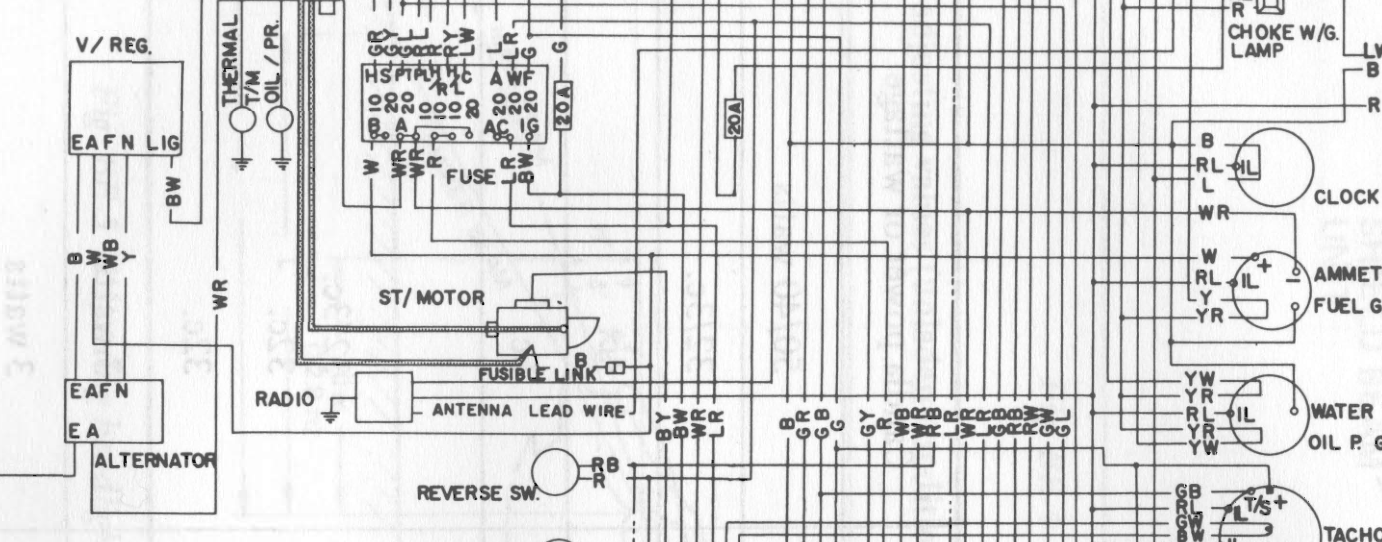

First, what is connected to the red wire that is going to the positive terminal on the starter? That load could be part of why your ammeter is behaving the way it is. When the ammeter needle is on the positive side of the gauge, that means current is flowing from the alternator to the battery. After recharging the battery after starting, the only loads that should make the needle move right are the brake lights and horn. Even then, those shouldn't cause much of a deflection in the needle. Other than that mystery load, the needle moving to the right could indicate a failing battery as your alternator keeps pushing current into the battery. It could also indicate an alternator overvoltage condition.
If the battery health isn't good, that could cause issues with starting. The issues with the car stalling could be related to improper re-wiring, bad battery, or something else.
With the car running at around 2000RPM, what is the voltage at the battery?
Thanks ya'll. So, if memory serves, last fall the car was behaving like it was starved for voltage when starting, and the battery was pretty old, and I did the old "while I'm in there" with the alternator and starter, cause I wanted the car to be reliable and have two less things to fail. Possibly dumb in hindsight, but if you think that's dumb, boy have I got stories for ya. I recall struggling with the new alternator at one point, and going around about internal regulation, as well as the in-line fuse piece for the starter. I will take a battery reading with the car at 2k RPM, and how it behaves relative to throttle, and report back. Thanks.
Was the starter and and alternator failing at that point? The reason I ask is what’s available today is not Mitsubishi. Mostly Chinese junk. Many threads here relating to multiple defective parts right out of the box. Most folks now have it tested before they leave the store for that reason. Please let us know what you bought and where. The starter from the pic doesn’t look like it was a rebuilt original. @stevej has posts out there on how to take voltage measurements on the charging system. It’s pretty in-depth and worth the effort.
Is the smaller black wire to solenoid where the spade connector clicks on the copper blade looking terminal in good solid shape. I honestly don't know if that could hurt the solenoid but I can't see the connection so I do not know. 😁
The red wire to the starter: I have no idea, as it was implemented by a previous owner to me, or original to the car. I do recall that much.
Got to the car today. At rest, battery shows 12.8V. I only ran it briefly as it was in the shop, but at idle, this jumped to 13.0V, and around 13.1 or 13.2 at ~2k RPM. The first time I tried to start it, the starter failed. It momentarily spun, and then just stopped. 2nd time I tried to crank it, the starter spun and it started.
13.2 V @ 2000 RPM is not good. As suggested earlier, contemplate replacing your voltage regulator.
The red wire is not original to the car. You might want to see where that wire goes to. Someone may have "fixed" something only to cause other problems.
