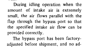

The "proper" way to adjust the fuel-air mixture at idle is with the screw on the side of the AFM, not the spring inside.  It's described in the FSM.
Edit - actually, it's described that the bypass screw is not to be adjusted.  But it is the most direct way to lean out or richen the idle mixture.
